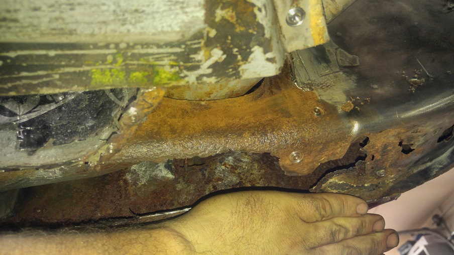

Travis Neff   Well onto the not so fun stuff. Rust Repair. Seve...   Jun 5 2018, 12:01 AM

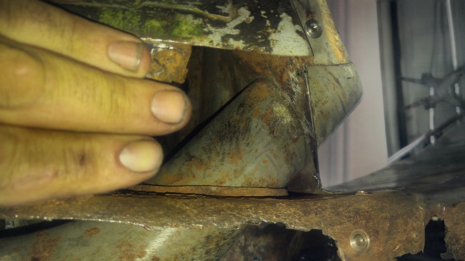

Travis Neff   With that last photo of the replaced jack point an...   Jun 5 2018, 04:18 PM
Travis Neff   The long was stuffed with what looks to be Cotton....   Jun 5 2018, 04:26 PM
Travis Neff   And a little view of the jack point repair. They ...   Jun 5 2018, 04:29 PM

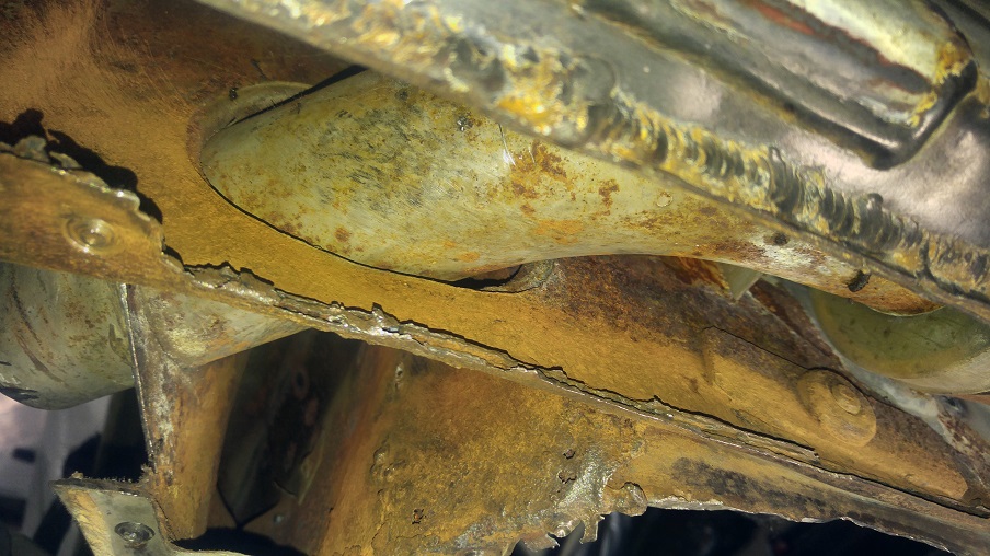

Travis Neff   A bunch more cotton and mouse trash fell out of th...   Jun 18 2018, 04:26 PM

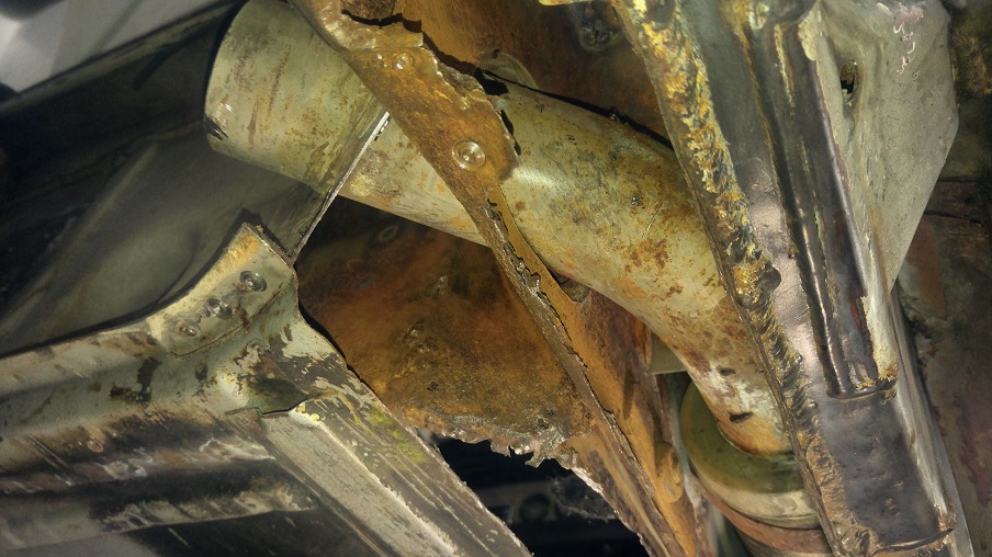

Travis Neff   Patched a small part of long and put a backer in p...   Jun 21 2018, 11:18 PM
Travis Neff   Forgot a pic of the good looking side   Jun 21 2018, 11:27 PM
Travis Neff   I put in the backing panel against the inside long...   Jun 23 2018, 09:57 PM
