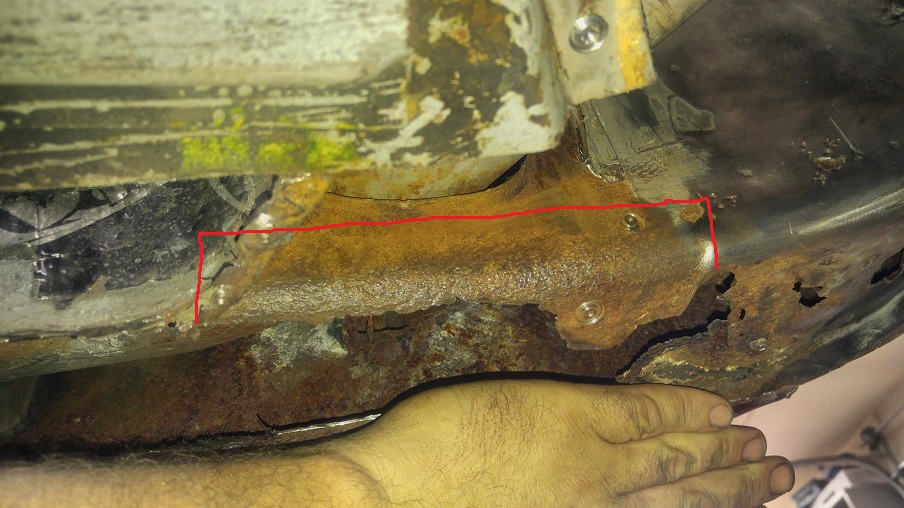

I think I will cut these 2 parts next. I will need to figure out how to bend the replacement long pieces to make that smooth, rounded corner. Anyone have any insight on this? I have a cheap-o 30 inch HF brake. I guess finding some conduit or something to help make the shape.

bbrock   I have the same cheapo HF bending brake and bendin...   Jun 18 2018, 05:00 PM
Travis Neff   I have the same cheapo HF bending brake and bendi...   Jun 18 2018, 06:27 PM
