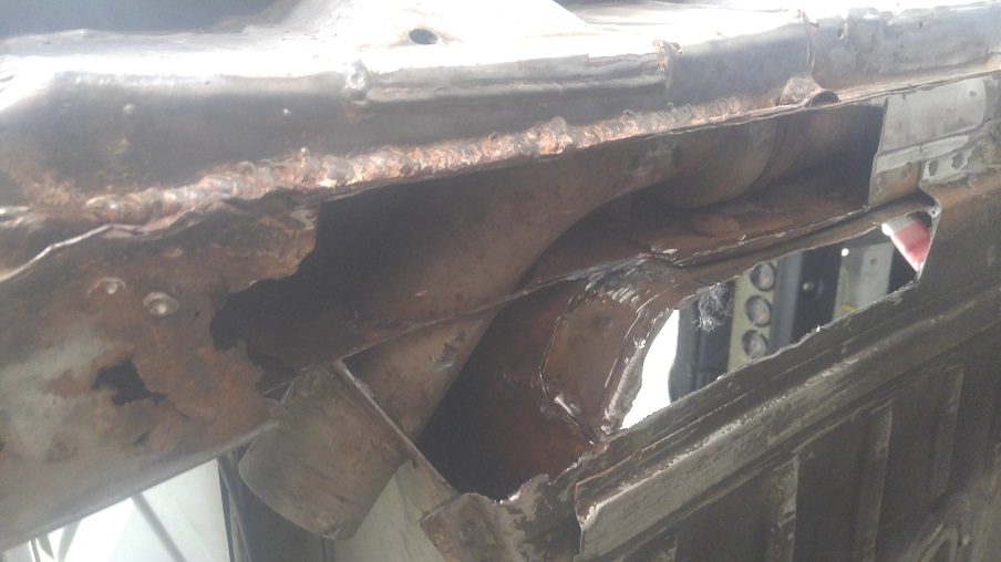

Travis Neff   A bunch more cotton and mouse trash fell out of th...   Jun 18 2018, 04:26 PM
