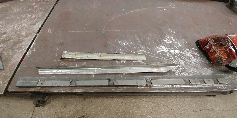

Found it! Thanks for the tip and thanks to Ben to show us how it's done.
I only need to worry about the first 2 recesses (left) (IMG:style_emoticons/default/smilie_pokal.gif)

QUOTE(Travis Neff @ Jun 18 2018, 06:43 PM) *
I still have the "buck" to do it.. I may even have some samples.. What part do you need?
