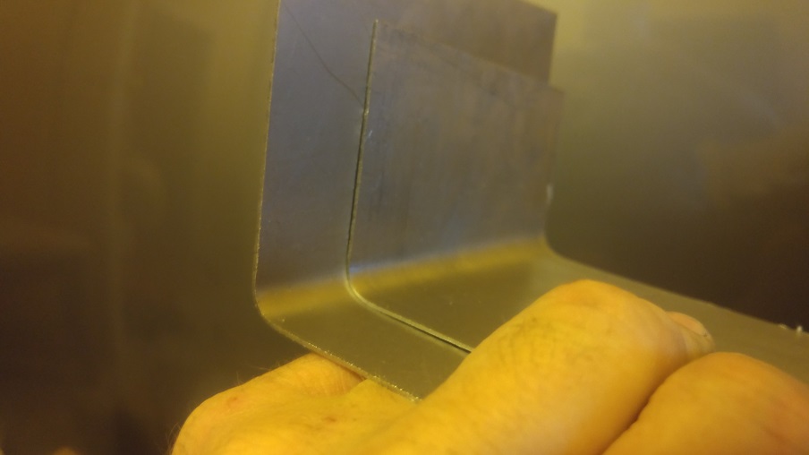

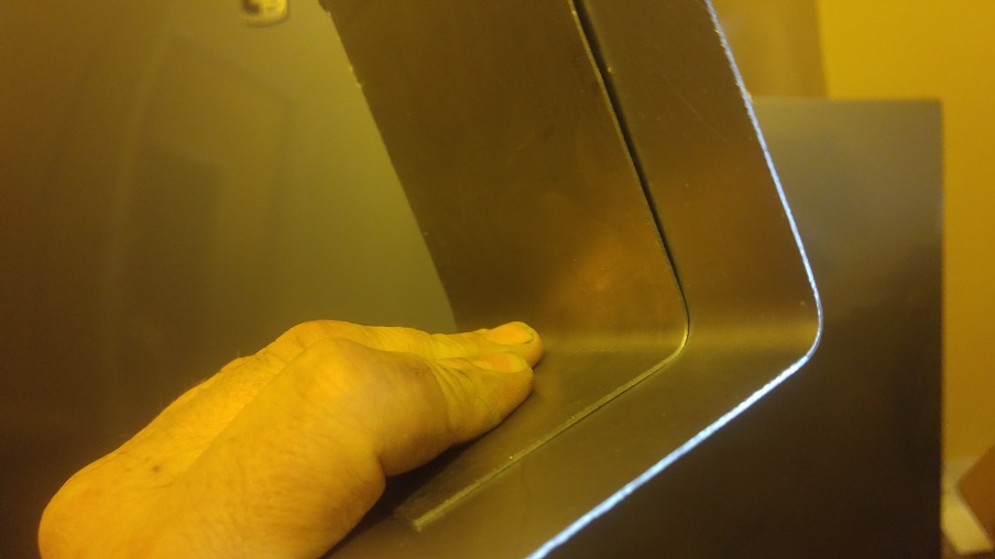

Brent, thanks for the tip on the round bar. 1/2 and 3/8 round bar works out great.
I welded the bars onto some 1/4x1.5 flat stock for my cheap-0 HF brake. Then tested it out on some 20g.

QUOTE(Travis Neff @ Jun 19 2018, 09:47 PM) *
