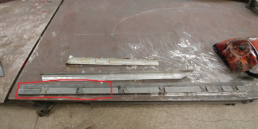

That would save me some serious time!
I would need from here to here with the flange that meets the outside cover on the bottom, and the radius curve on the inside that goes up about 1.5 inches in height.

QUOTE(Travis Neff @ Jun 19 2018, 08:08 AM) *
I will look what I have.. I was also thinking I could just send you the buck and you could pass it on to the next person that needs it?
