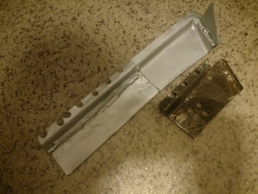

Patched a small part of long and put a backer in place over the original backer. I will have to jigsaw puzzle that part back together. Will have some pics tomorrow. Welding upside sucks, I think I need to seriously bump up the wire speed, as soon as a good puddle started it wanted to drop out onto my chest LOL.
I cleaned up the floor section that I removed and the the back part of it was super pitted and bent like tin foil. I fabbed a patch up, which was a bit of a chore to make that corner. But it seemed to work out. Blow a bunch of holes trying to section in the flange with the firewall section.
