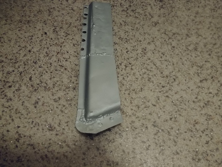

Travis Neff   Patched a small part of long and put a backer in p...   Jun 21 2018, 11:18 PM
Travis Neff   Forgot a pic of the good looking side   Jun 21 2018, 11:27 PM
Travis Neff   I put in the backing panel against the inside long...   Jun 23 2018, 09:57 PM

Travis Neff   Patch is in. Had to grind down some the welds to ...   Jun 24 2018, 02:31 PM
