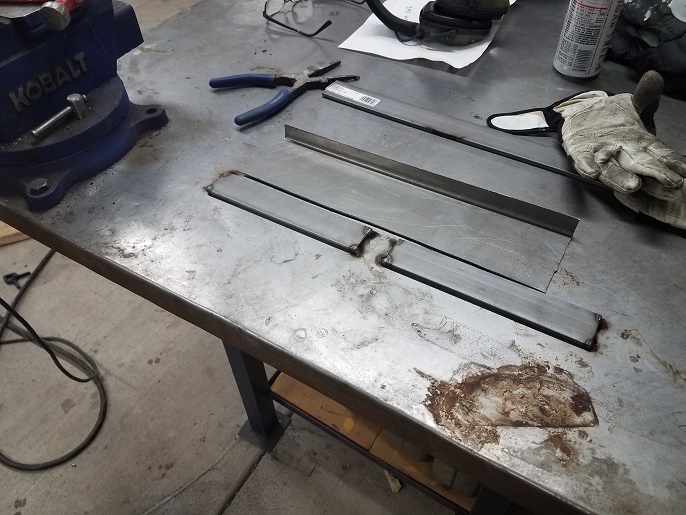

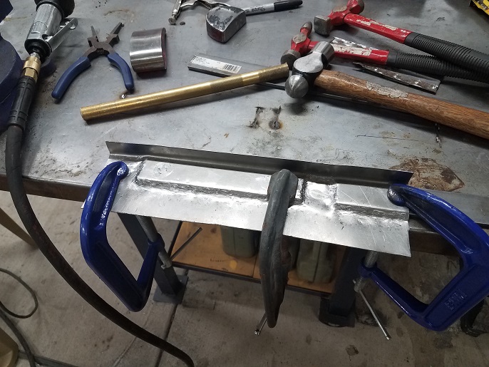

I put in the backing panel against the inside long wall. I had to leave a gap so I could get the welding gun in there to weld to the side of the long. Then added in a filler piece with a flange so I could plug weld and run a stitch at the seam. Its a little ugly, but it will be covered up.
Went on to make the bottom of the long to cover the same area. Made 2 recess to replicate the original long. I made them about a 1/4 to wide, and thought hard about making another panel. Then I said screw it, it will all be covered by seam sealer anyways. It's in, I'll share pics tomorrow for that.

QUOTE(Travis Neff @ Jun 23 2018, 07:57 PM) *
Sorry I didn't get back to you on that.. Looks like you figured it out..

QUOTE(mb911 @ Jun 24 2018, 04:00 AM) *
No problemo. It helped that your picture had the length written on them! Only took about 10 minutes from start to end.
