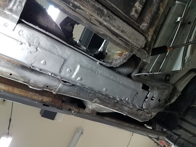

Patch is in. Had to grind down some the welds to get the floor pan piece to fit flush.

Travis Neff   Patched a small part of long and put a backer in p...   Jun 21 2018, 11:18 PM
Travis Neff   Forgot a pic of the good looking side   Jun 21 2018, 11:27 PM
Travis Neff   I put in the backing panel against the inside long...   Jun 23 2018, 09:57 PM
mb911   I put in the backing panel against the inside lon...   Jun 24 2018, 05:00 AM
Travis Neff   I put in the backing panel against the inside lo...   Jun 24 2018, 10:08 AM
Travis Neff   Patch is in. Had to grind down some the welds to ...   Jun 24 2018, 02:31 PM
