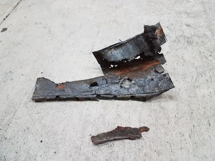

Travis Neff   A bunch more cotton and mouse trash fell out of th...   Jun 18 2018, 04:26 PM

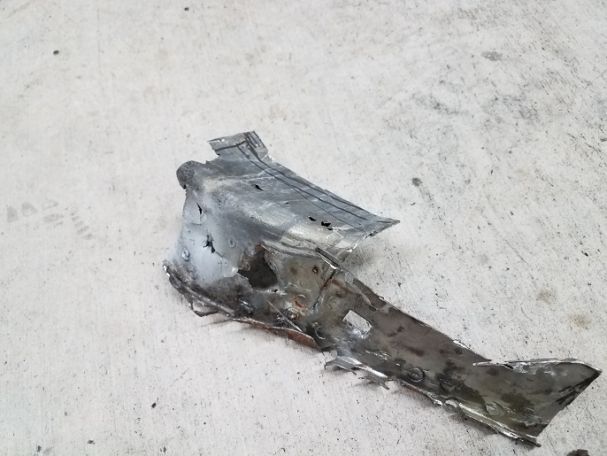

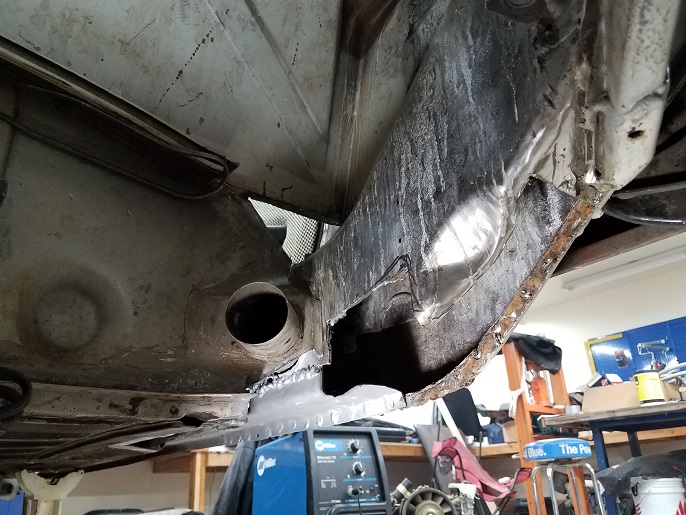

Travis Neff   Moving on.. This cut exercised my pelvic floor pr...   Jun 24 2018, 04:15 PM
Travis Neff   Looked a little further and the bump for the -4 mo...   Jun 24 2018, 07:34 PM
bbrock   Looked a little further and the bump for the -4 m...   Jun 24 2018, 08:40 PM
Travis Neff   I am officially sick of rust repair, LOL. I mad...   Jul 3 2018, 05:33 PM
