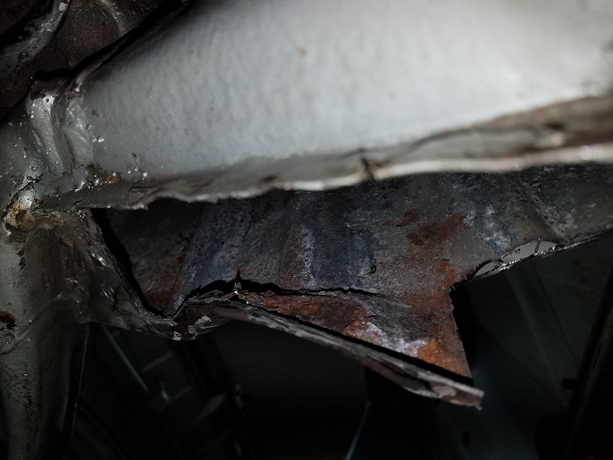

Looked a little further and the bump for the -4 mount indentation had to come out. You can see the backing piece is totally gone.

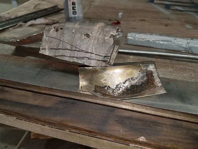

After cutting this out I was able to get the backer off and I think I can save this piece.

Travis Neff   Looked a little further and the bump for the -4 mo...   Jun 24 2018, 07:34 PM
bbrock   Looked a little further and the bump for the -4 m...   Jun 24 2018, 08:40 PM
