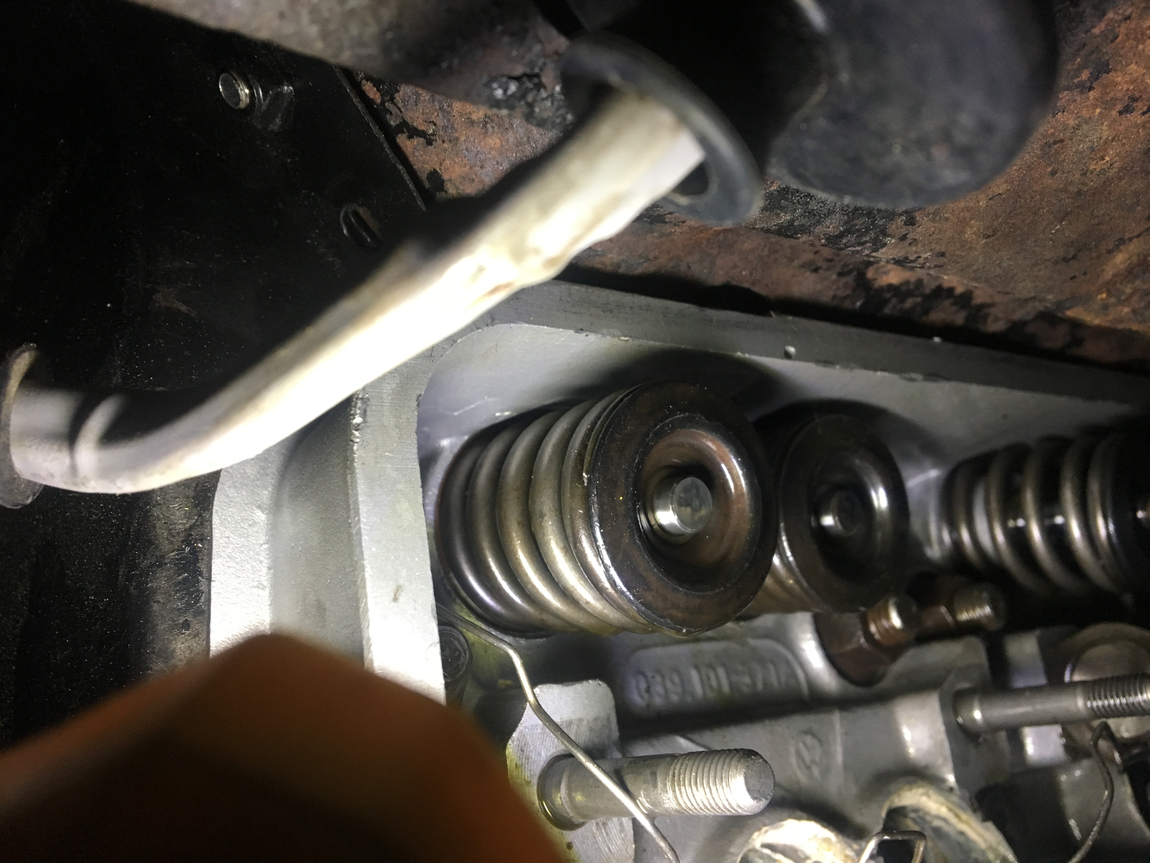

Stuck intake valve

Mark Henry   Stuck intake valve I often see this when a seat...   Jul 1 2018, 08:35 AM
Mark Henry   Stuck intake valve I often see this when a sea...   Jul 1 2018, 09:30 AM
Bartlett 914   Once the valve is bent, it is going to stick. Mayb...   Jul 1 2018, 08:20 AM
Mark Henry   Possible causes: Guides not sized/reamed/honed c...   Jul 1 2018, 08:31 AM

thomasotten   Photo of the stuck valve. When this happened to ...   Jul 1 2018, 11:21 AM

Mark Henry   I'd check the clearance of the guides, most sh...   Jul 1 2018, 02:33 PM

thomasotten   So, after sitting on the workbench for a few hours...   Jul 1 2018, 05:01 PM
rgalla9146   Most likely issue is the guides are too tight.   Jul 1 2018, 05:05 PM
thomasotten   Brass shaving found mid stem   Jul 1 2018, 05:11 PM
thomasotten   It is hard to make a good photo of this, but looki...   Jul 1 2018, 05:18 PM
Elliot Cannon   Next time, send them here. :D http://www.europe...   Jul 1 2018, 05:21 PM
bulitt   They used the wrong size reamer ? Roll that valve ...   Jul 1 2018, 06:14 PM
Mark Henry   Hard to see, but definitely tight and a poor job. ...   Jul 1 2018, 07:41 PM
reharvey   I had this exact same problem once and it was the ...   Jul 2 2018, 06:13 AM
