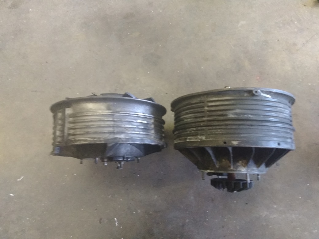

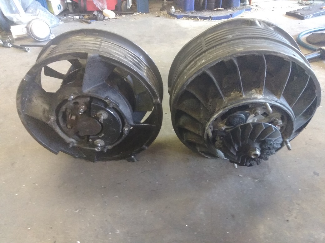

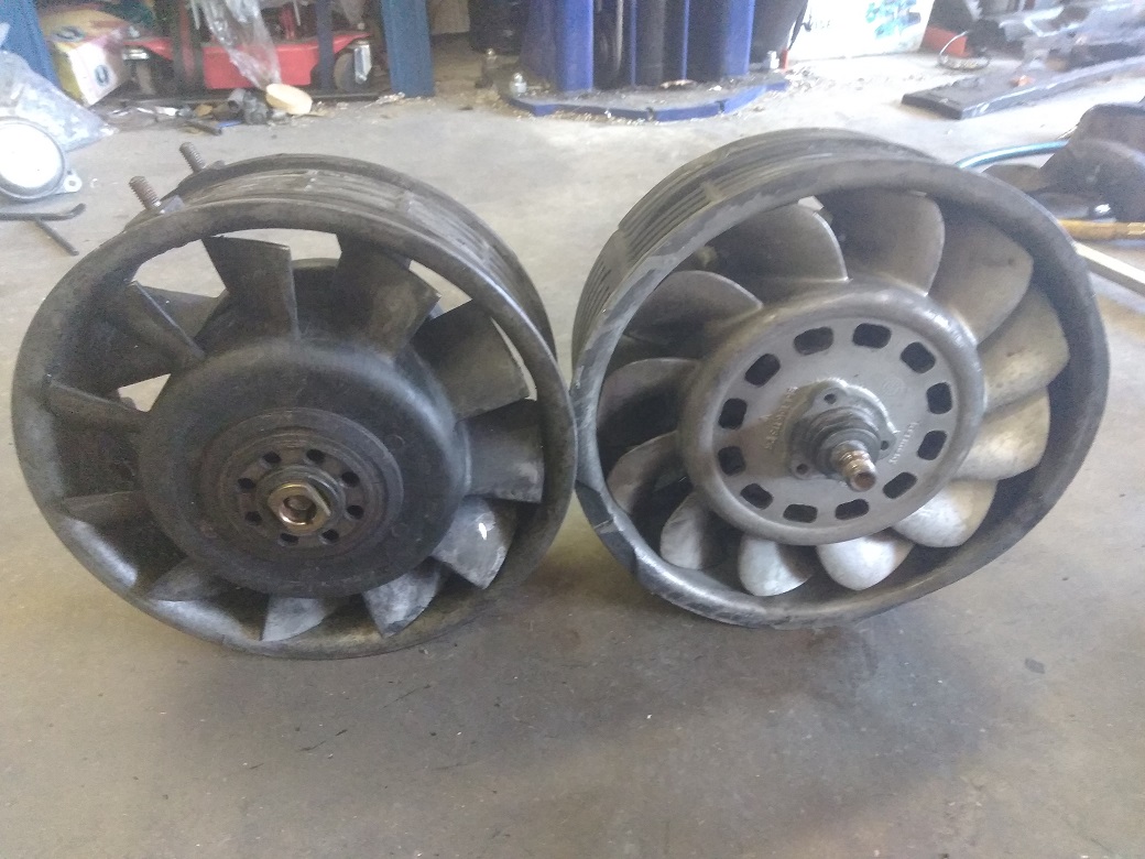

Just for education purposes...
Here are some pictures of a factory 914-6 alternator and fan compared with a 964 alternator and fan.
As you can see, the factory 914-6 alternator/fan assembly is smaller in diameter. The last picture really shows off the size difference. The little fan on the back of the 964 alternator is there just to keep it cool.
I actually tried to fit the 964 alternator in the 914-6 fan opening. Its too big.
Your aftermarket alternator looks like a great solution for early cars with electric AC compressors. I suggest you get the serpentine belt kit from Clewett engineering if you use that alternator. Besides the ability to handle more load, it makes the belt easier to change too.

QUOTE(ClayPerrine @ Jul 1 2018, 11:48 AM) *
Yes I think it would be a great option for electric A/C. The 964 can fit, but it has to be milled down to do it. A thread on Pelican shows the results.
And yes Serpentine belt would be the correct choice
