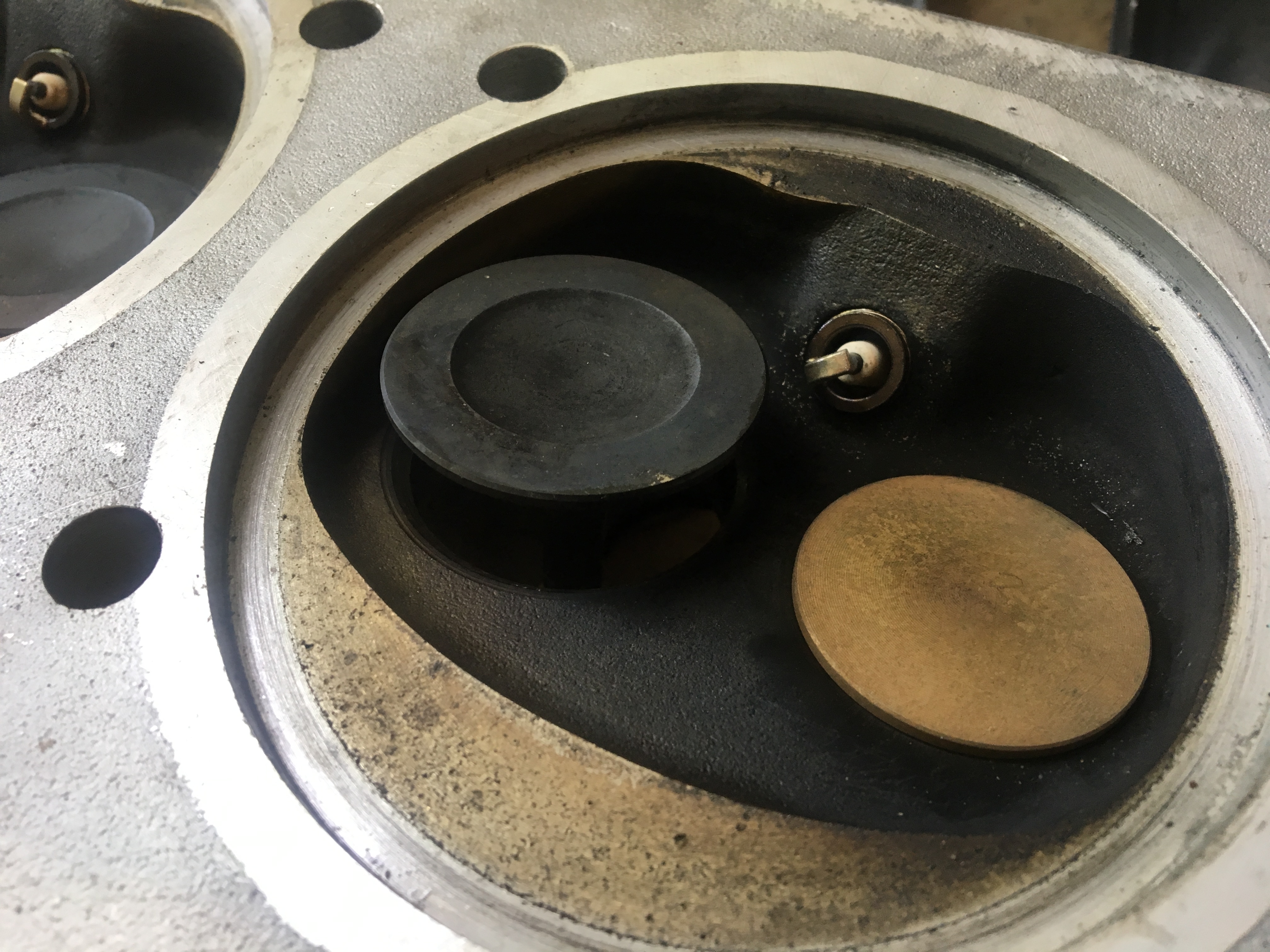

Photo of the stuck valve. When this happened to
the other head, I removed the spring,
and gave the valve a little tap and it came right
out. I then put it back in the guide and it was smooth.
There was some evidence of fine brass flakes, but on a
different valve spring.
Someone suggested possibly lifter catching. I checked them all,
and if you press down on the lifter when pulling you can feel
a small catch, but I think this is because the lifter is crossing a chasm in it’s travel in the case. I will probably replace them all. Cam off by one tooth? I usually triple check, but at this point anything is possible . I don’t know maybe I should just tear the whole case apart.
Looking over the sales receipt from Rimco, they reamed the guides on both heads originally. When I sent the other head back, they replaced the guides rather than reeming. So perhaps there is something with their reaming process ?
