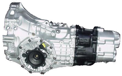

What you need for these is an 6 speed out of a Audi or VW TDI kinda like these. Problem is solved, it will bolt up to an ALH and has the proper gearing and handles more that 375 FtP. Are not cheap, are rare in the USA, but Europe has them. Same basic trans as the Boxster S 6 speed but with better gearing.
Get this thing done man, once it is driving you can make fools out of all us speculators. (IMG:style_emoticons/default/beer.gif)
These can be found here for a price that makes me (IMG:style_emoticons/default/screwy.gif)
