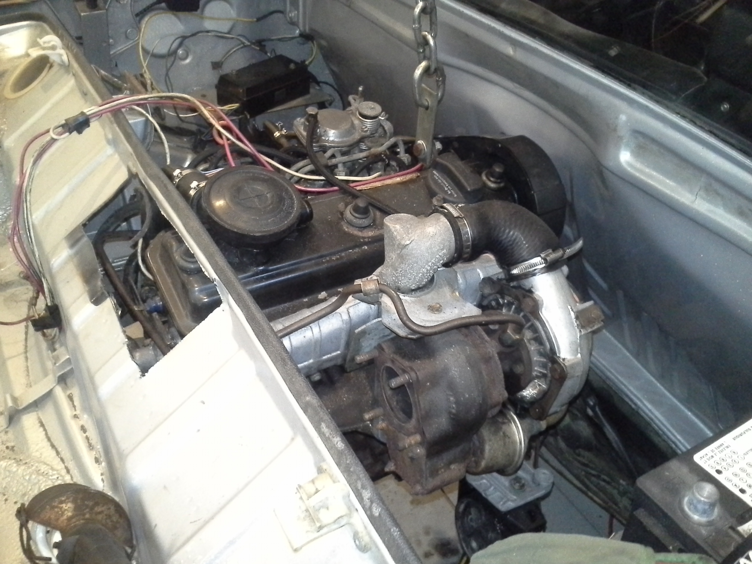

Been planning this for a while, but it was supposed to be a winter project. Wasn't quite ready yet. KEP adaptor parts have been sitting here. Timeline moved up because of a failure.
Had a chirp that turned into a BAD miss, valve seat issue on one cylinder.Attached Image

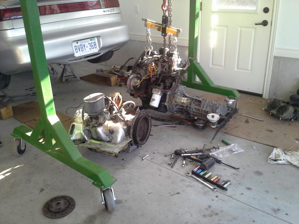

Had a fresh 1.9 AAZ diesel sitting in my storage trailer that had never been fired. (honed, rings, bearings, injection pump reseal). "new" engine was destined for my daily beater . Same engine in the beater is getting a little tired, I've put at least 350,000 km on it and the compression is getting down. Still runs okay though. Swapped the "new" engine into the beater. 16 year old son is learning...Attached Image

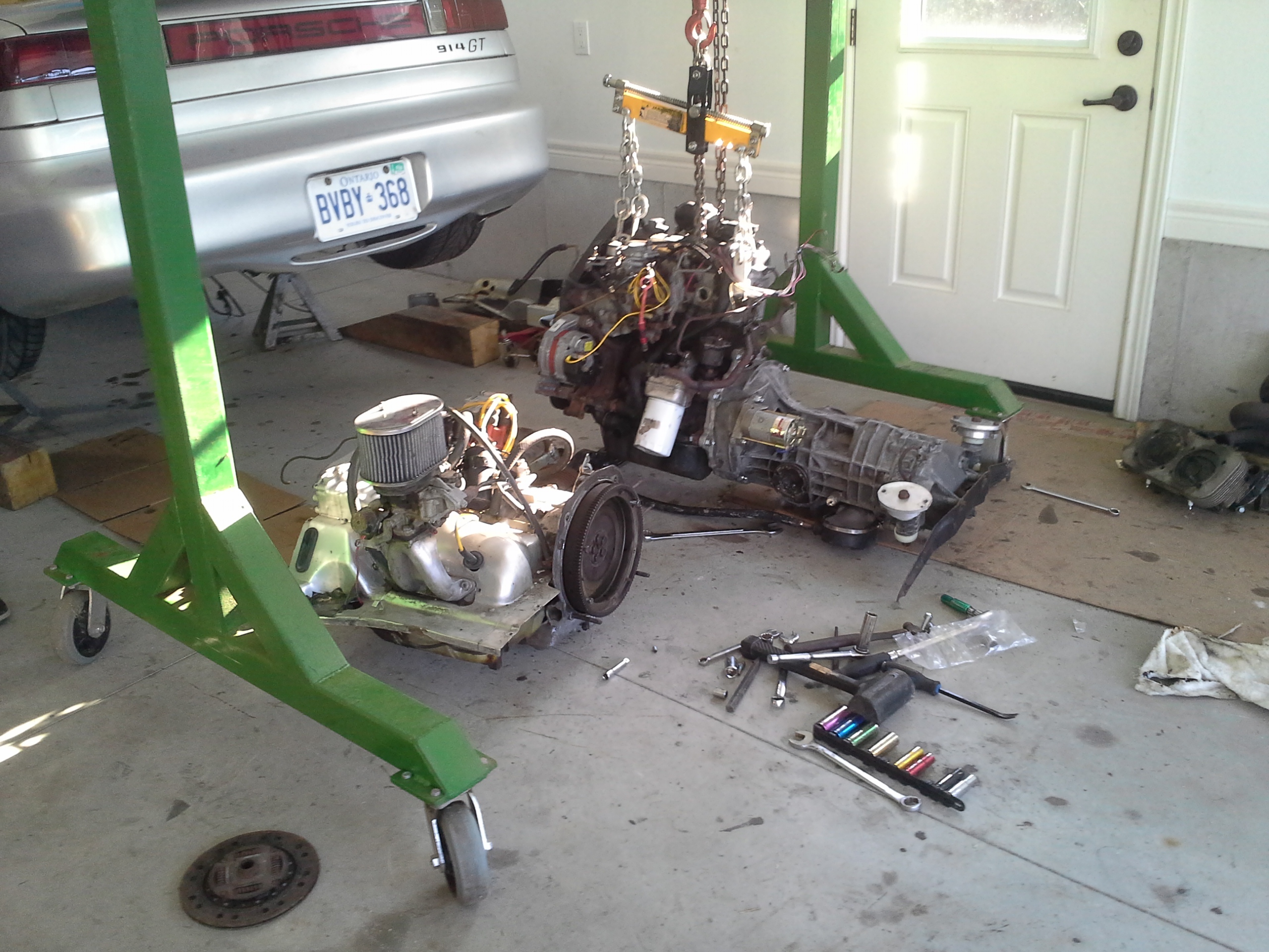

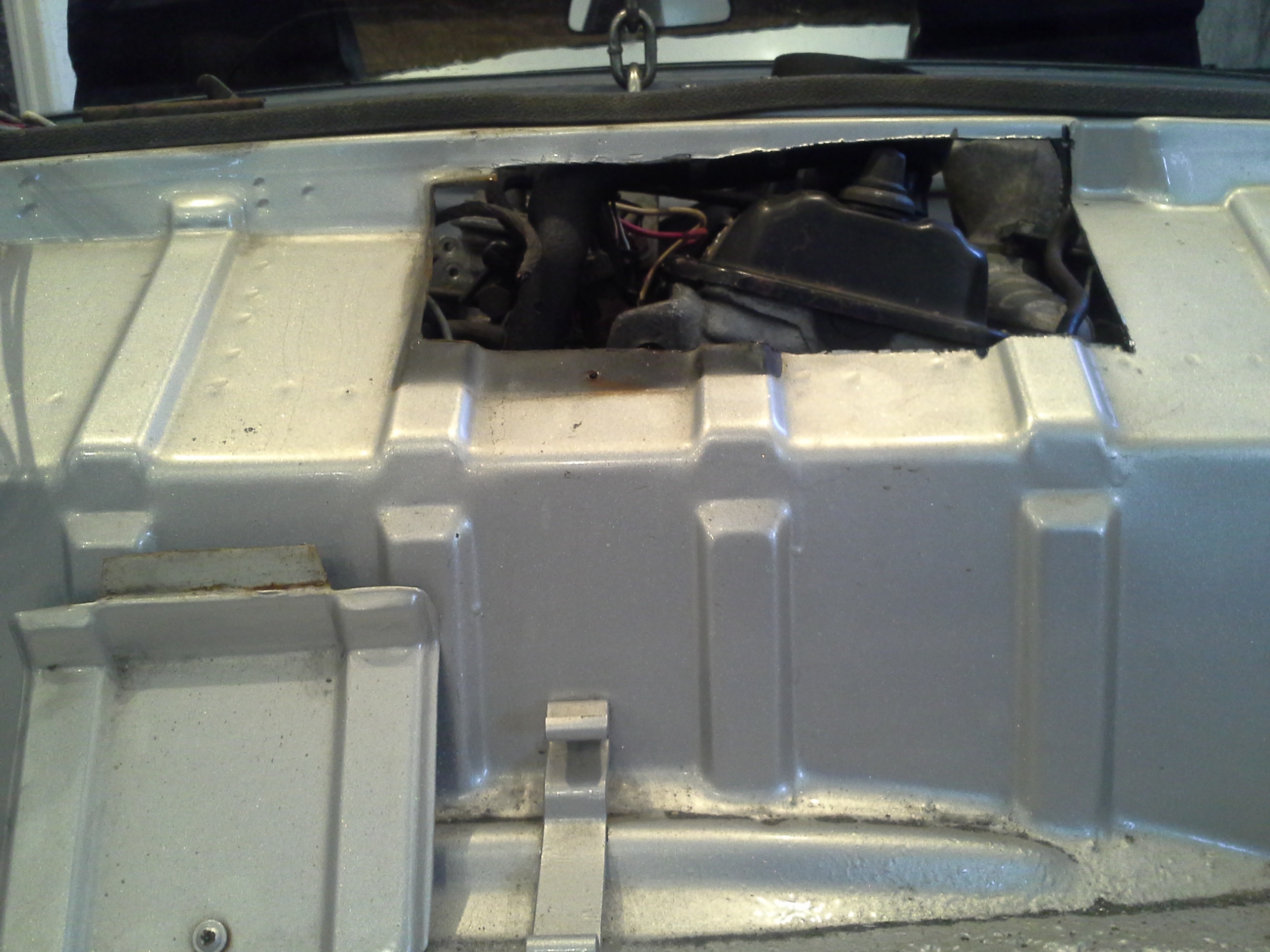

Did a little more cutting.... can't get the engine in line with the old position. Means we're into building a custom front crossmember... I had visions of using the stock crossmember to bolt to. It looked like it should work with everything sitting on the floor...Attached Image Attached Image Attached Image
