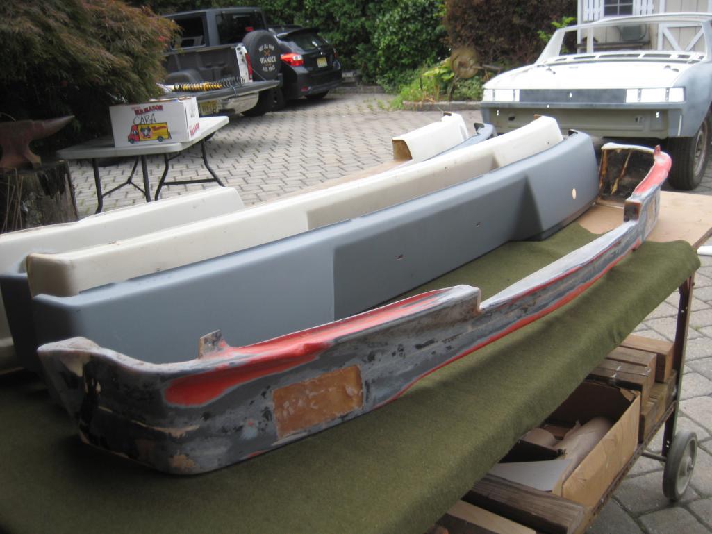

Where did that flared GT front spoiler/valance come from? Is it a custom piece made from a modified front spoiler?

Home modified aftermarket piece.
Bought it at Hershey and hacked it to pieces.
Cut it to suit the front cooler.
Took one inch from the the height.
Removed the brake cooler openings.
Cut each end vertically in three one inch pieces to create the flares.
My objective was to have a slightly deeper LE copy that suits a front cooler and GT flares.
Did it over the last two weeks.

Thanks for your description and photos. I should have read you earlier post #21 more closely. I have what I think is the same spoiler/air dam you started with in my attic. I picked it up years ago and always thought it was a little too deep or tall for a street 914. I also thought about cutting the height and filling the brake openings, but that's as far as that went. (IMG:style_emoticons/default/laugh.gif)
Again, good work and best of luck.
