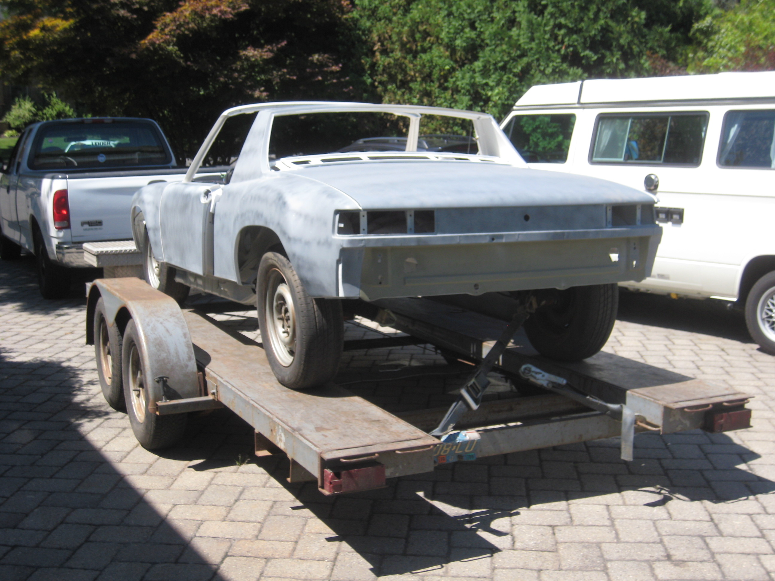

Big day for my GT project.
Getting a combination soda blast and garnet blast on my bare chassis and all the
removable panels.
The baking soda is used to remove paint and is suitable for the body panels.
The garnet is much more course and removes surface rust on the undersides.
I hope I did enough to keep it out of the longs and all the other cavities.
Fingers crossed.

Off to paint booth !
Whooo whooooo !!!!!
