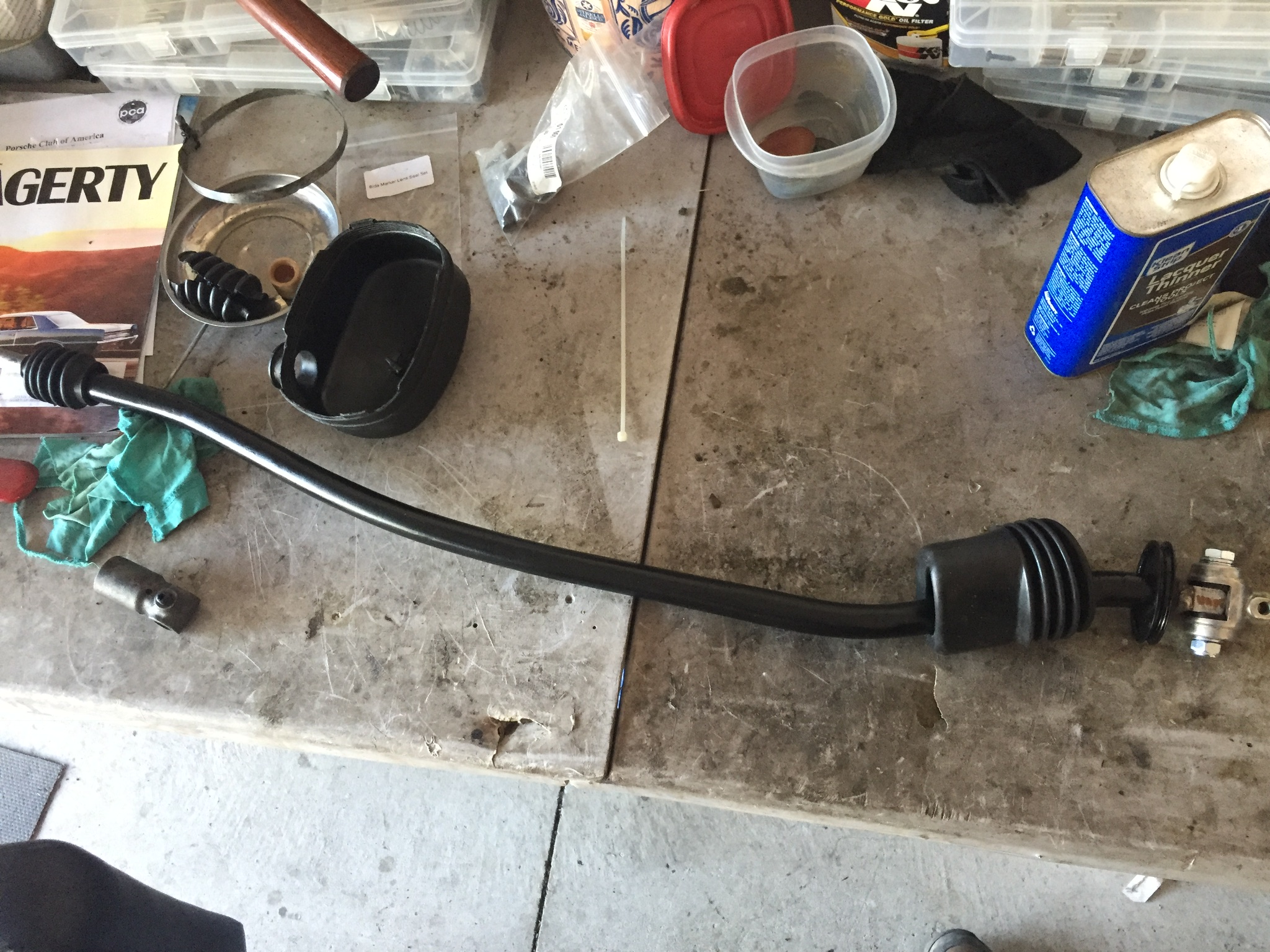

Quick update, so I am sure some of you probably know that I lost 2nd and 4th gear. Bought the entire shifter kit from Mark and a new coupler from Mark Heard (914sixer). Great parts Mark Heard, you got gems there.
Added all the bushings, new coupler and freshly grinded, primed and painted shifter rod.
I have to admit that job SUCKED (IMG:style_emoticons/default/smash.gif) (IMG:style_emoticons/default/w00t.gif). With the coupler breaking because the orignal pin was seized and installing the firewall bushing was hell. The metal in these are too soft because if you strike the end it with a hammer you create a mushroom effect and that happened to me twice. Luckily we found some tricks how to install them easier, but takes some time. I wish I had a press for situations like these. Got to put that in my checklist for garage shop equipment.
At the end everything turned out well. All the shifts throw good and is super tight. 4th is a tiny bit off, but manageable.
-Ed
