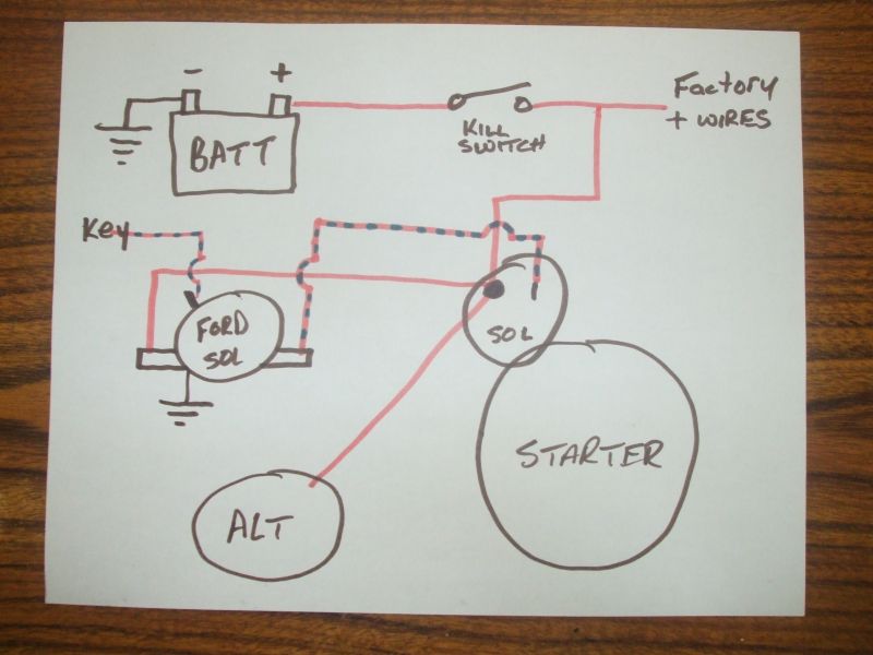

post Aug 4 2018, 10:50 AM
that's what I do!
Posts: 20,065
Joined: 27-December 02
From: Port Hope, Ontario
Member No.: 26
This is how my '67 bug is wired.
Also note the metal bracket on the ford solenoid must be grounded.

Mark Henry   This is how my '67 bug is wired. Also note the...   Aug 4 2018, 10:50 AM
