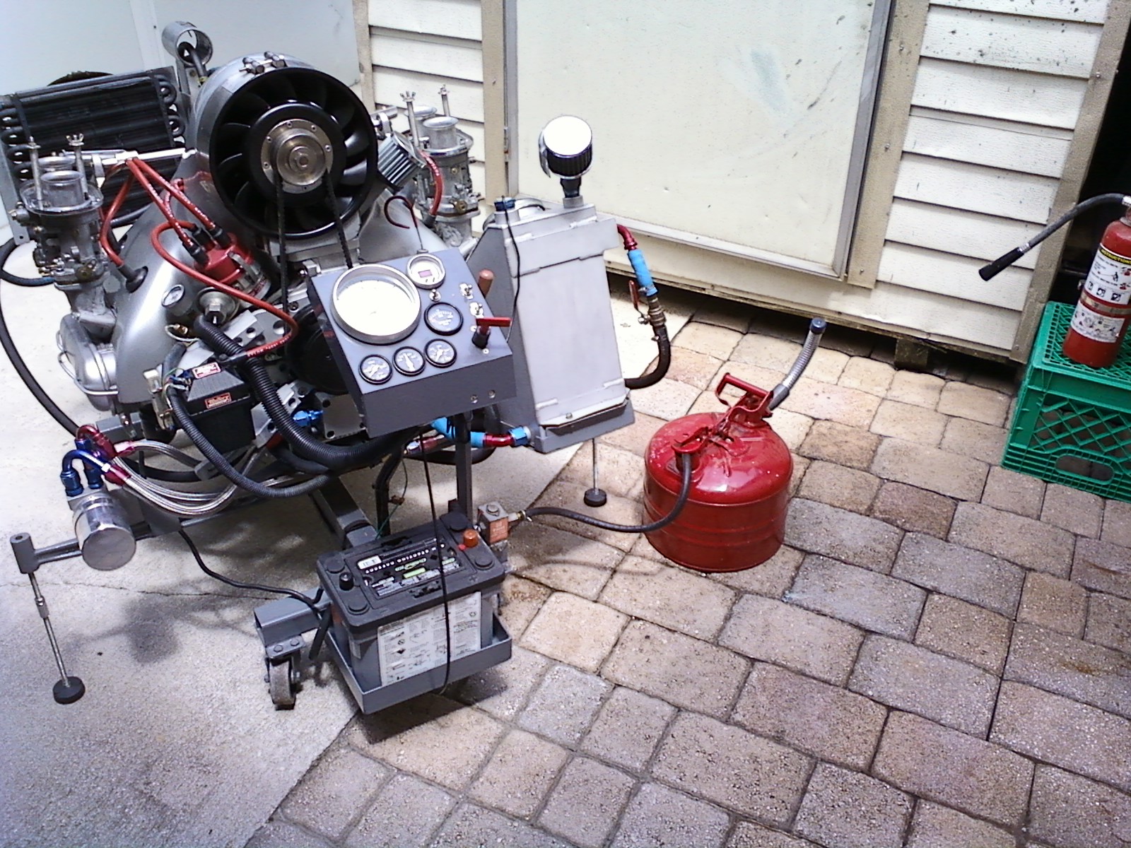

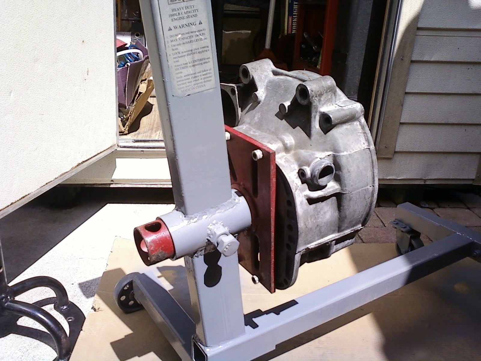

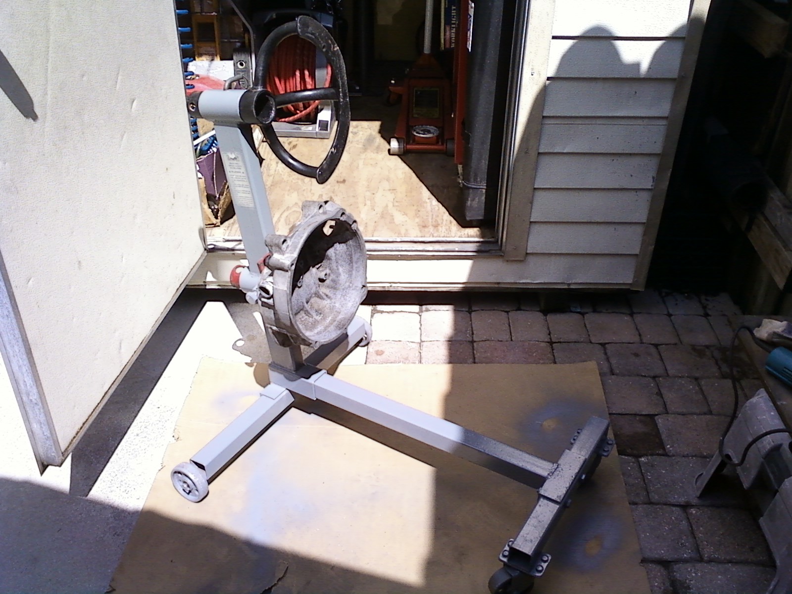

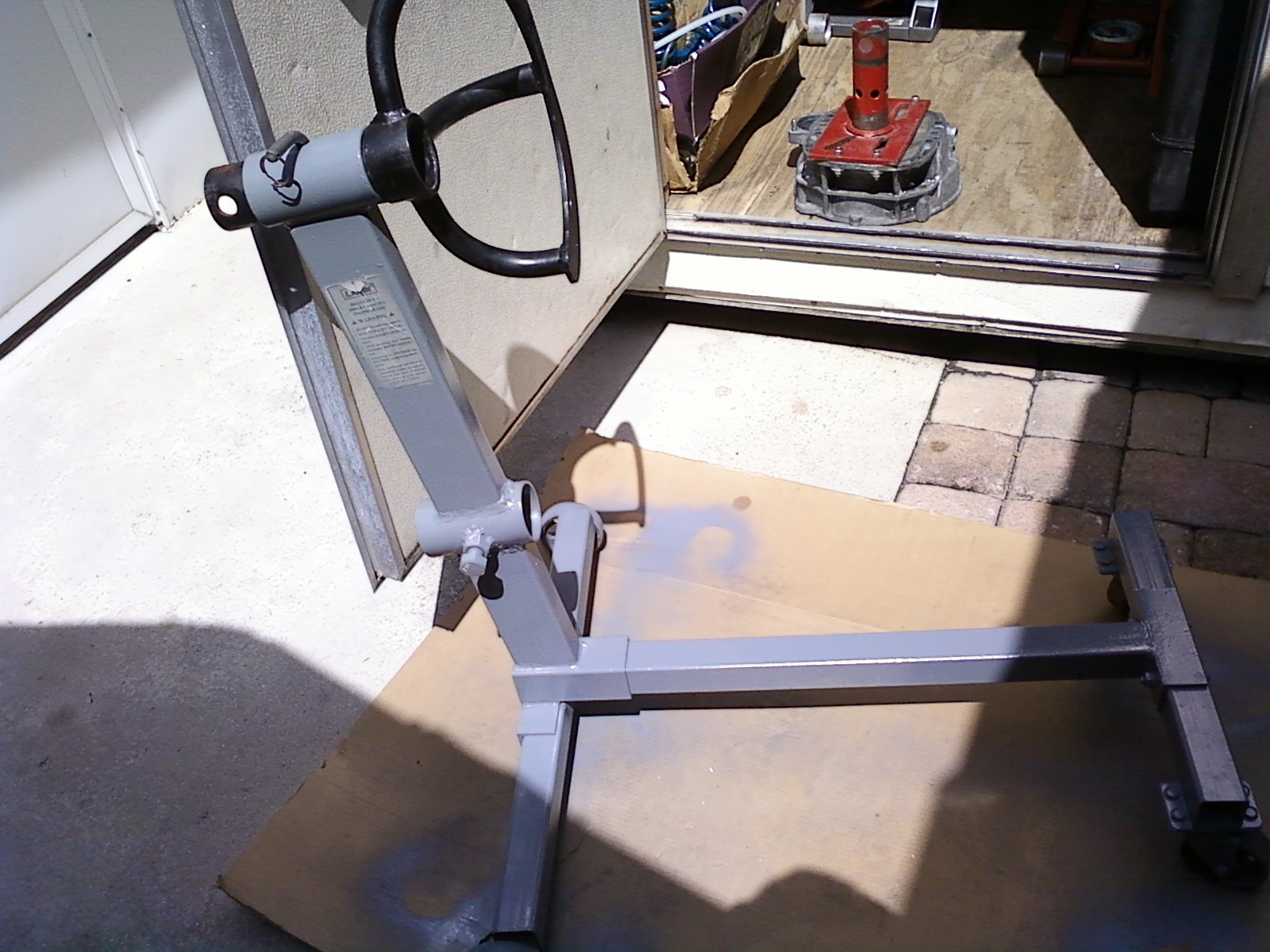

I modified a engine assembly stand into a run stand here's a few pic's Bill D.
plus a video (IMG:style_emoticons/default/smile.gif) https://www.youtube.com/watch?v=-UZSa4M-iuM |
