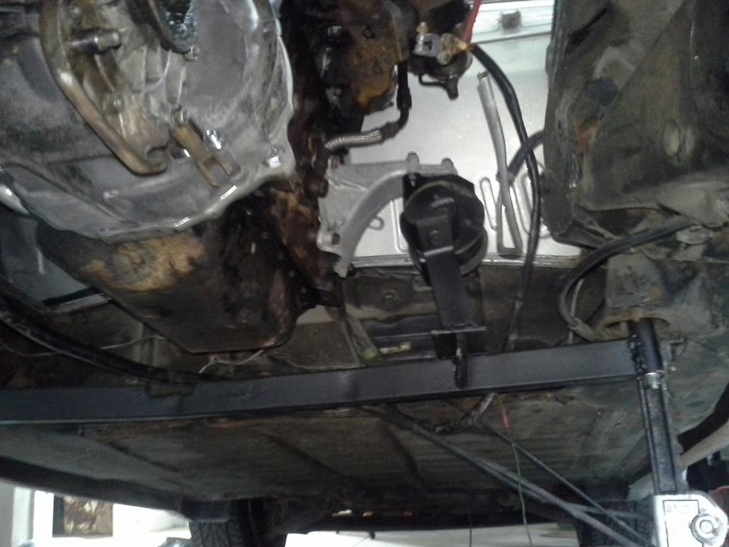

Had a chirp that turned into a BAD miss, valve seat issue on one cylinder.Attached Image
Had a fresh 1.9 AAZ diesel sitting in my storage trailer that had never been fired. (honed, rings, bearings, injection pump reseal). "new" engine was destined for my daily beater . Same engine in the beater is getting a little tired, I've put at least 350,000 km on it and the compression is getting down. Still runs okay though. Swapped the "new" engine into the beater. 16 year old son is learning...Attached Image

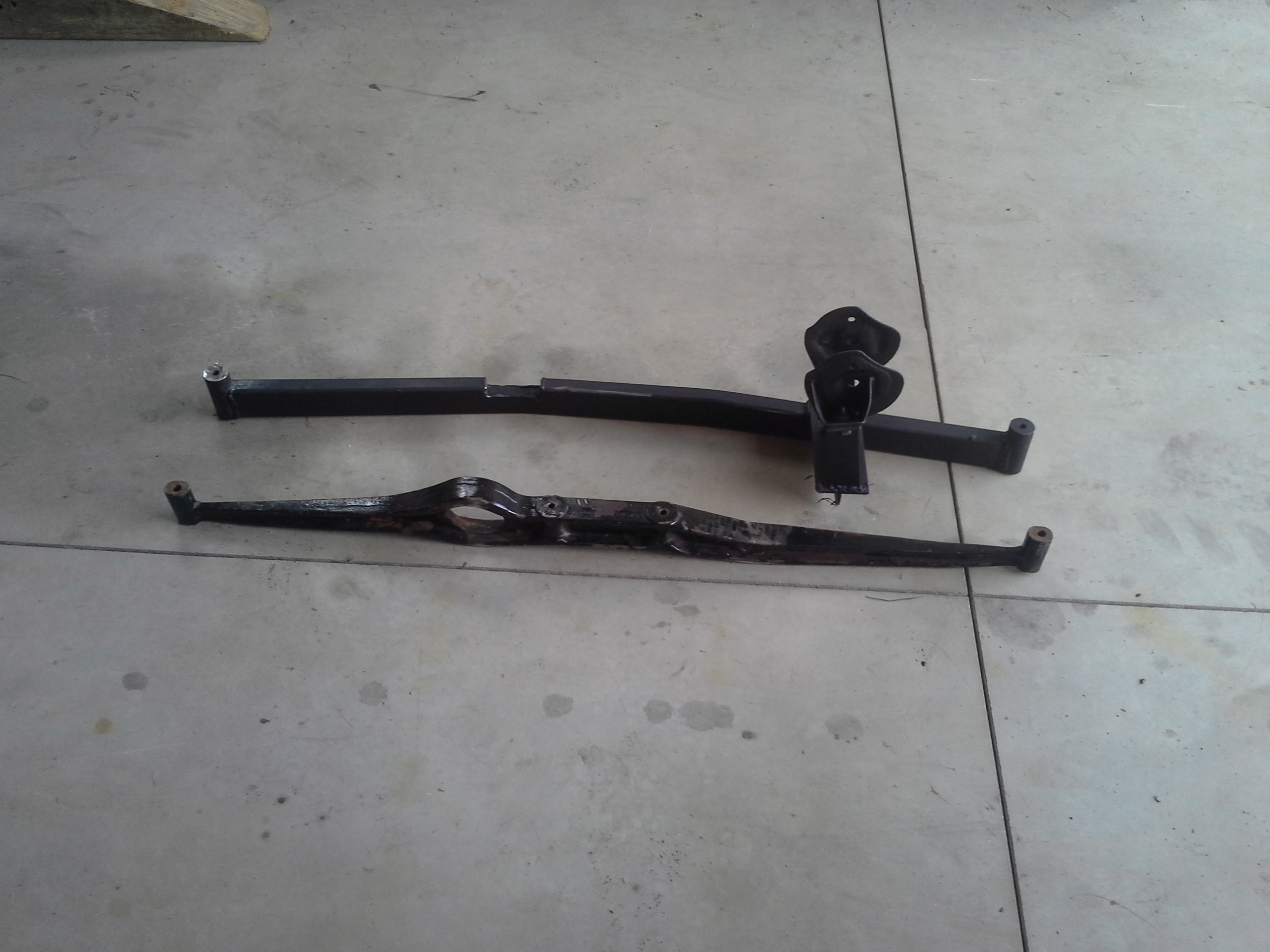

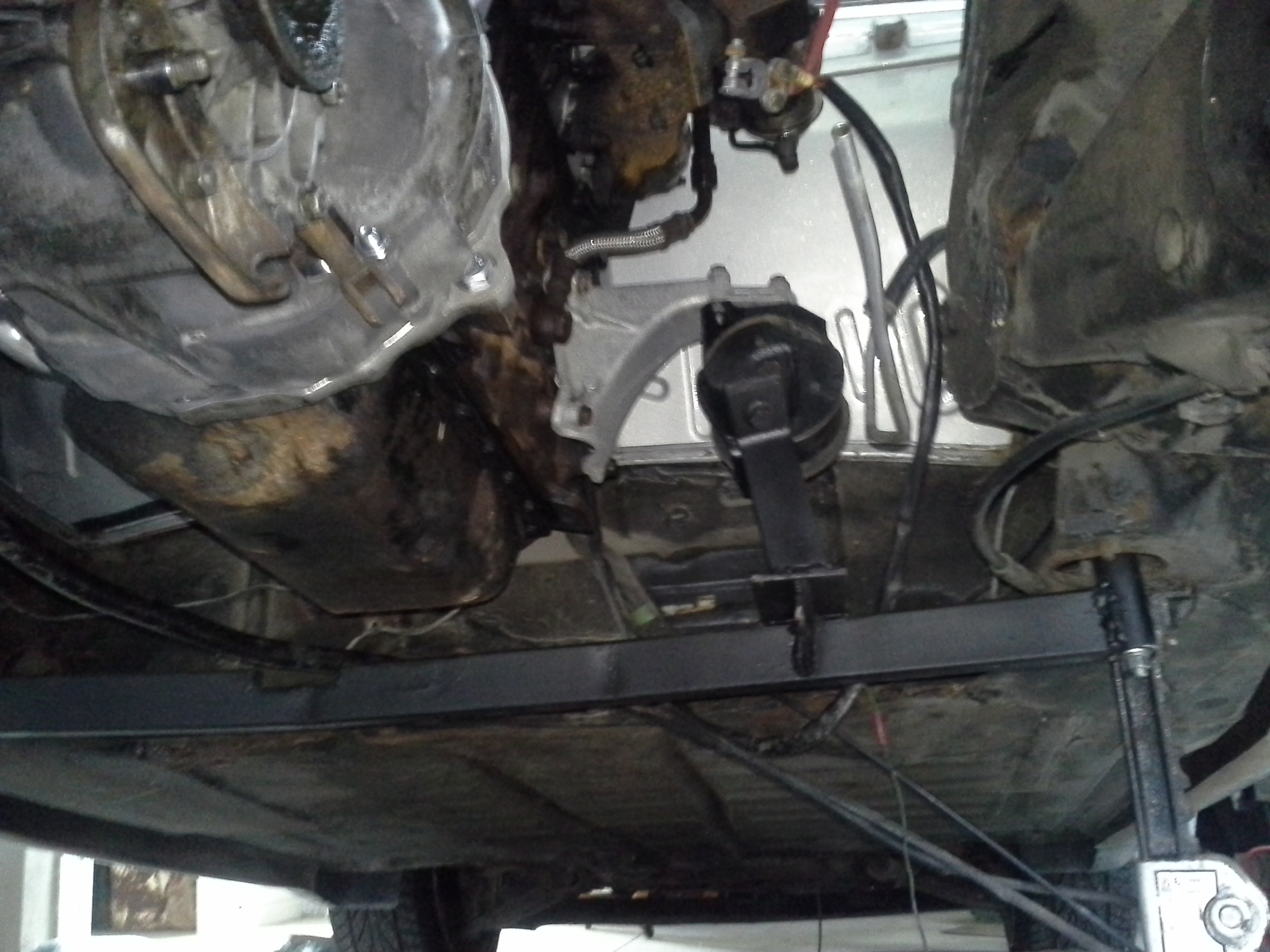

Engine is mounted, working on trying to put a rad in the engine compartment. I have one I can get in, not sure it's big enough though with the airflow it will get where it will be. Has a fan on it though.
Made a new crossmember to mount the front of the engine, bolted it to the stock location. Used a VW mount on the right side of the motor, we'll see if I need to add one on the left side after I get it running. VW mounts them at 3 points, not 4. Going to try it and see what happens. Sitting pretty nice at the moment but no torque on it. yet... Not sure if I can get away without bridging over the gearshift rod either. Attached Image Attached Image

PatrickB   Open to thoughts from those that have done other s...   Aug 8 2018, 04:34 AM
914forme   What wall thickness is the crossbar? What I don...   Aug 8 2018, 06:51 AM
PatrickB   What wall thickness is the crossbar? What I don...   Aug 8 2018, 10:36 AM
PatrickB   Not the best picture but shows the construction of...   Aug 8 2018, 11:03 AM
Chris914n6   You need a drivers side engine mount. No doubt abo...   Aug 8 2018, 03:25 PM
PatrickB   You need a drivers side engine mount. No doubt ab...   Aug 9 2018, 05:22 AM
stownsen914   Agreed with reinforcing your crossbar where the no...   Aug 9 2018, 07:29 AM
PatrickB   Agreed with reinforcing your crossbar where the n...   Aug 9 2018, 09:45 AM
