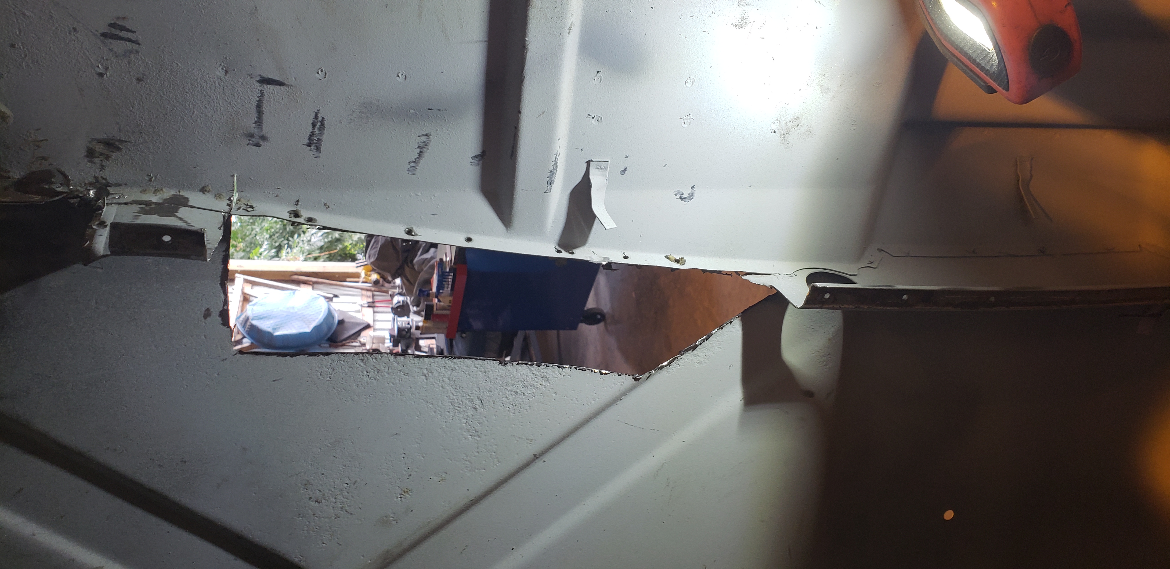

post Aug 6 2018, 09:25 PM
Posts: 22
Joined: 18-January 17
From: Hillsboro oregon
Member No.: 20,761
Some good progress was made this weekend on firewall patches. Attached Image

Taylor.914   Some good progress was made this weekend on firewa...   Aug 6 2018, 09:25 PM
Taylor.914   RE: Taylors new project thanks to Wes   Aug 6 2018, 09:26 PM
Taylor.914   RE: Taylors new project thanks to Wes   Aug 6 2018, 09:27 PM
