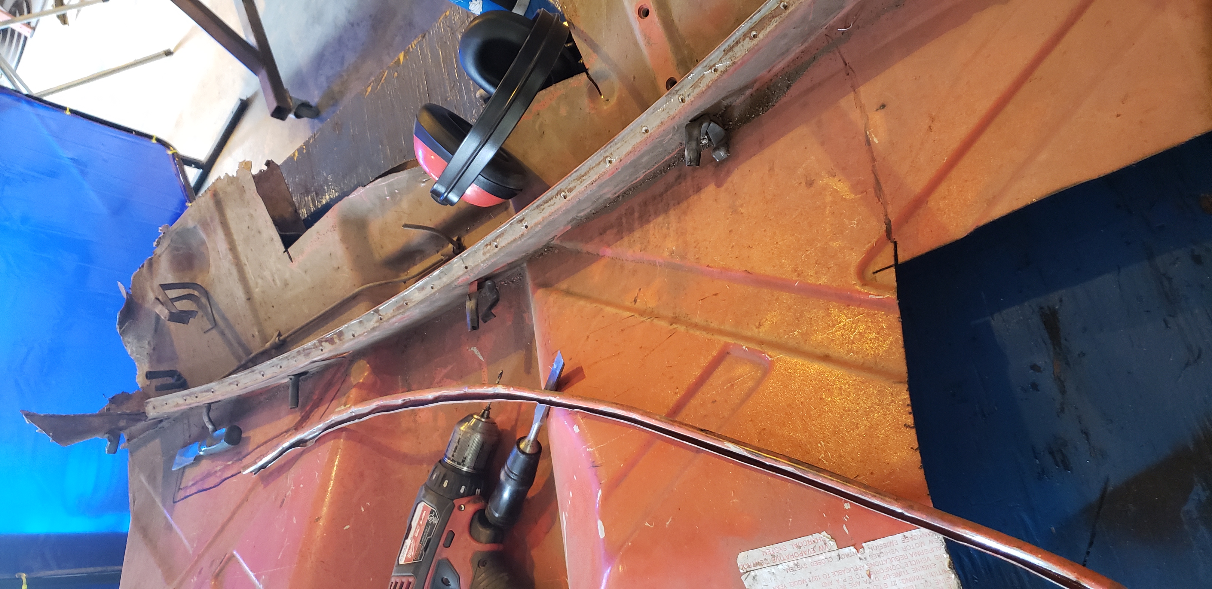

Taylor.914   Some good progress was made this weekend on firewa...   Aug 6 2018, 09:25 PM
Taylor.914   RE: Taylors new project thanks to Wes   Aug 6 2018, 09:26 PM
Taylor.914   RE: Taylors new project thanks to Wes   Aug 6 2018, 09:27 PM
Taylor.914   Prepping the donor.   Aug 6 2018, 09:29 PM
Taylor.914   RE: Taylors new project thanks to Wes   Aug 6 2018, 09:29 PM
