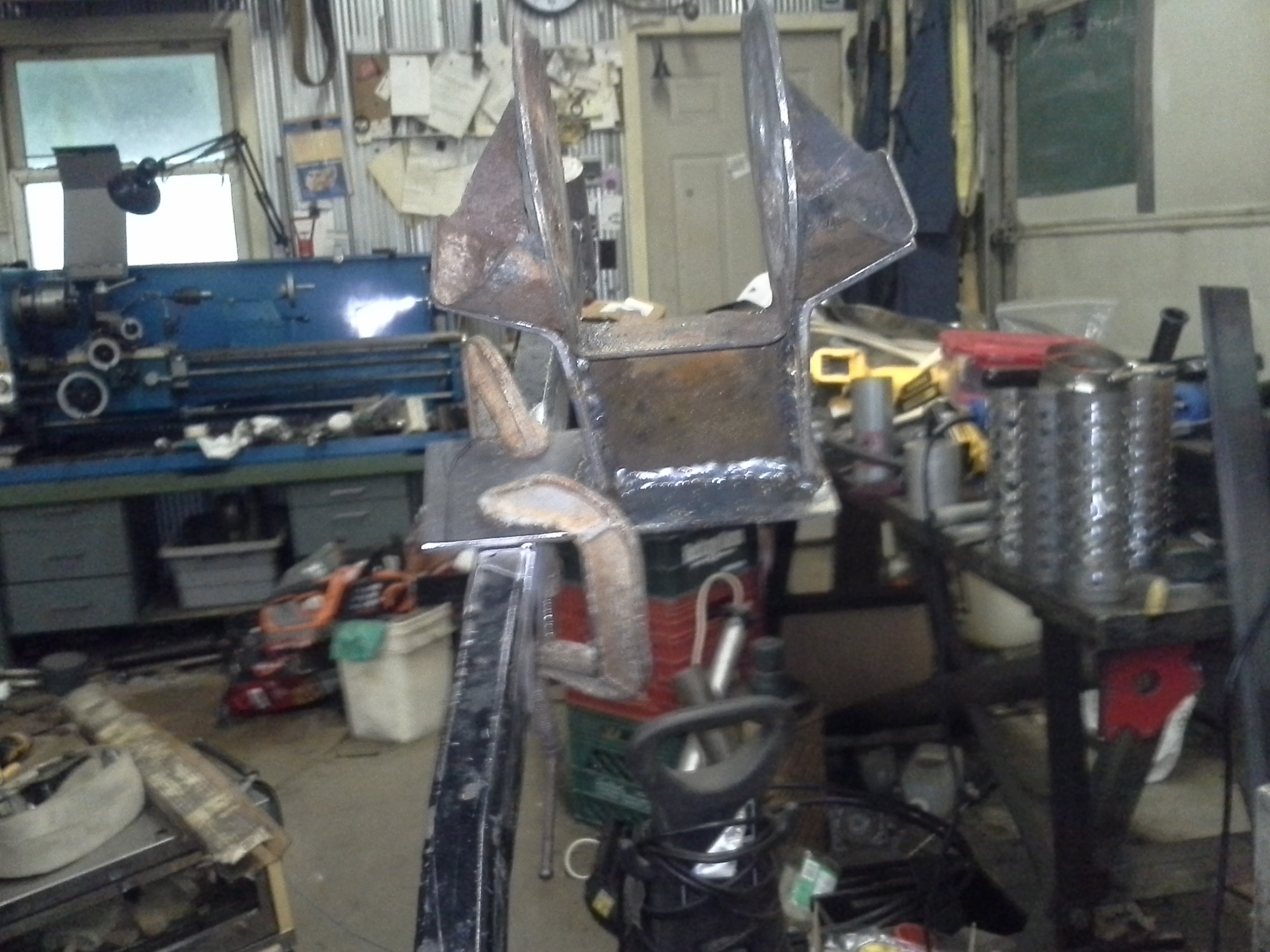

Not the best picture but shows the construction of the mount. For those not familiar with old VW water cooled, there's a big rubber donut in that goes in the opening with a bolt through the middle. Plate on top of the donut has 3 bolts that tie it to the casting off the engine.

PatrickB   Open to thoughts from those that have done other s...   Aug 8 2018, 04:34 AM
914forme   What wall thickness is the crossbar? What I don...   Aug 8 2018, 06:51 AM
PatrickB   What wall thickness is the crossbar? What I don...   Aug 8 2018, 10:36 AM
PatrickB   Not the best picture but shows the construction of...   Aug 8 2018, 11:03 AM
Chris914n6   You need a drivers side engine mount. No doubt abo...   Aug 8 2018, 03:25 PM
PatrickB   You need a drivers side engine mount. No doubt ab...   Aug 9 2018, 05:22 AM
stownsen914   Agreed with reinforcing your crossbar where the no...   Aug 9 2018, 07:29 AM
PatrickB   Agreed with reinforcing your crossbar where the n...   Aug 9 2018, 09:45 AM
