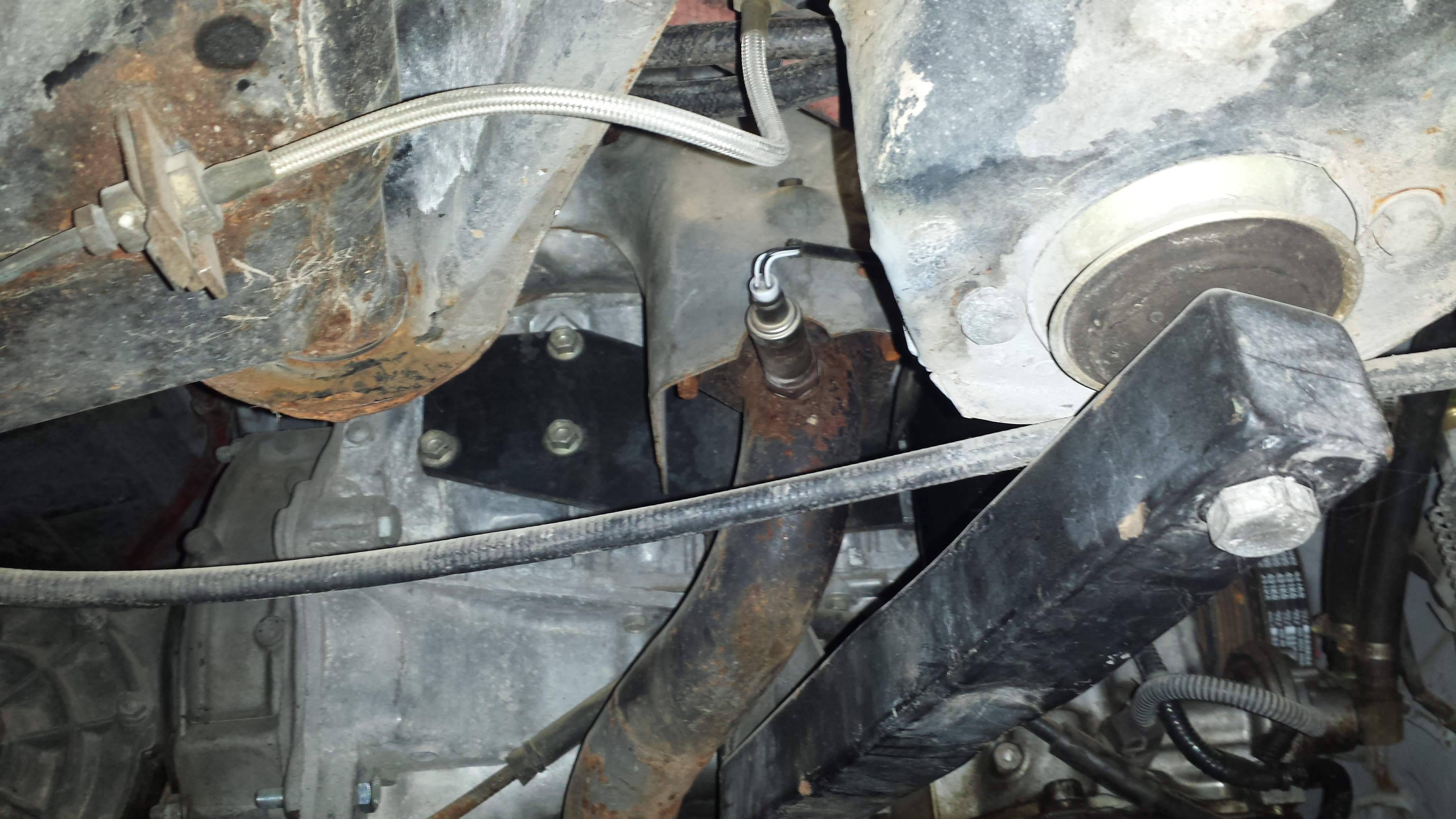

You need a drivers side engine mount. No doubt about it.
You can hard mount the crossbar to the engine and use 911 engine sport mounts at the body. I'll see if I have a clear pic of my setup.
Can't see it behind the exhaust but the tube is vertical with a 3" gusset. Tube is 1.5" thick wall and plates are iirc 3/16". It's 20-30 lbs beefy or at least it feels like it. Bolts to the factory engine mounts.

QUOTE(Chris914n6 @ Aug 8 2018, 05:25 PM) *
Thanks, looking forward to seeing it. I think we'll use what we've got short term with another mount on the other side, but may build something else in the long run. soft mounts at the bar to the body makes a lot of sense to me.

Agreed with reinforcing your crossbar where the notch is. The first version of my fabricated mount/crossbar for a 911 engine in a /4 chassis broke in the middle due to flexing. Fixed by triangulating in my case.

PatrickB   Open to thoughts from those that have done other s...   Aug 8 2018, 04:34 AM
914forme   What wall thickness is the crossbar? What I don...   Aug 8 2018, 06:51 AM
PatrickB   What wall thickness is the crossbar? What I don...   Aug 8 2018, 10:36 AM
PatrickB   Not the best picture but shows the construction of...   Aug 8 2018, 11:03 AM
Chris914n6   You need a drivers side engine mount. No doubt abo...   Aug 8 2018, 03:25 PM
PatrickB   You need a drivers side engine mount. No doubt ab...   Aug 9 2018, 05:22 AM
stownsen914   Agreed with reinforcing your crossbar where the no...   Aug 9 2018, 07:29 AM
PatrickB   Agreed with reinforcing your crossbar where the n...   Aug 9 2018, 09:45 AM
