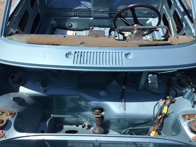

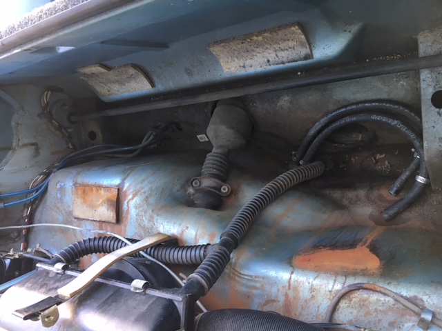

My car spent most of its life in the PNW specifically Portland/Seattle and was for the most part rust free.
When the tank was pulled it had enough corrosion to open up some pin holes upon media blasting prior to powder coating.
This is what I was dealing with. Whatever caused it, I have no idea.
Here is what it looks like after paint.
