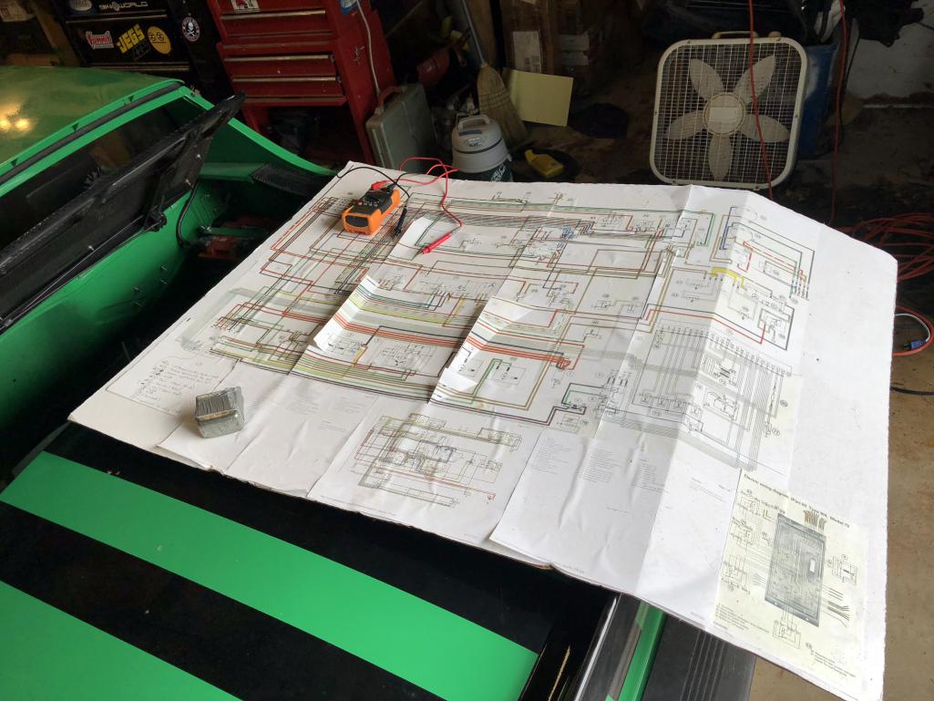

Vacca Rabite   Tonight I put the new alternator, harness and VR i...   Aug 18 2018, 07:59 PM
Spoke   12.89V at idle after the engine is warmed up or ri...   Aug 18 2018, 08:08 PM
Vacca Rabite   12.89V at idle after the engine is warmed up or r...   Aug 18 2018, 08:10 PM
Spoke   It sounds ok so far. How many times did you rev th...   Aug 18 2018, 08:48 PM
Vacca Rabite   System still isn’t charging right. I drove the ...   Aug 20 2018, 04:07 PM

Vacca Rabite   Well, the new solid state VR did nothing. I am for...   Aug 22 2018, 04:44 PM

Spoke   While you have the relay board out, measure the re...   Aug 22 2018, 07:54 PM
Vacca Rabite   While you have the relay board out, measure the r...   Aug 22 2018, 09:34 PM
Spoke   I did in fact powder coat the shroud and tins. Th...   Aug 23 2018, 04:42 AM
Vacca Rabite   I got Epstien's package in the mail today. So...   Aug 27 2018, 05:04 PM
Spoke   one ohm resistance from the alternator case to the...   Aug 28 2018, 04:53 AM
Vacca Rabite   EVERYTHING seems to be pointing to the voltage reg...   Aug 27 2018, 05:09 PM

VaccaRabite   I’m back to grounds. And I’m going to put a n...   Sep 8 2018, 03:06 PM
Spoke   I’m back to grounds. And I’m going to put a ...   Sep 8 2018, 04:13 PM
VaccaRabite   Goddamn happy dance. 14 volts at idle. 14 volts ...   Sep 8 2018, 05:17 PM
Spoke   Goddamn happy dance. 14 volts at idle. 14 volts...   Sep 8 2018, 10:06 PM
ClayPerrine   Goddamn happy dance. 14 volts at idle. 14 volts...   Sep 9 2018, 05:34 AM
