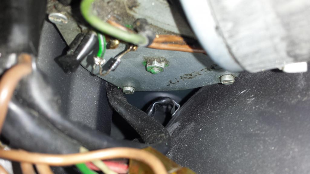

The driver side headlight on my '75 914 won't go down when the switch is turned off. I tried probing around and found I can get it to go down by lightly pushing on the black sleeving that covers the green wire. I thought, ok, must be a broken wire, or a broken solder joint. I cut away the sleeving and I see what looks to be a capacitor (?).
I the accompanying photo, if I push on the capacitor lead adjacent to the motor terminal, I get nothing. If I push on the capacitor lead at the green wire, I get nothing. However, if I push on the capacitor lead close to its (black) body at the one o'clock side, the light goes down. I get nothing pushing on the seven o'clock side. Damaged capacitor perhaps? I have a set of motors from a '72 or '73 (don't know if they work), but will I find the same capacitor under their sleeving? Would I be better off buying a new capacitor from the electronics supply? Does anyone know the value of the capacitor? Thanks, Andys Attached thumbnail(s) |

era vulgaris That looks like a diode, but it's tough to tel... Sep 6 2015, 06:12 PM
Maltese Falcon Agreed, not a capacitor. Just out of curiosity hav... Sep 6 2015, 07:43 PM

steuspeed I see 4 diodes :confused: Sep 7 2015, 02:22 PM

andys Ooops, Yeah I mean diodes!
Anyone care to tak... Sep 7 2015, 02:43 PM
