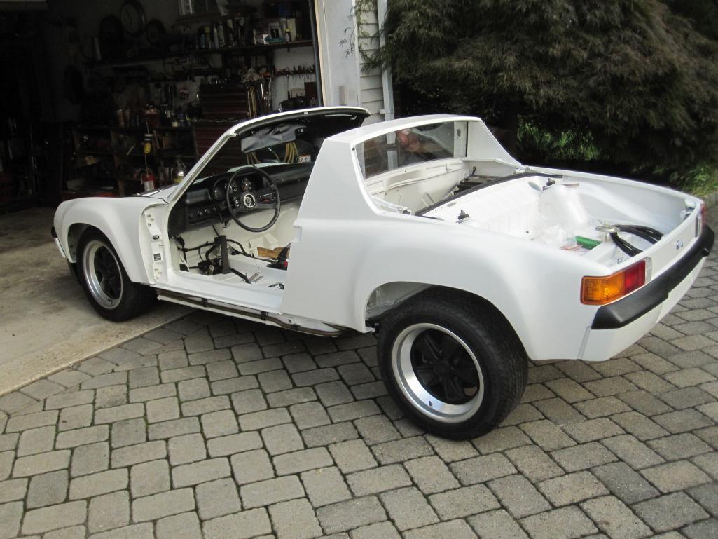

Couple more pictures.
Installed the wheels to check if I'd need longer studs and spacers.
The ancient tires (P7s !) will be replaced and the wheels will be done.
Finally fitted the oil cooler plumbing.
