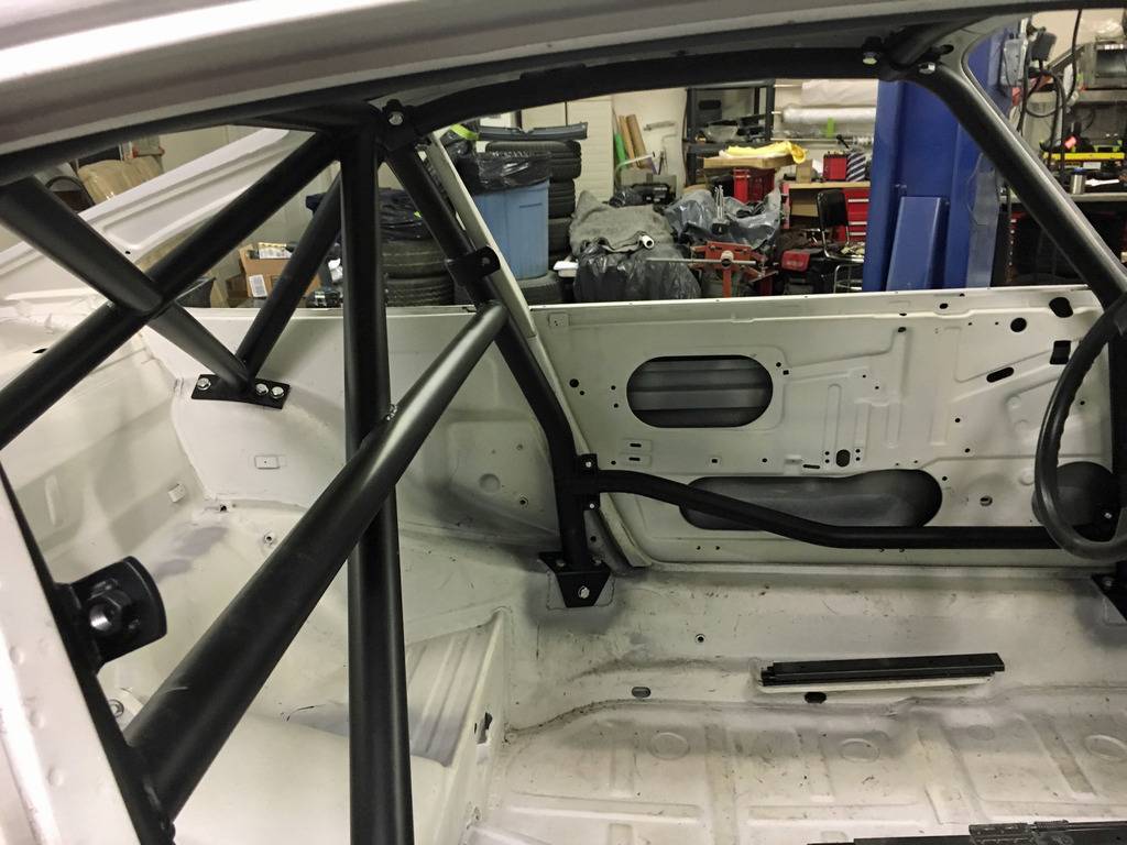

Ed is an engineer as is my son. While they are about ten years apart in age, they have always had this friendship based on their mutual love of figuring out things. My son was very pleased to see Ed again. Because of Ed's condition, it takes him a while to get going so they gave us the key to the outbuilding and the garage door opener to their garage so we could begin the loading process. We began loading around 3:00 and finished up by 6:00. After a quick shower, we all met for dinner which was spent reminiscing about past PCA event as well as my son talking about some of his experiences with his job at Toyota Racing Development. It was a long, pleasant dinner and the perfect end to the day.

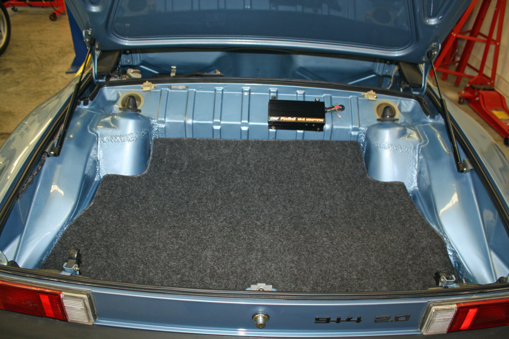

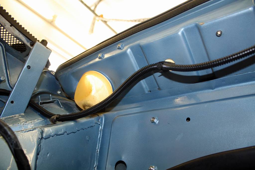

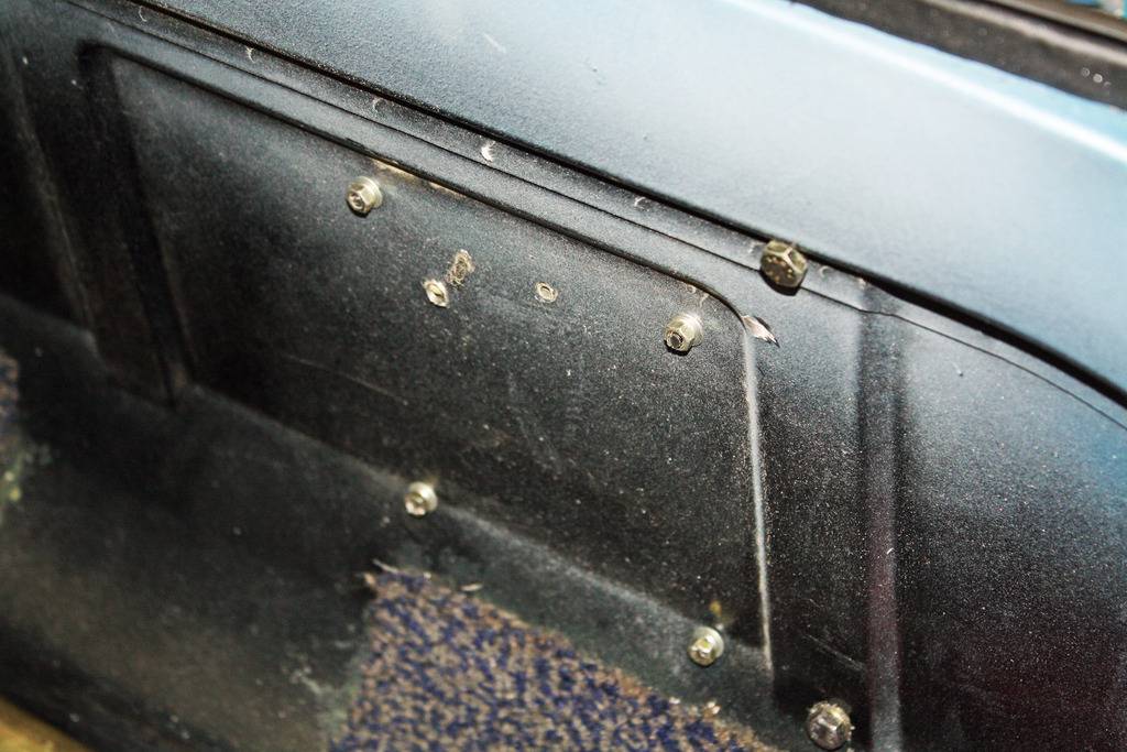

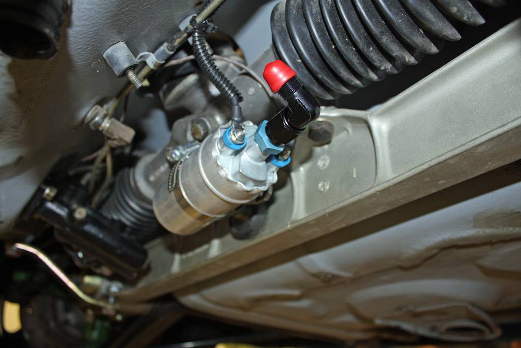

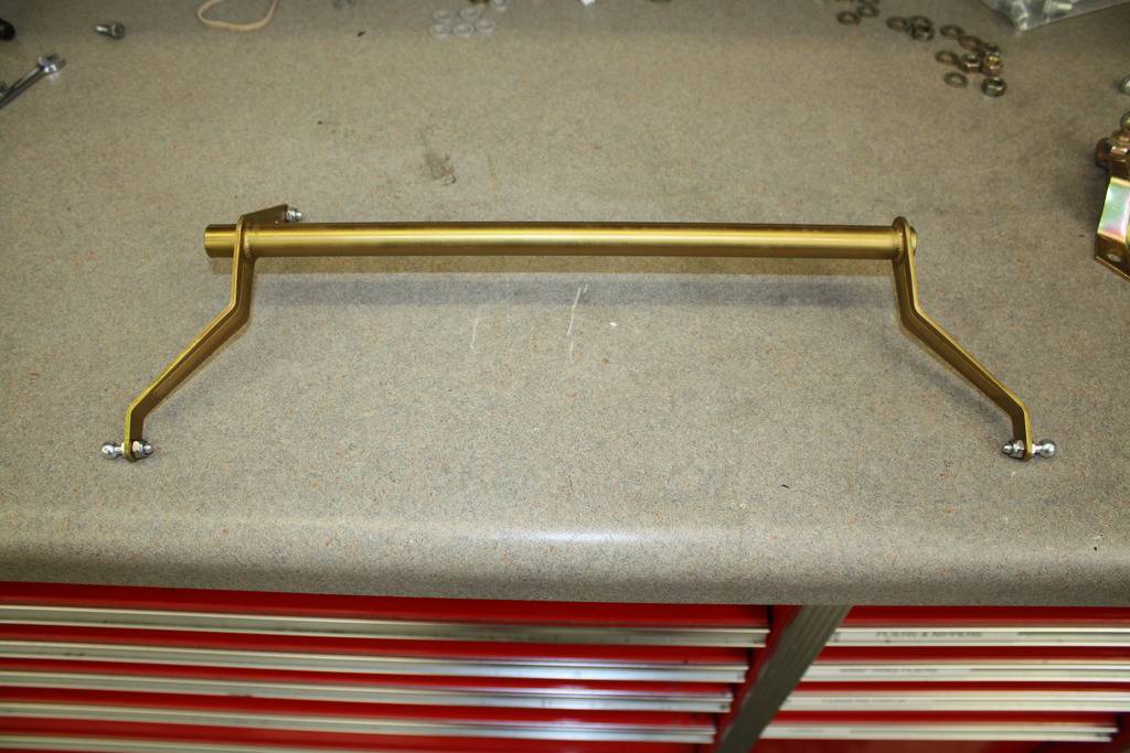

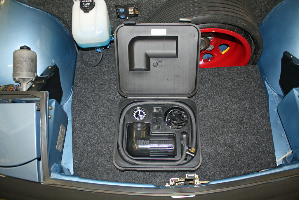

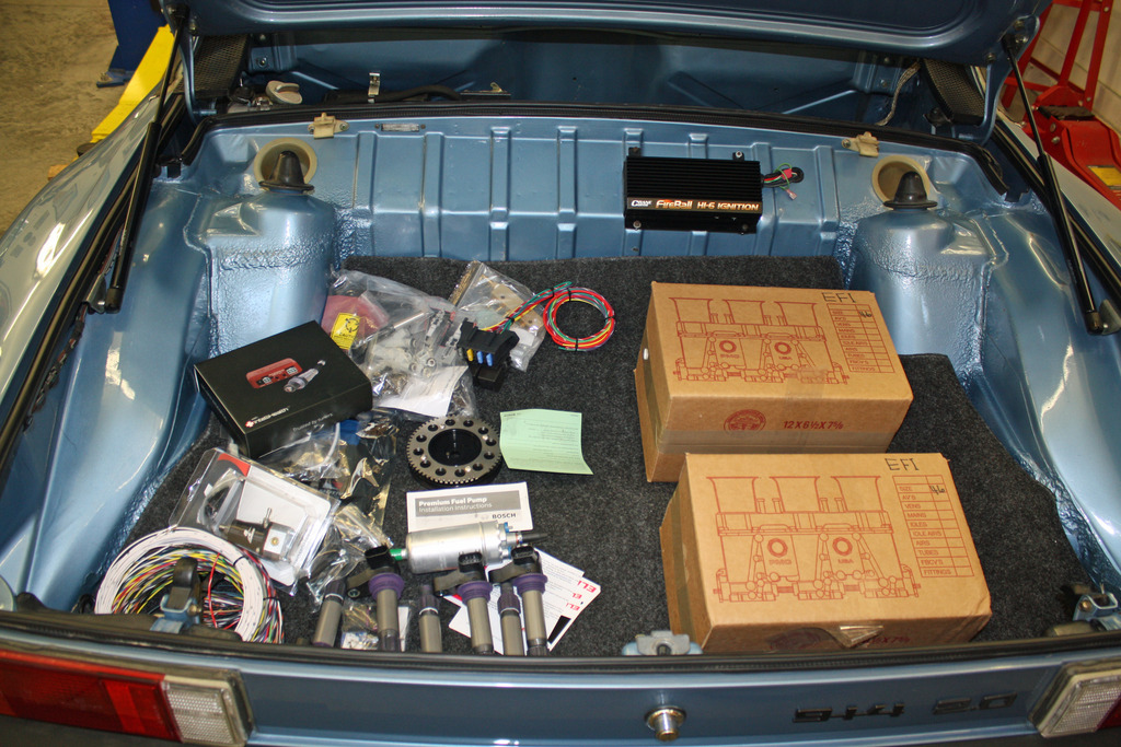

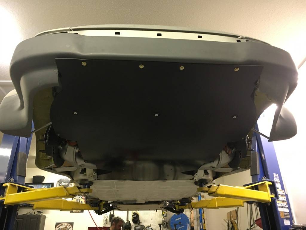

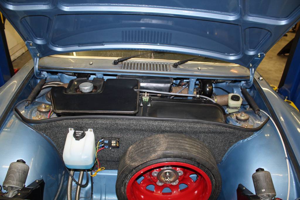

Now the car is in my garage, the parts have been stowed and I am ready to put it back together.
(IMG:http://www.914world.com/bbs2/uploads_offsite/i188.photobucket.com-22140-1529202754.11.jpg)
(IMG:http://www.914world.com/bbs2/uploads_offsite/i188.photobucket.com-22140-1529202754.12.jpg)

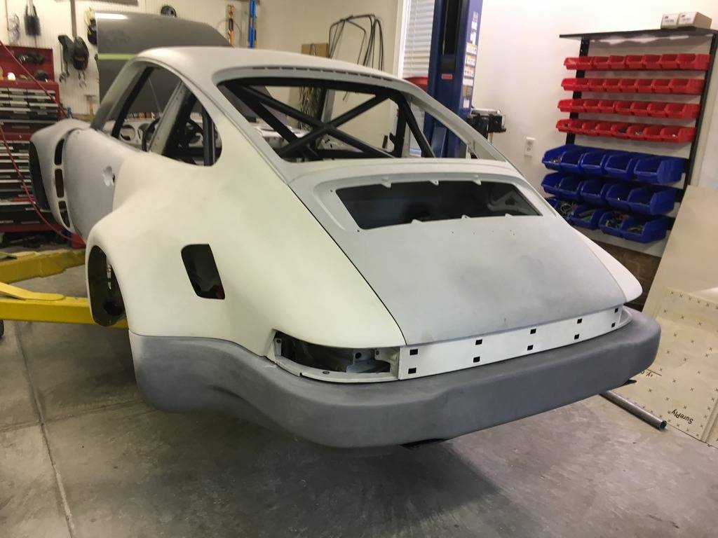

The photos below were taken soon after Ed had bought the car, which will give an idea of what it will look like once it is back on the road.

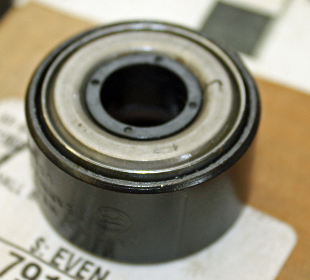

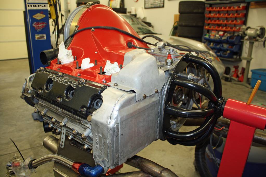

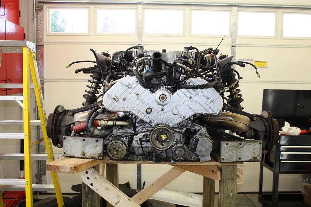

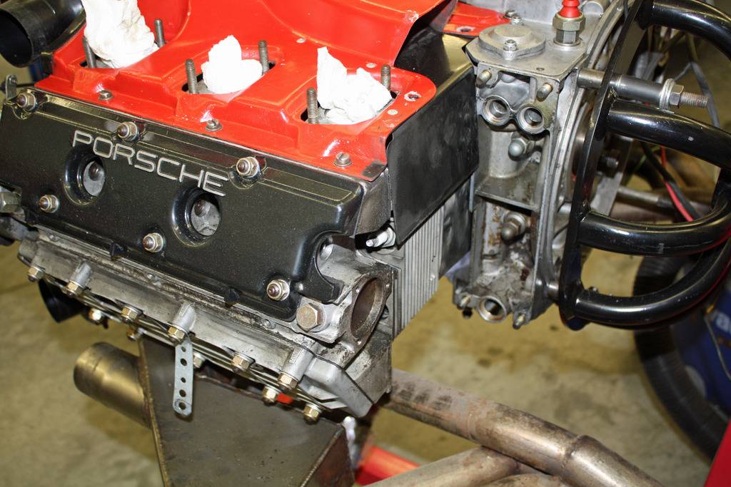

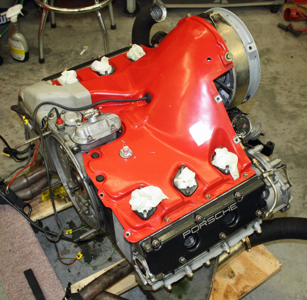

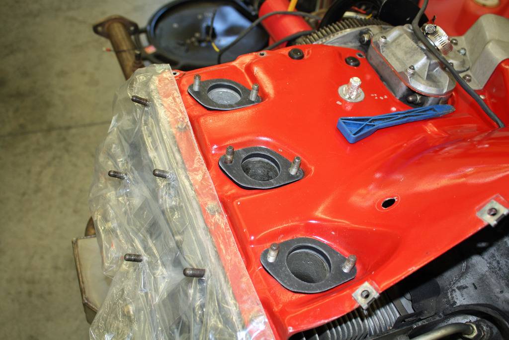

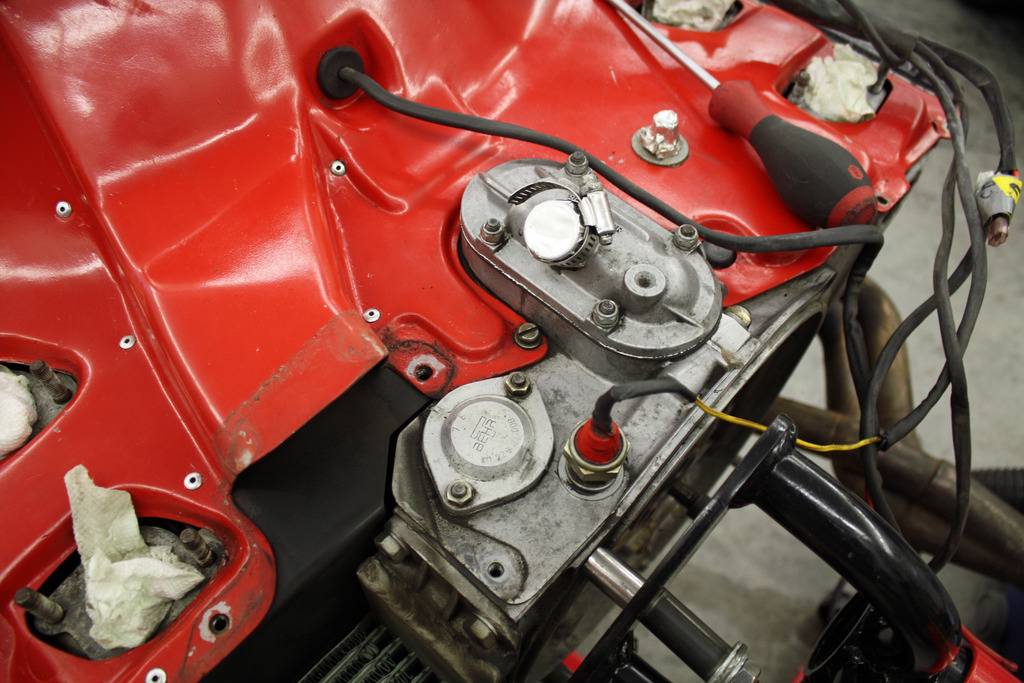

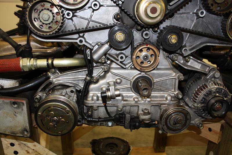

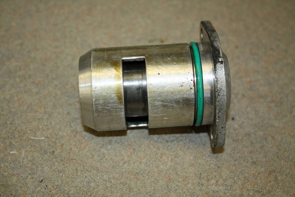

I finally found a few hours to spend on the engine today. At the rear of a 911 engine is the "Holy Trinity", a place where oil leaks commonly occur. The three items are the oil pressure sender, the oil thermostat, and the breather. Since these would be very difficult to get to once the motor is back in the car, I removed all of them and re-sealed them. Being a little pro-active here.
(IMG:http://www.914world.com/bbs2/uploads_offsite/i188.photobucket.com-22140-1534900813.1.jpg)
(IMG:http://www.914world.com/bbs2/uploads_offsite/i188.photobucket.com-22140-1534900813.2.jpg)
(IMG:http://www.914world.com/bbs2/uploads_offsite/i188.photobucket.com-22140-1534900813.3.jpg)
(IMG:http://www.914world.com/bbs2/uploads_offsite/i188.photobucket.com-22140-1534900813.4.jpg)
(IMG:http://www.914world.com/bbs2/uploads_offsite/i188.photobucket.com-22140-1534900814.5.jpg)

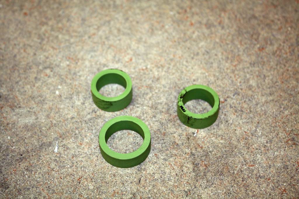

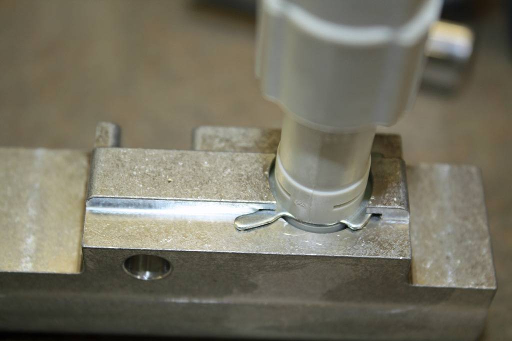

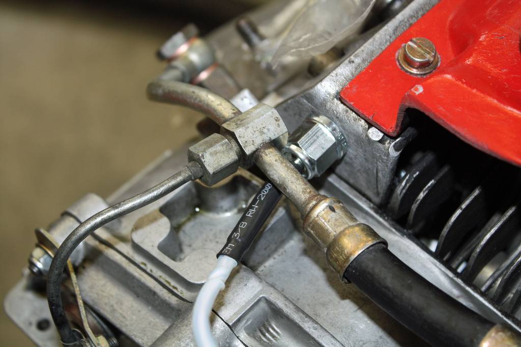

Another potential oil leak can come from the engine oil cooler. There are three green seals that I replaced. I spent some time cleaning here as well.
(IMG:http://www.914world.com/bbs2/uploads_offsite/i188.photobucket.com-22140-1534900814.6.jpg)
(IMG:http://www.914world.com/bbs2/uploads_offsite/i188.photobucket.com-22140-1534900814.7.jpg)
(IMG:http://www.914world.com/bbs2/uploads_offsite/i188.photobucket.com-22140-1534900814.8.jpg)
(IMG:http://www.914world.com/bbs2/uploads_offsite/i188.photobucket.com-22140-1534900814.9.jpg)
(IMG:http://www.914world.com/bbs2/uploads_offsite/i188.photobucket.com-22140-1534900814.10.jpg)
(IMG:http://www.914world.com/bbs2/uploads_offsite/i188.photobucket.com-22140-1534900814.11.jpg)

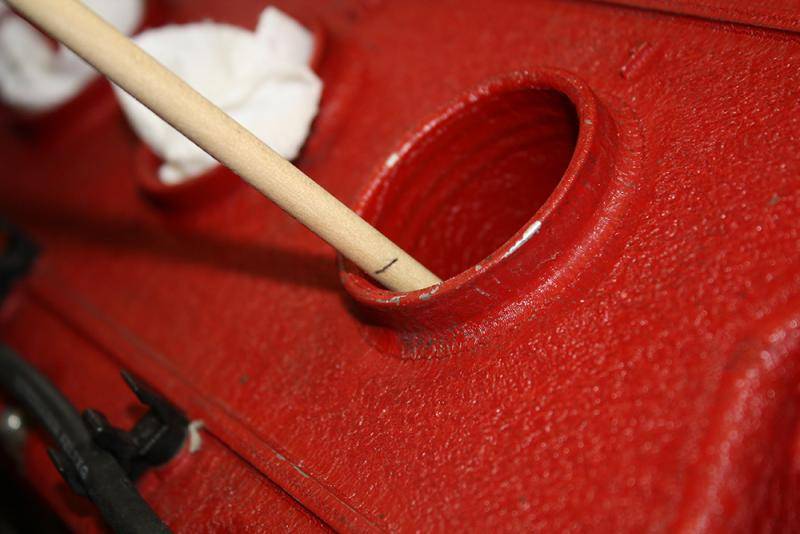

In anticipation of adjusting the valves, I removed the valve covers on one side before I ran out of time. To get the upper valve cover off, I had to loosen the oil line for the pressure fed chain tensioner. This allowed me to rotate it slightly to make clearance for the valve cover. I taped a note on it to remind me to tighten it once I replace the valve cover.

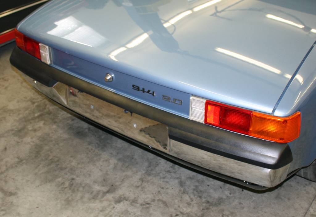

jerhofer   BTW, Ed says the 2.0 on the rear badge stand for t...   Jun 17 2018, 05:20 AM

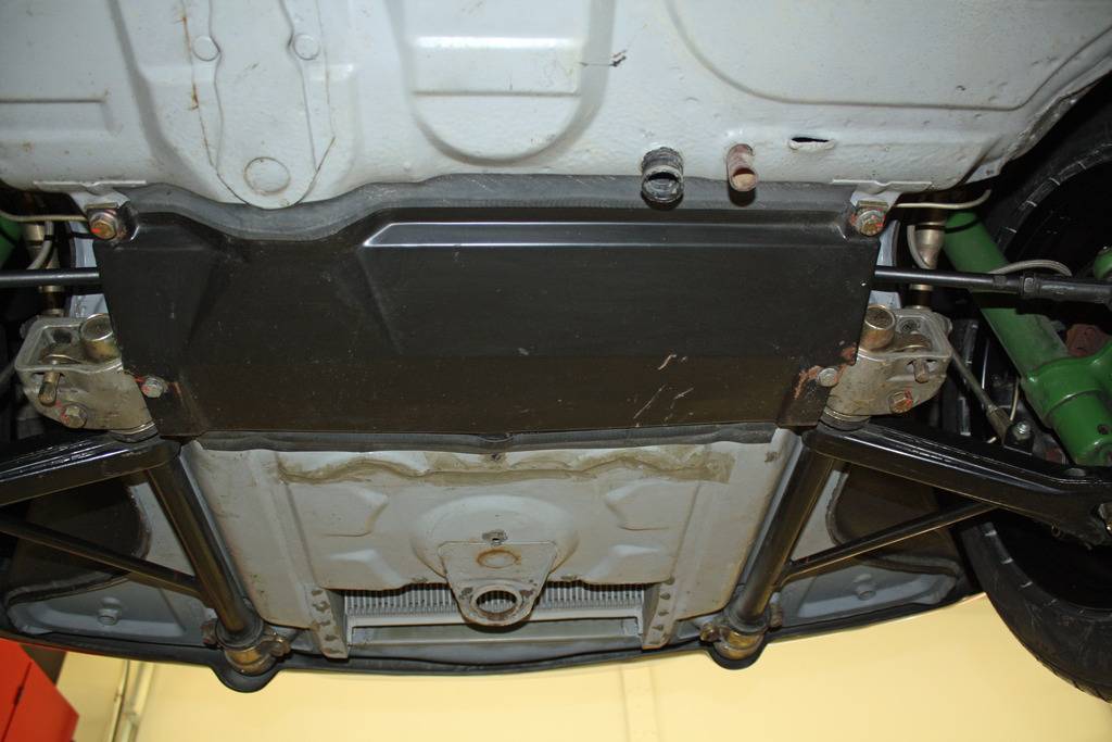

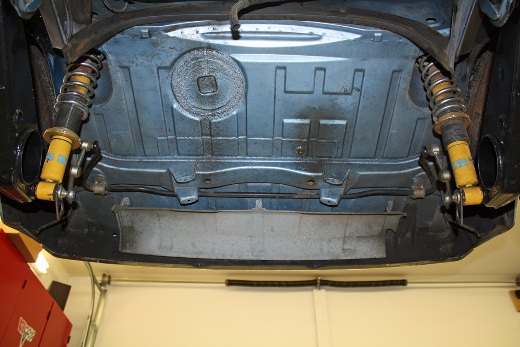

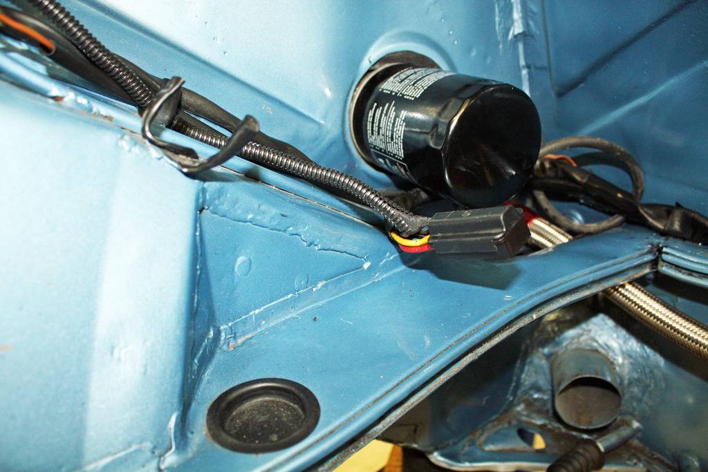

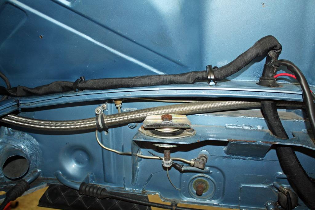

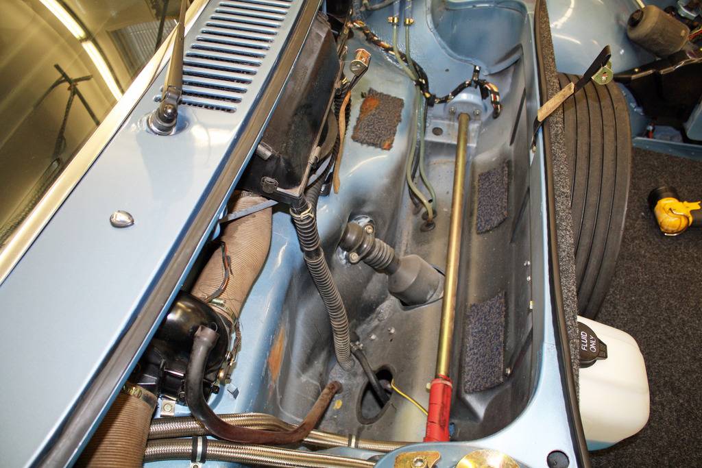

jerhofer   Perry built in an oil cooler box in the front trun...   Jun 17 2018, 12:07 PM

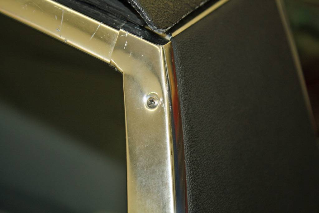

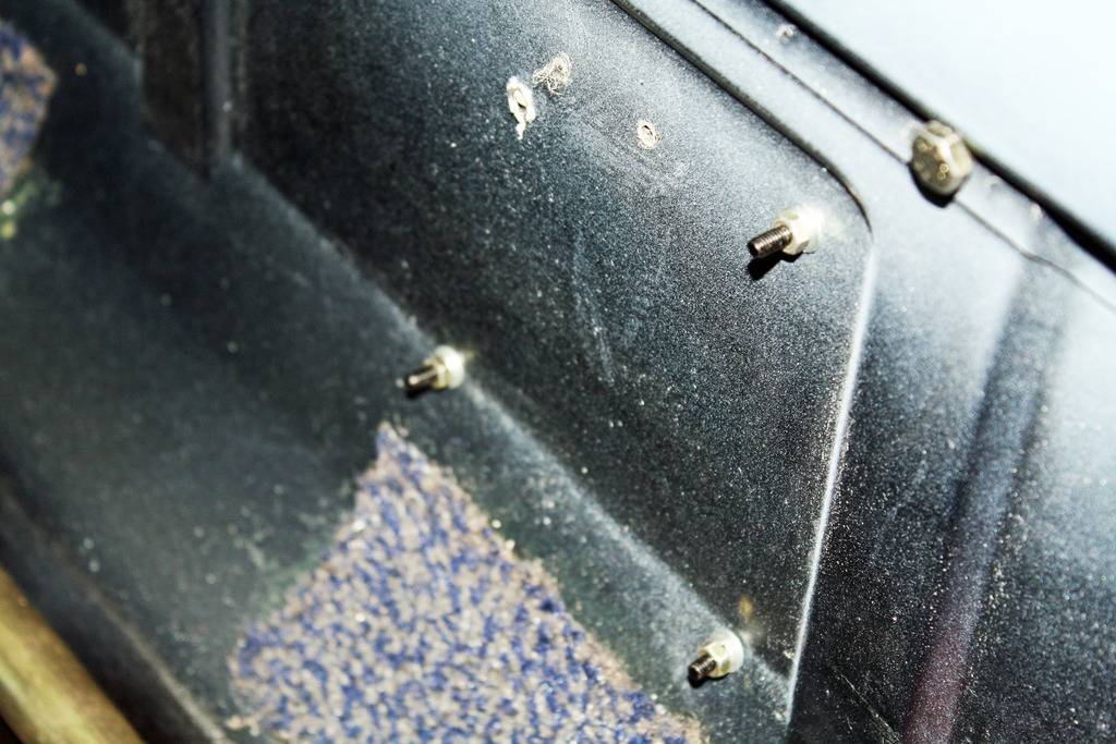

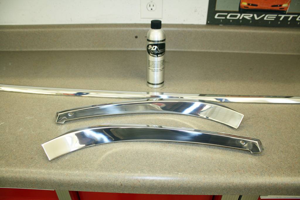

jerhofer   The sail panel trim and the long trim pieces acros...   Jun 18 2018, 03:11 PM

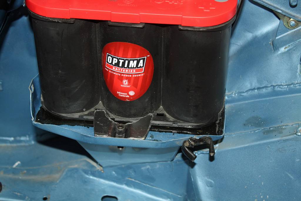

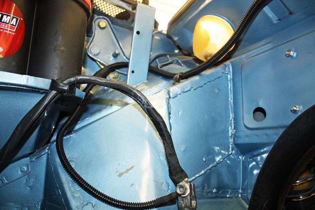

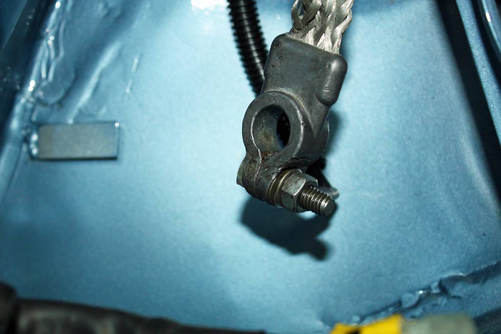

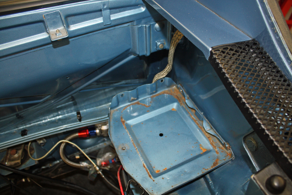

jerhofer   There was some surface rust in the battery tray. ...   Jun 18 2018, 03:23 PM

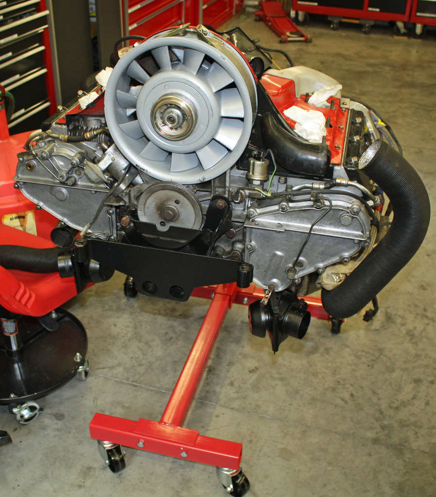

jerhofer   I used my overhead hoist to lift the motor so I co...   Jun 21 2018, 03:58 PM

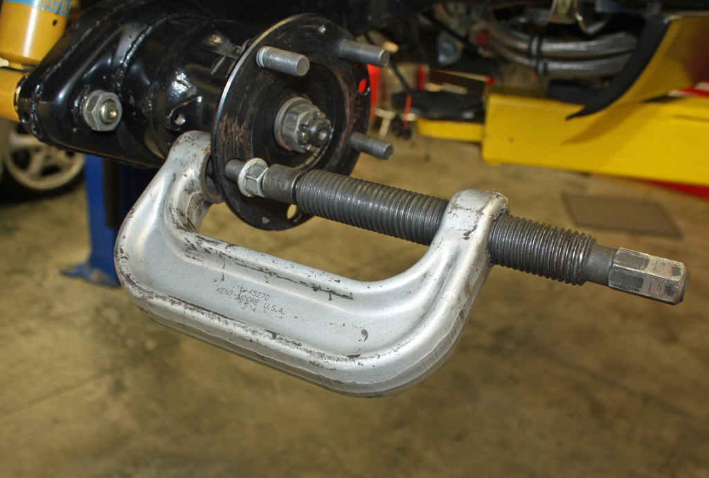

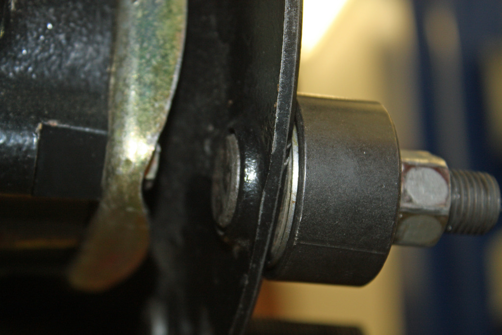

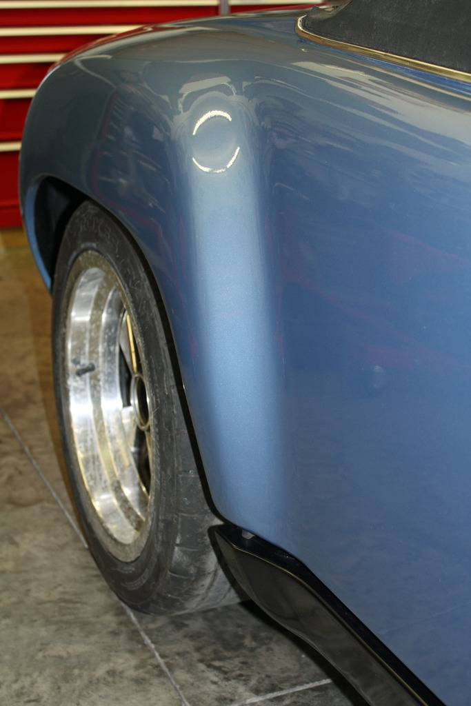

jerhofer   To make the 9" wheels work on the rear, I nee...   Jun 21 2018, 04:10 PM

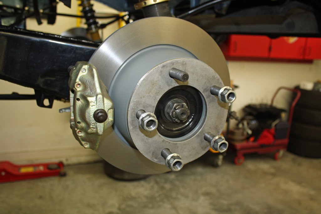

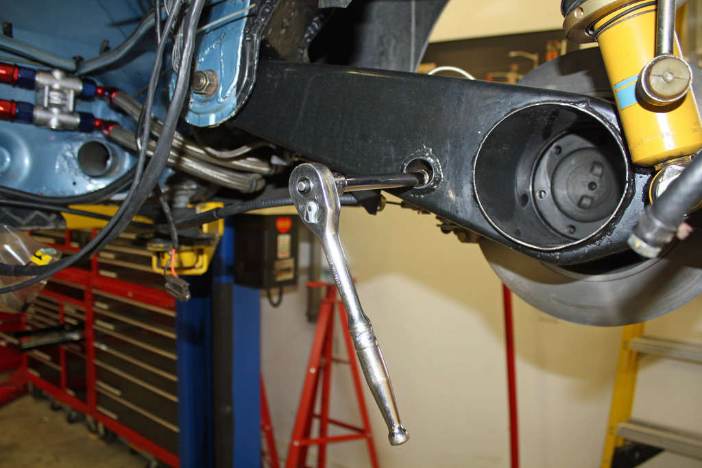

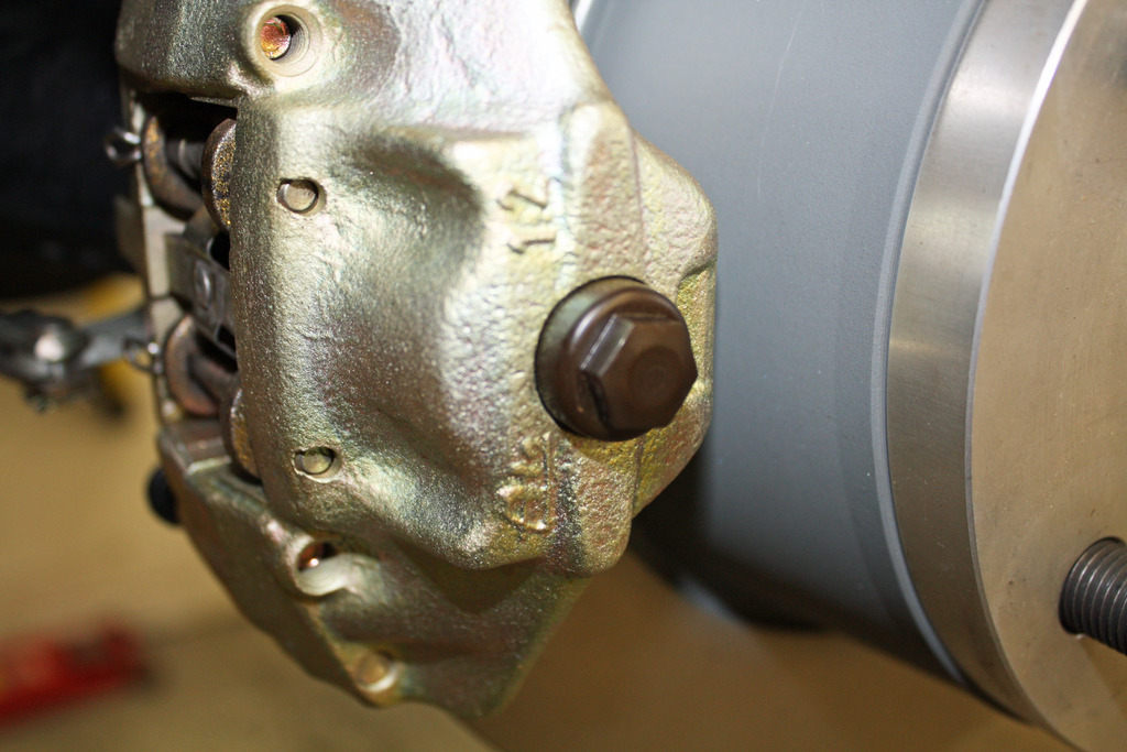

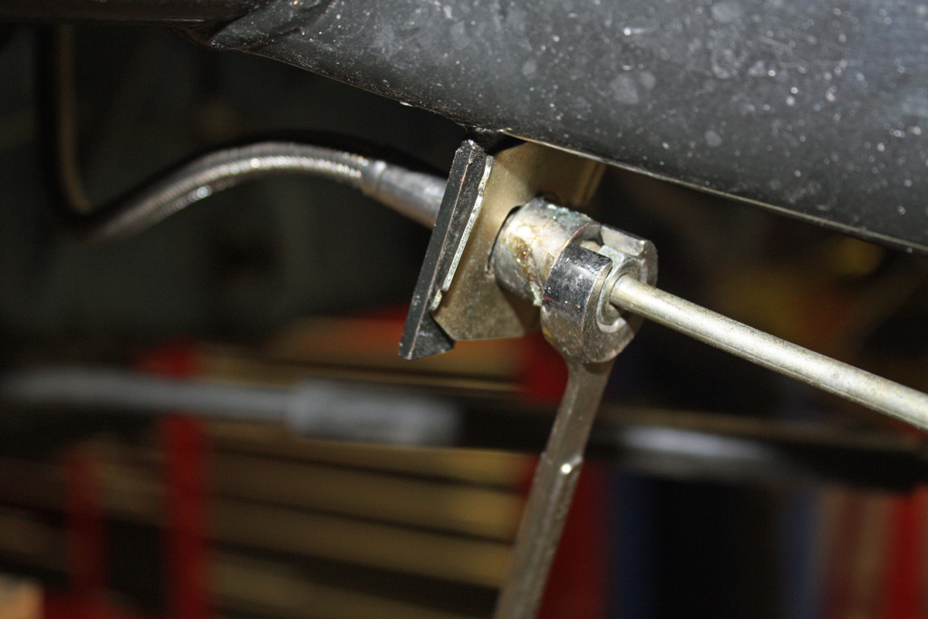

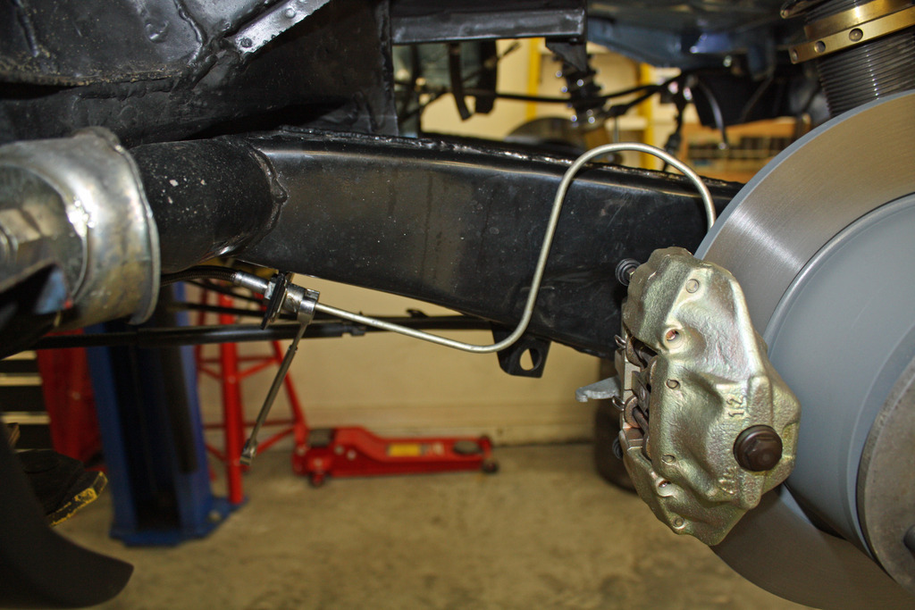

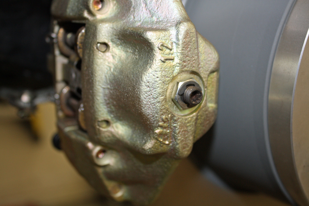

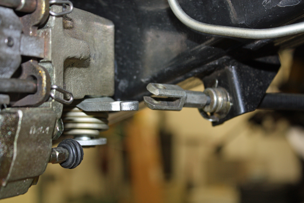

jerhofer   I finished up the rear brakes by installing the pa...   Jun 22 2018, 03:05 PM

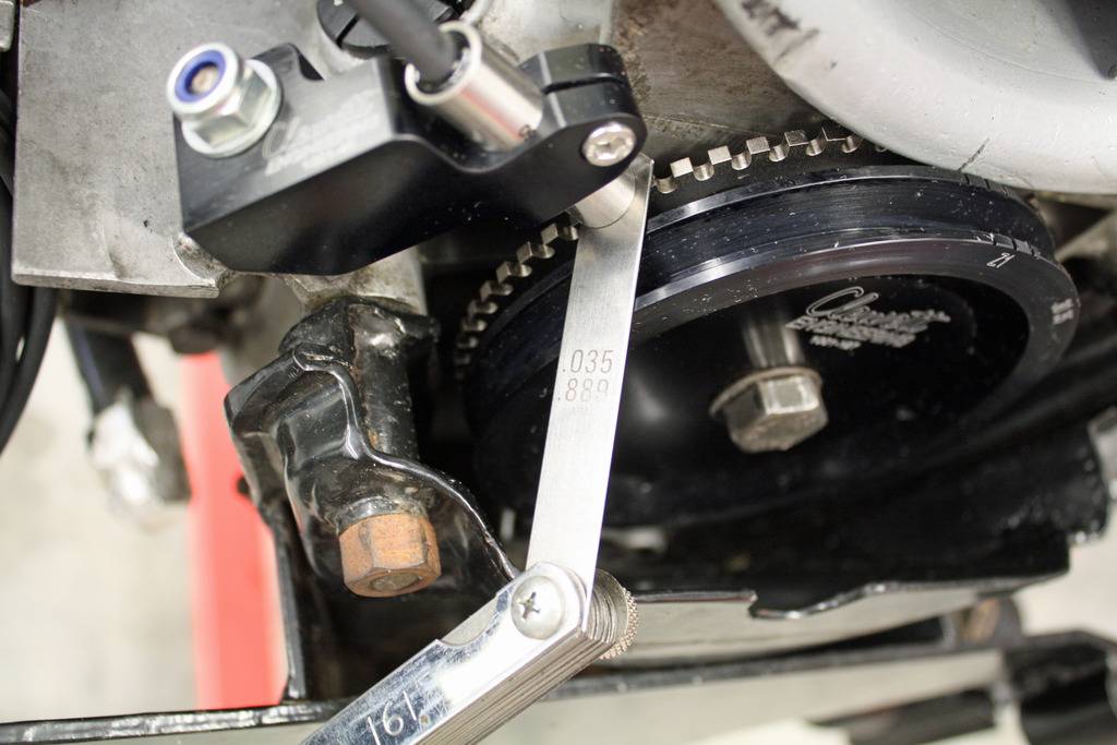

Dave_Darling   I very strongly recommend that you use 0.004...   Jun 25 2018, 06:23 PM
jerhofer   I [b]very strongly recommend that you use 0.004...   Jun 25 2018, 07:31 PM

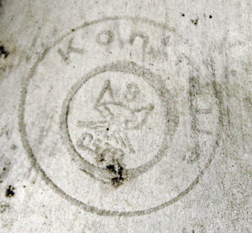

mepstein   The date is on the inner ridge between the pedals ...   Aug 11 2018, 04:30 PM
jerhofer   The date is on the inner ridge between the pedals...   Aug 11 2018, 07:52 PM

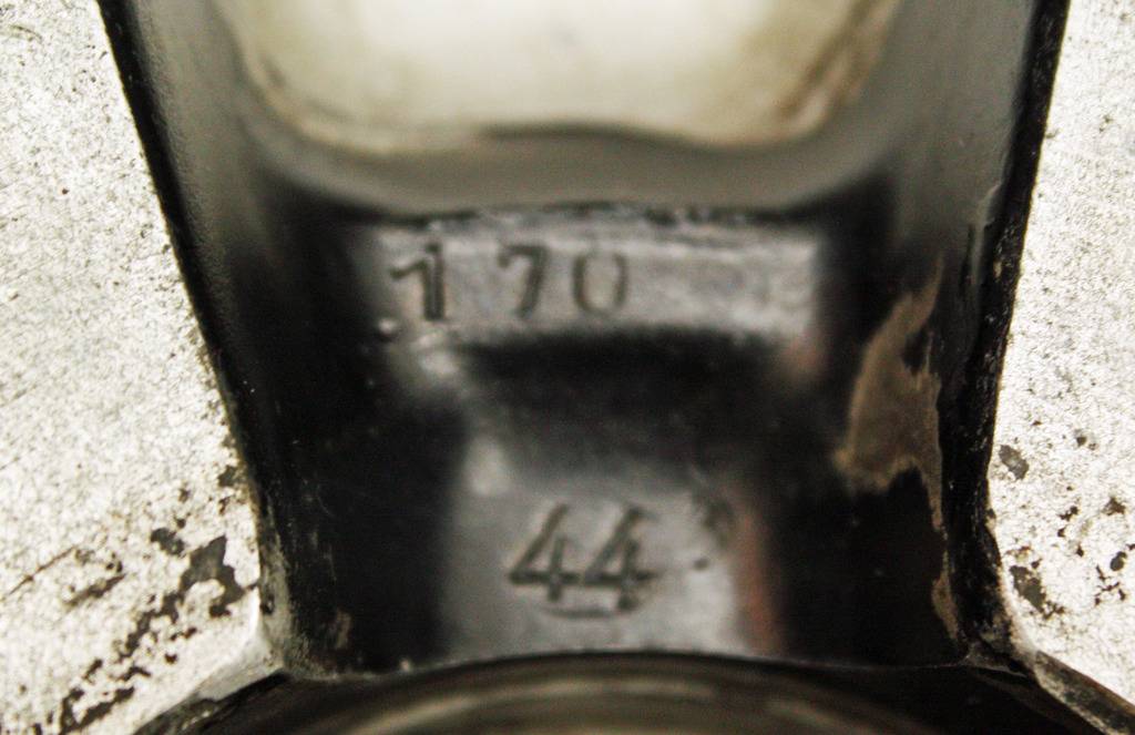

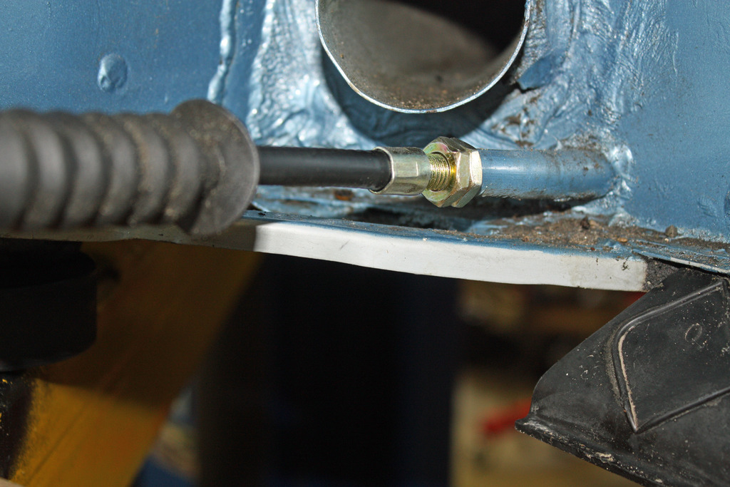

jerhofer   I haven't had much time to work on the car sin...   Aug 16 2018, 05:15 PM

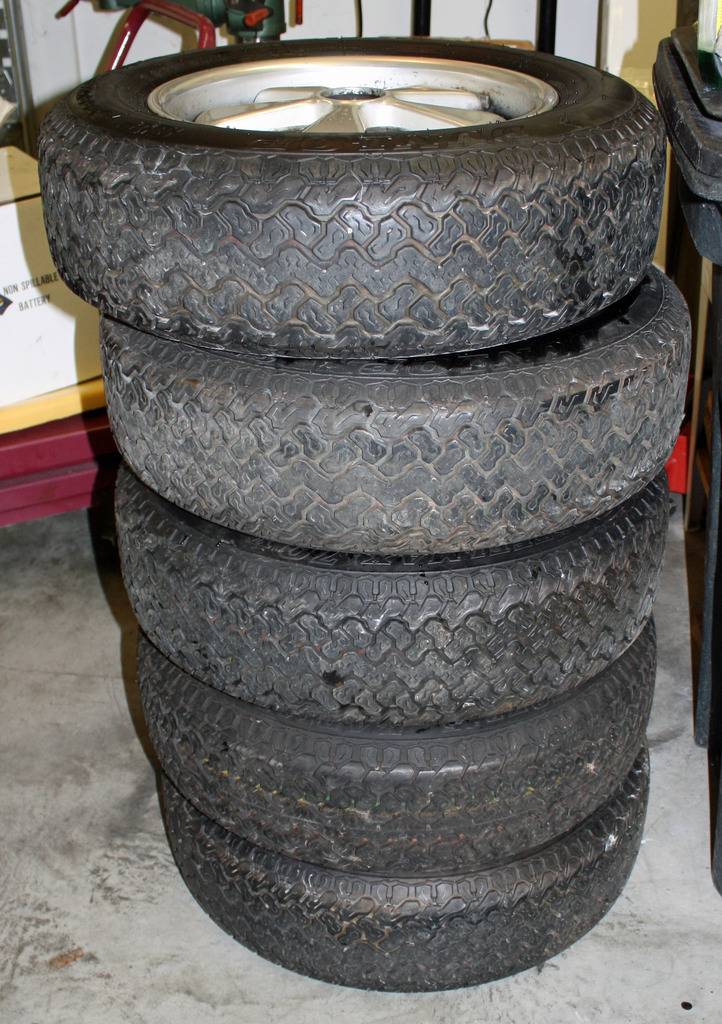

mepstein   Looks like the wheels sold quickly. :beer2:   Aug 18 2018, 12:14 PM
jerhofer   Looks like the wheels sold quickly. :beer2: A ...   Aug 18 2018, 12:25 PM

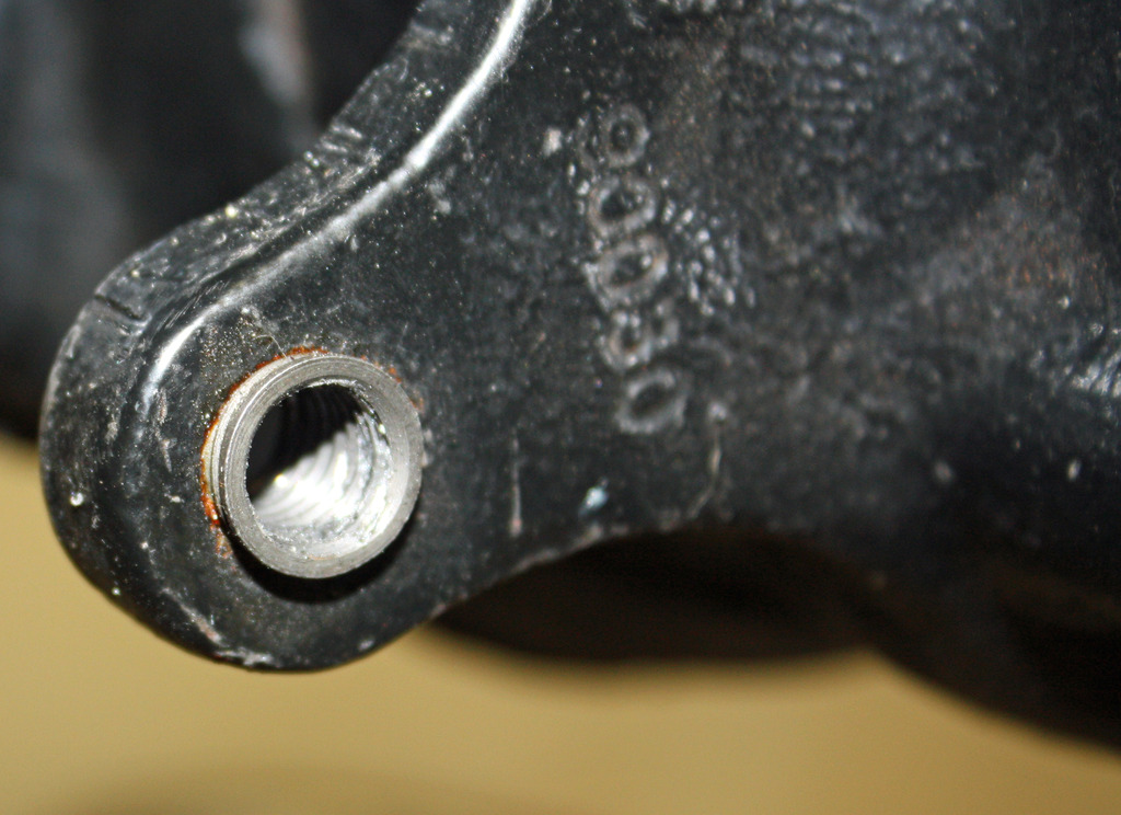

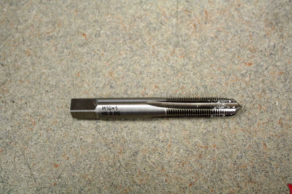

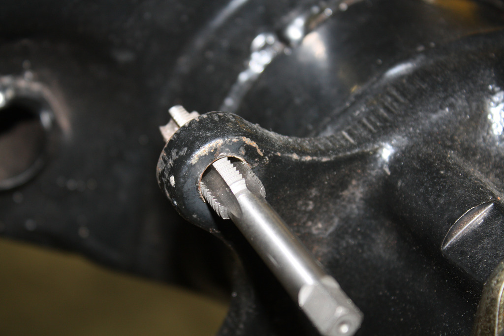

jerhofer   When removing the valve covers, one stud came out ...   Aug 29 2018, 02:45 PM
mepstein   On a lot of cars, the turbo covers need the outer ...   Aug 29 2018, 03:02 PM
jerhofer   On a lot of cars, the turbo covers need the outer...   Aug 29 2018, 04:48 PM

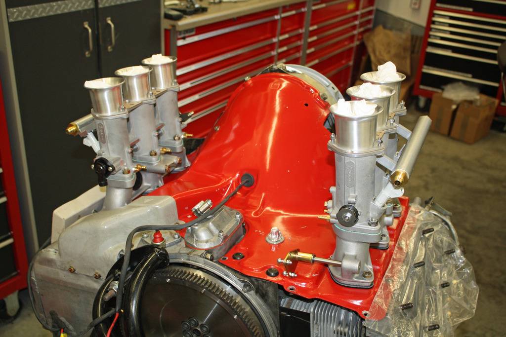

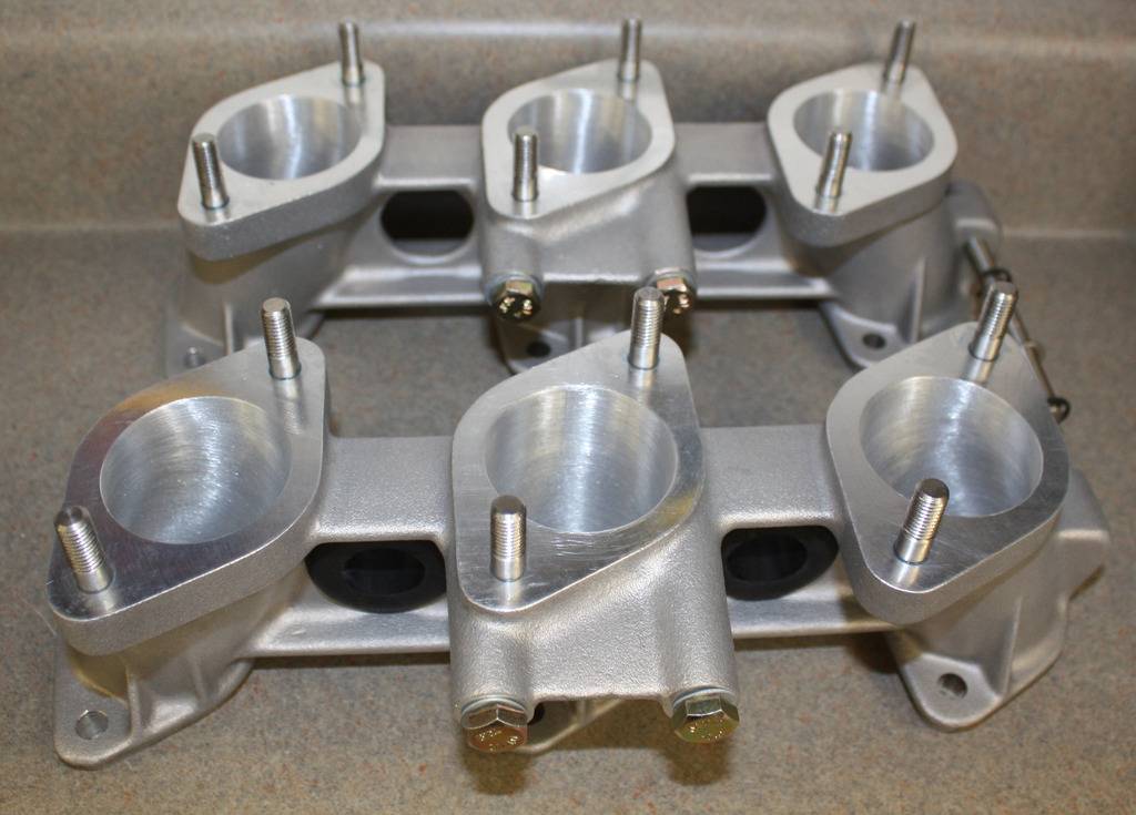

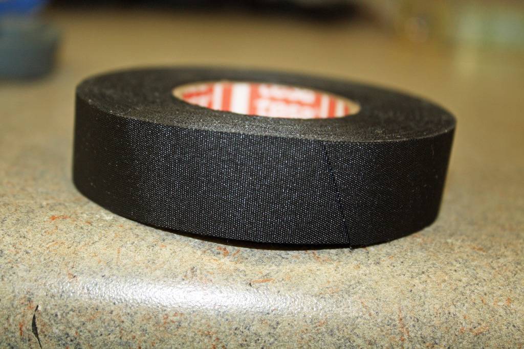

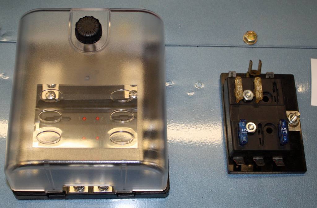

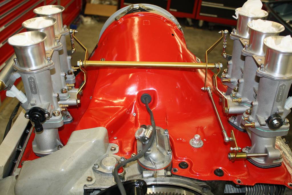

jerhofer   I worked all afternoon and accomplished quite a bi...   Aug 31 2018, 07:47 PM

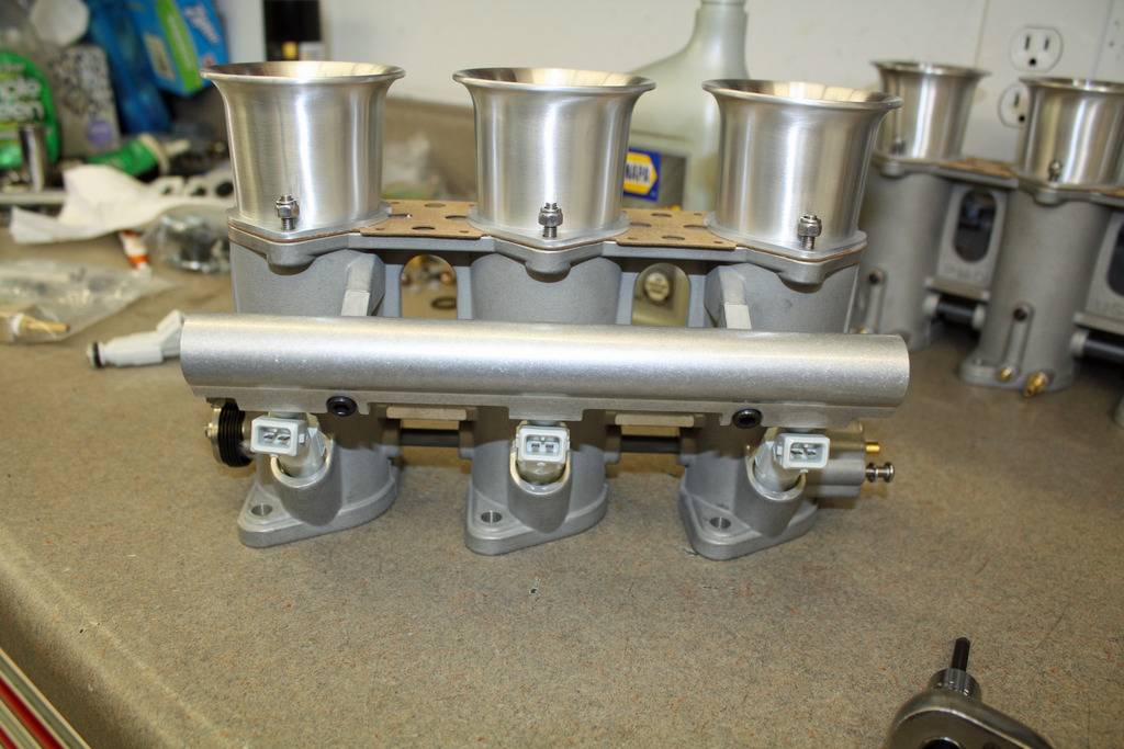

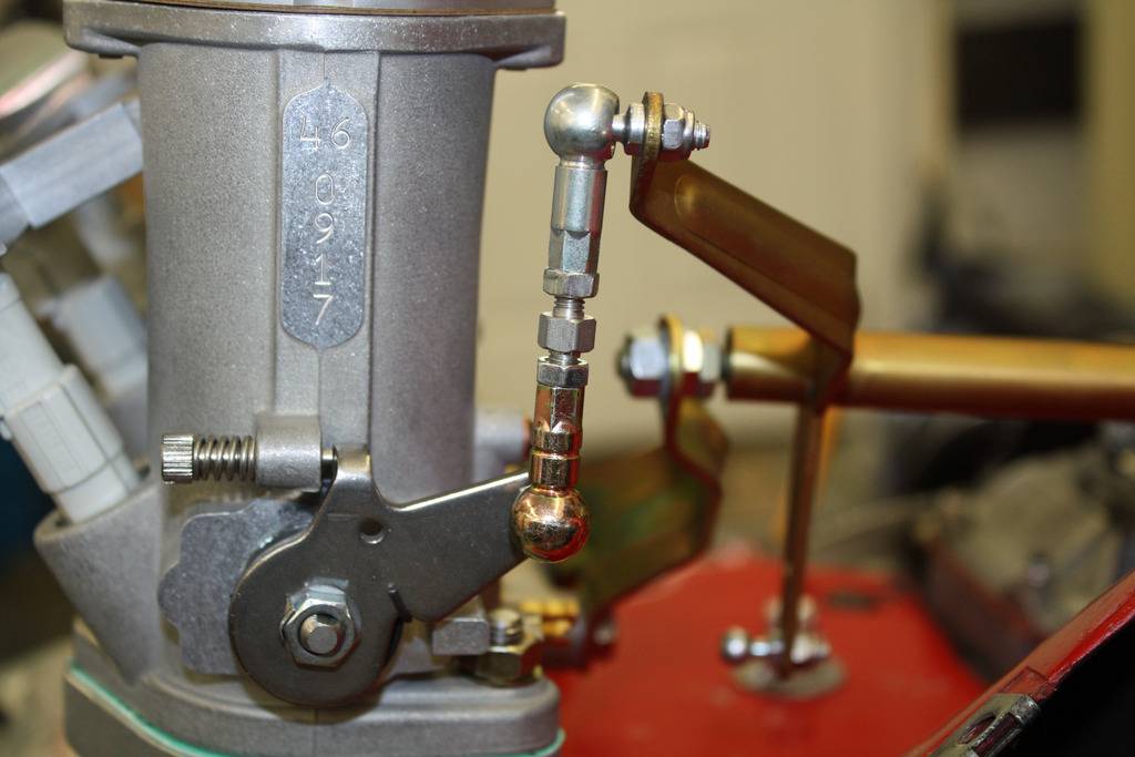

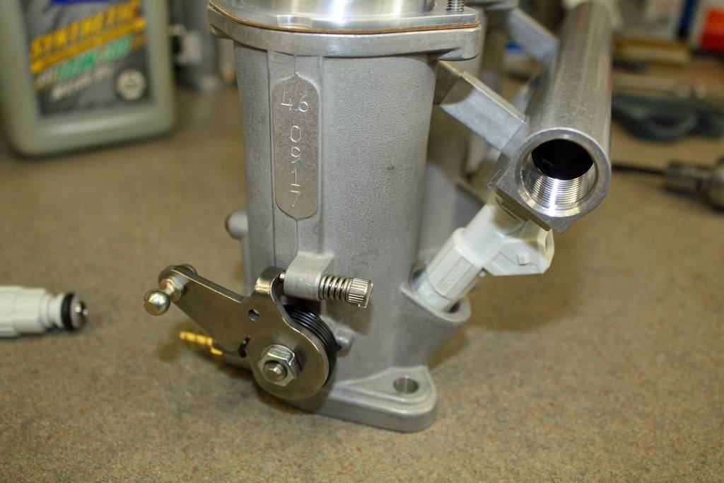

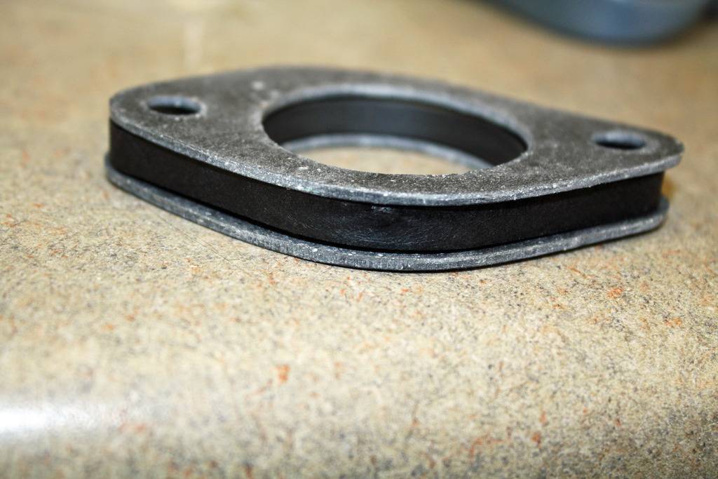

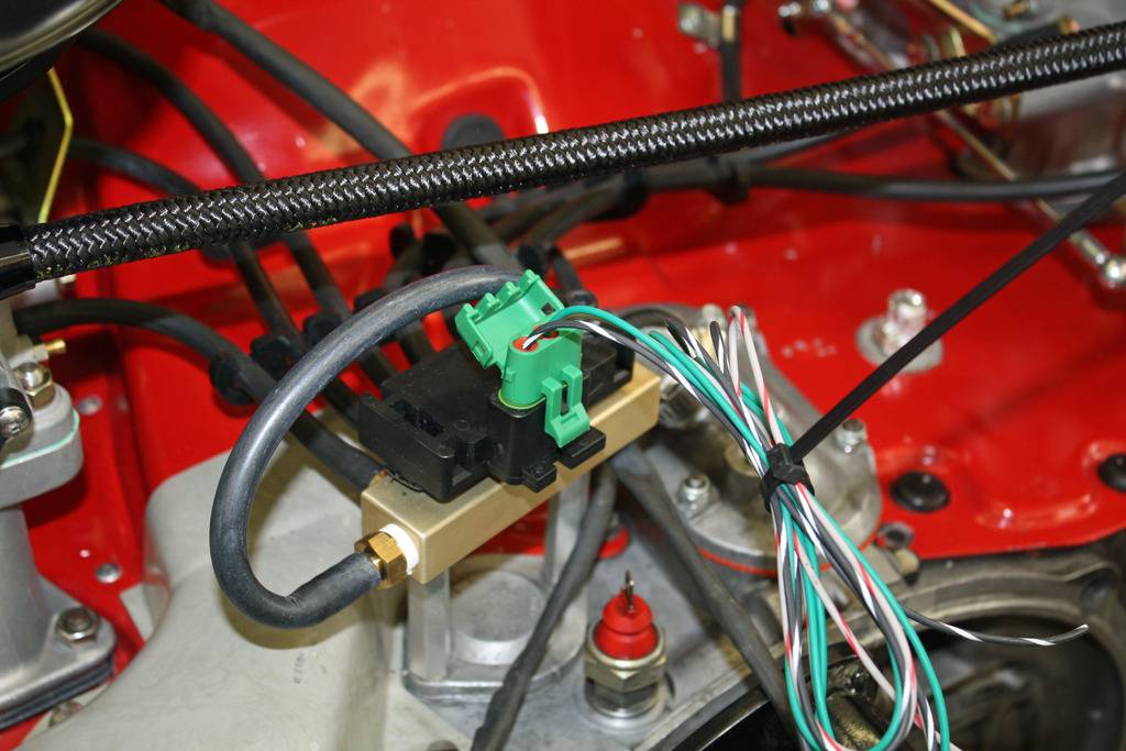

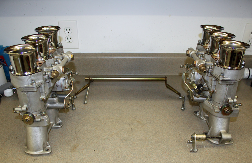

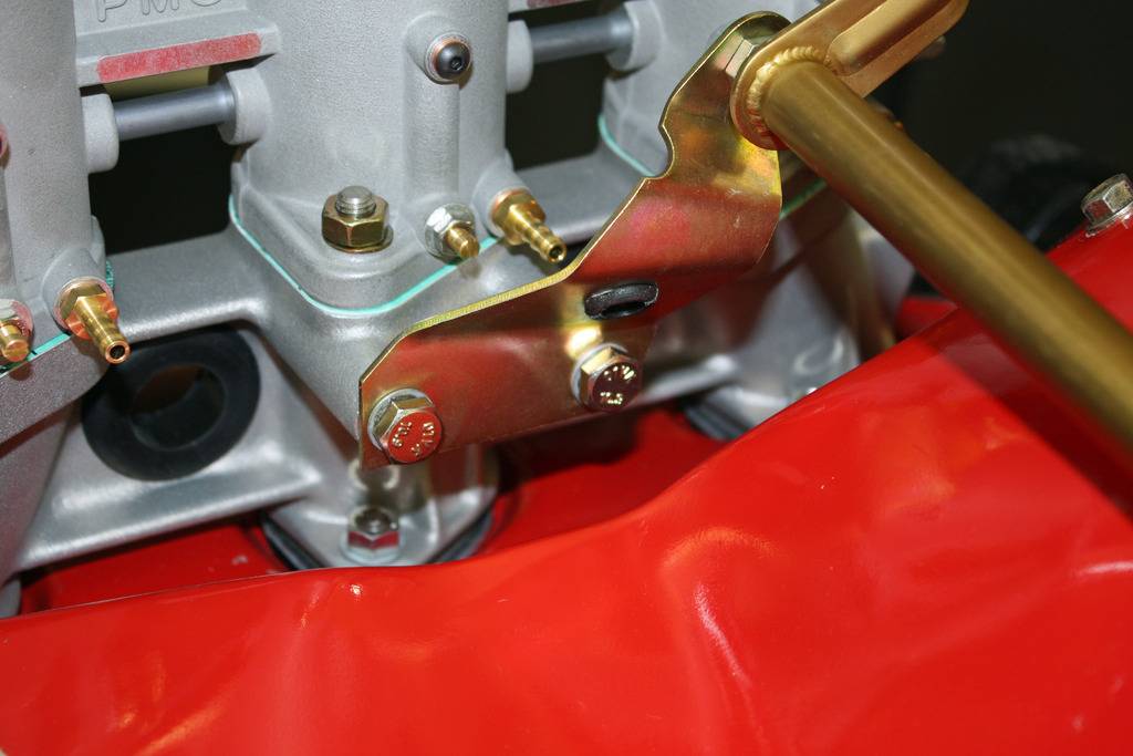

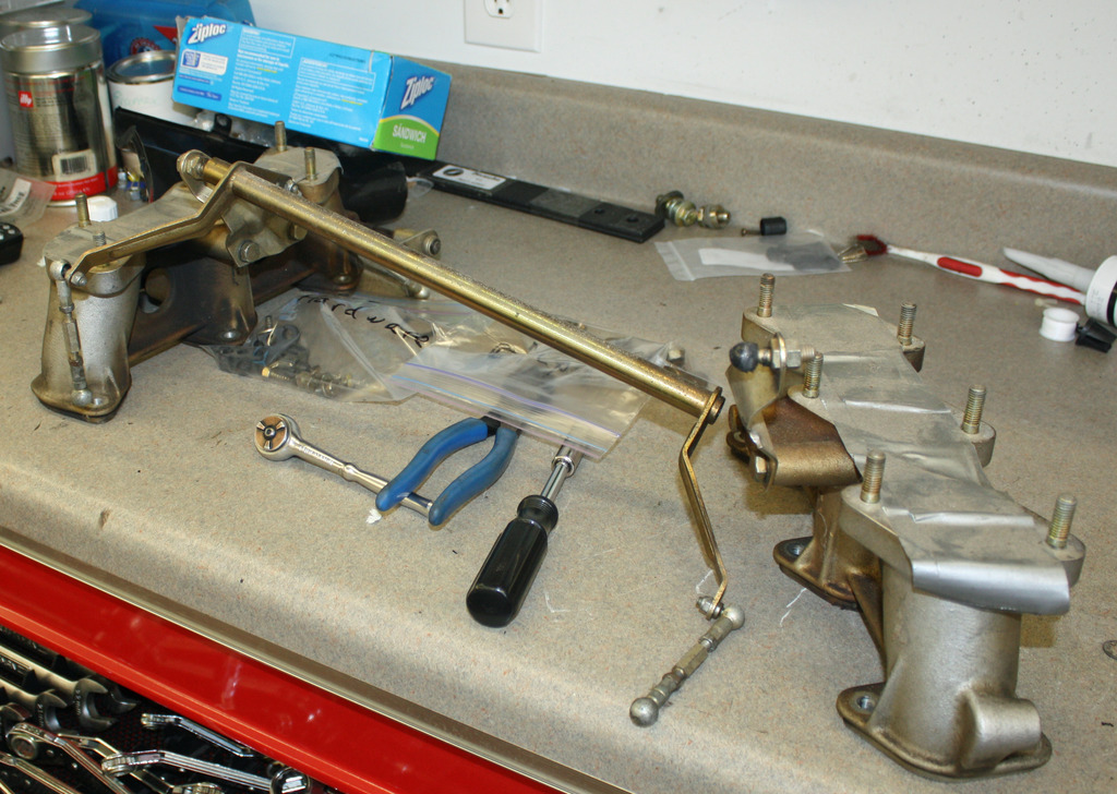

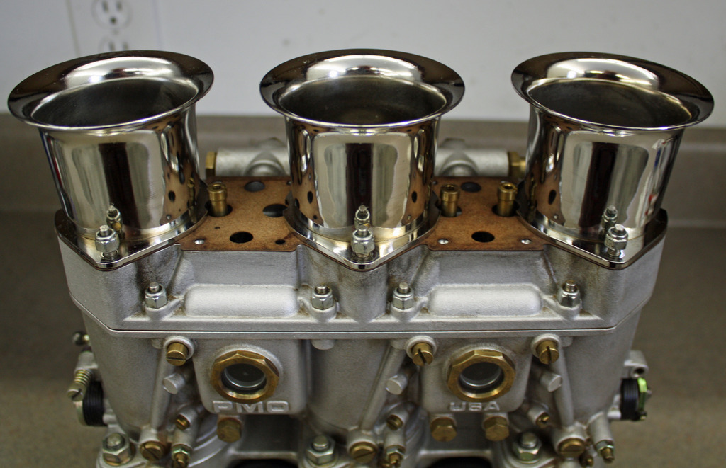

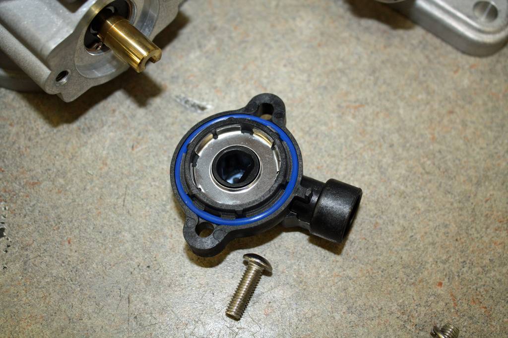

jerhofer   Now it was the throttle bodies turn. First up is ...   Aug 31 2018, 07:59 PM
914forme   Very nice work there. Making me reconsider the PM...   Sep 1 2018, 07:46 PM

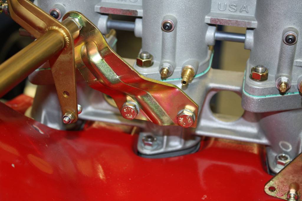

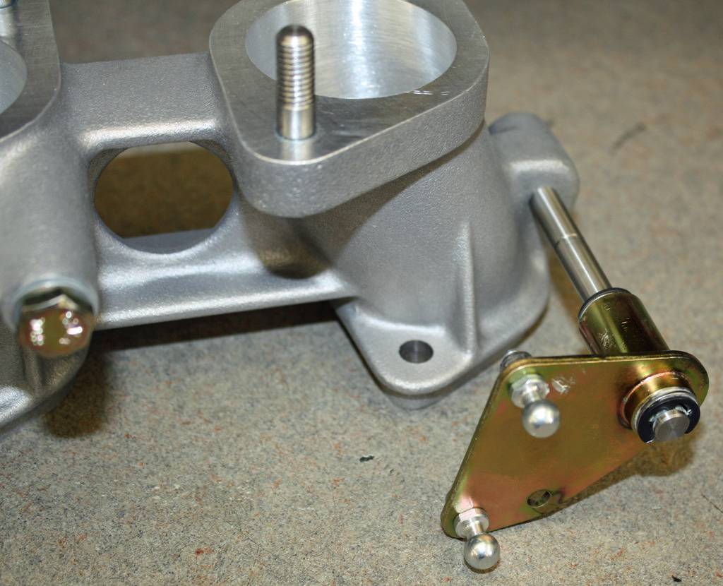

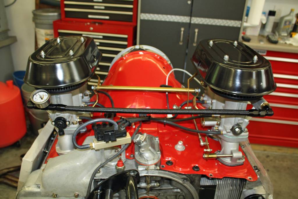

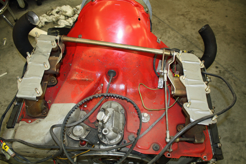

jerhofer   I finished up the linkage today. The left side ro...   Sep 3 2018, 04:13 PM

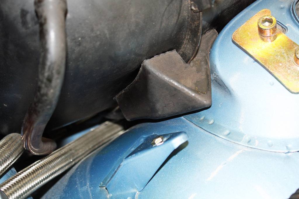

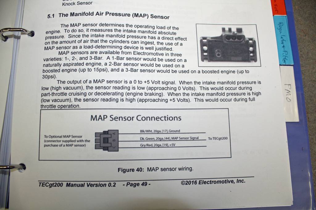

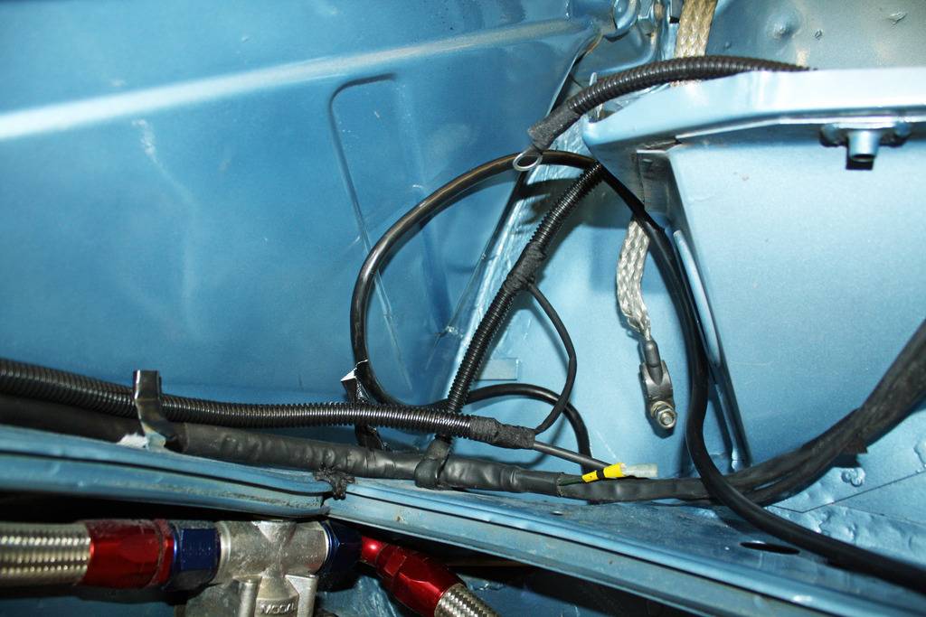

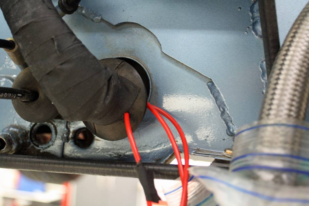

jerhofer   One more vacuum line needed to be run from the vac...   Sep 4 2018, 07:31 PM

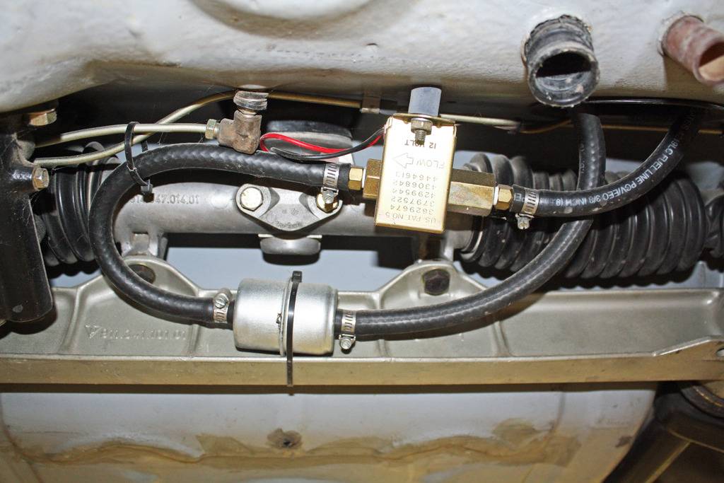

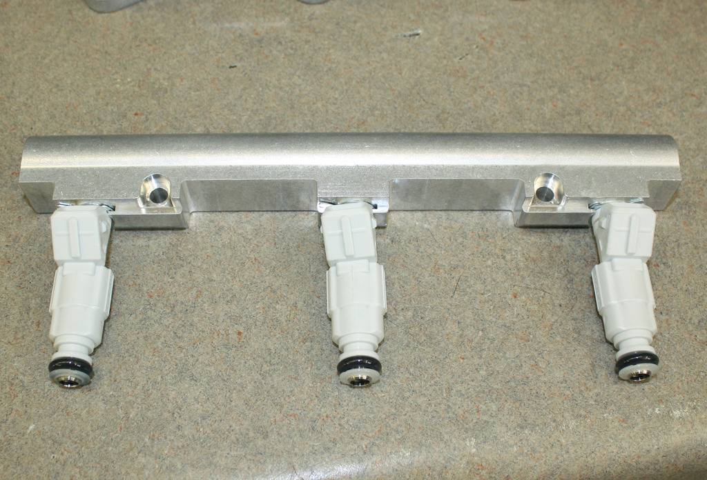

jerhofer   The instructions called for adding a second return...   Sep 4 2018, 08:13 PM

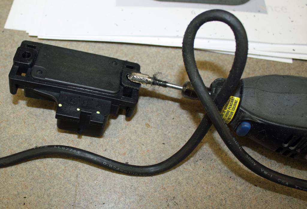

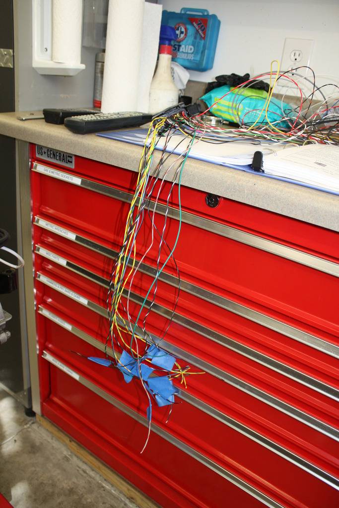

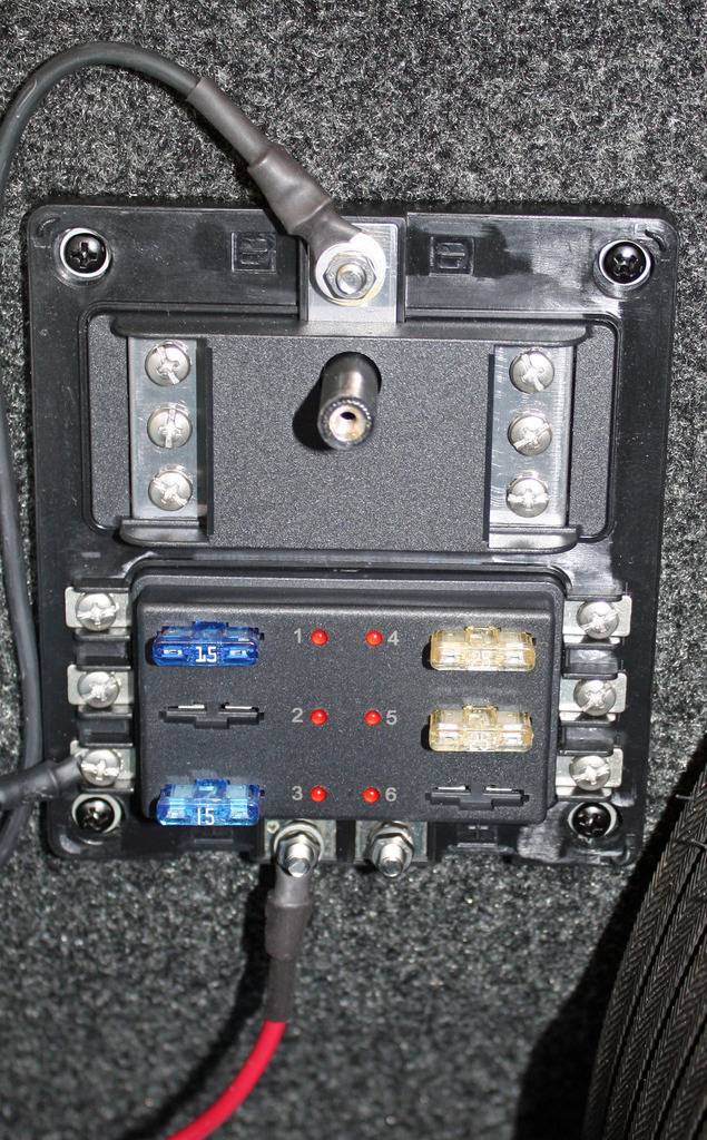

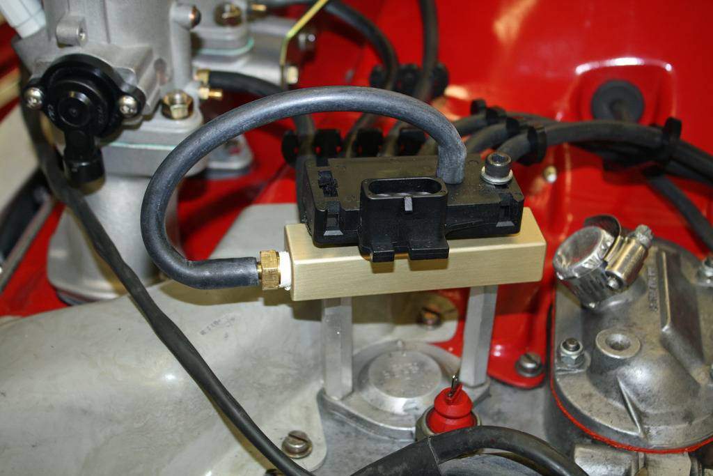

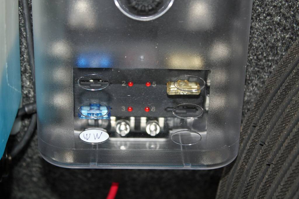

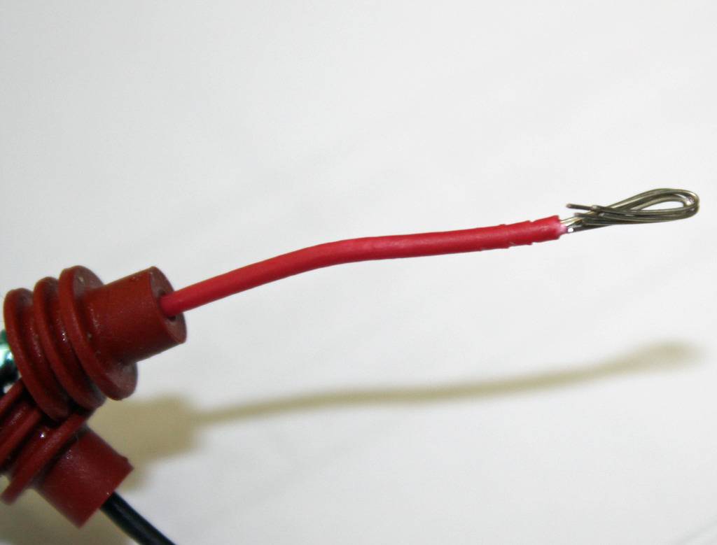

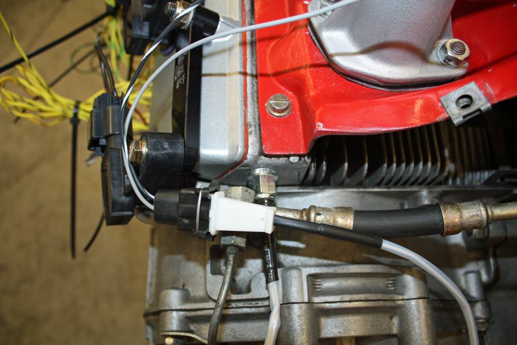

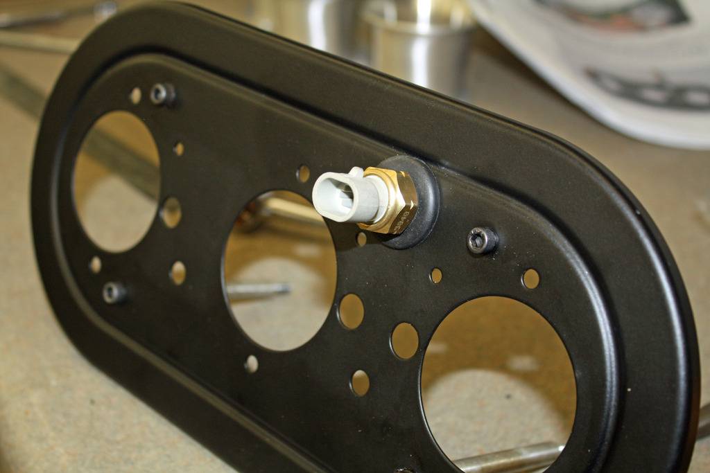

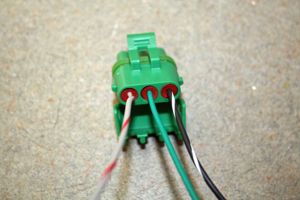

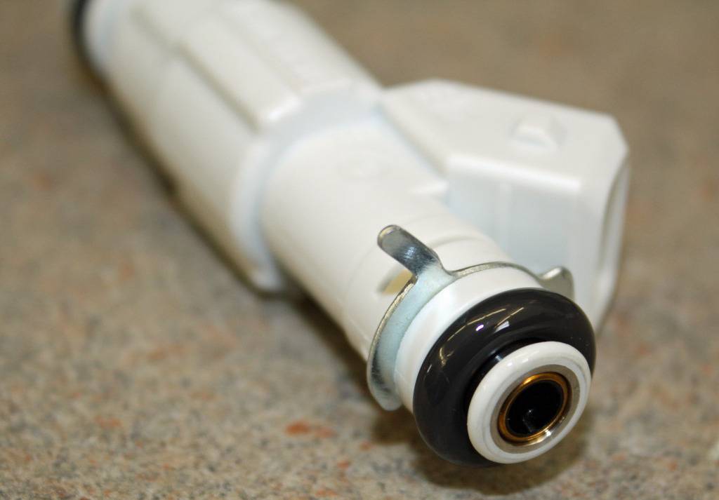

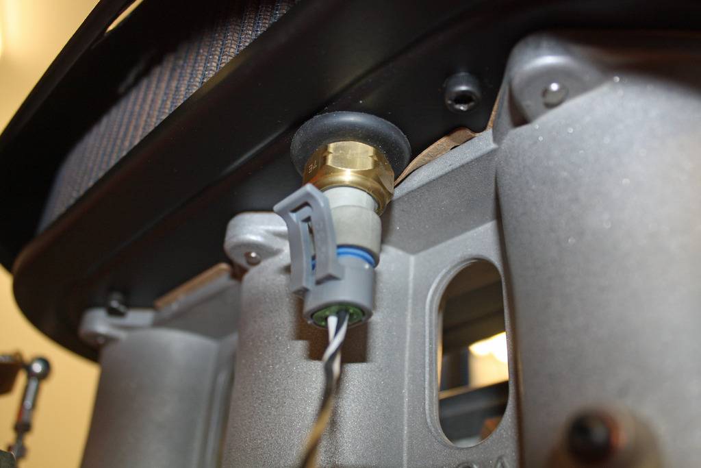

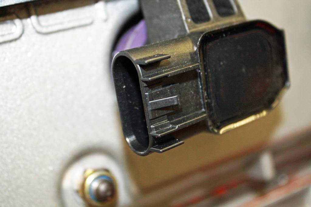

jerhofer   Another day, another sensor for the engine. This ...   Sep 6 2018, 01:51 PM

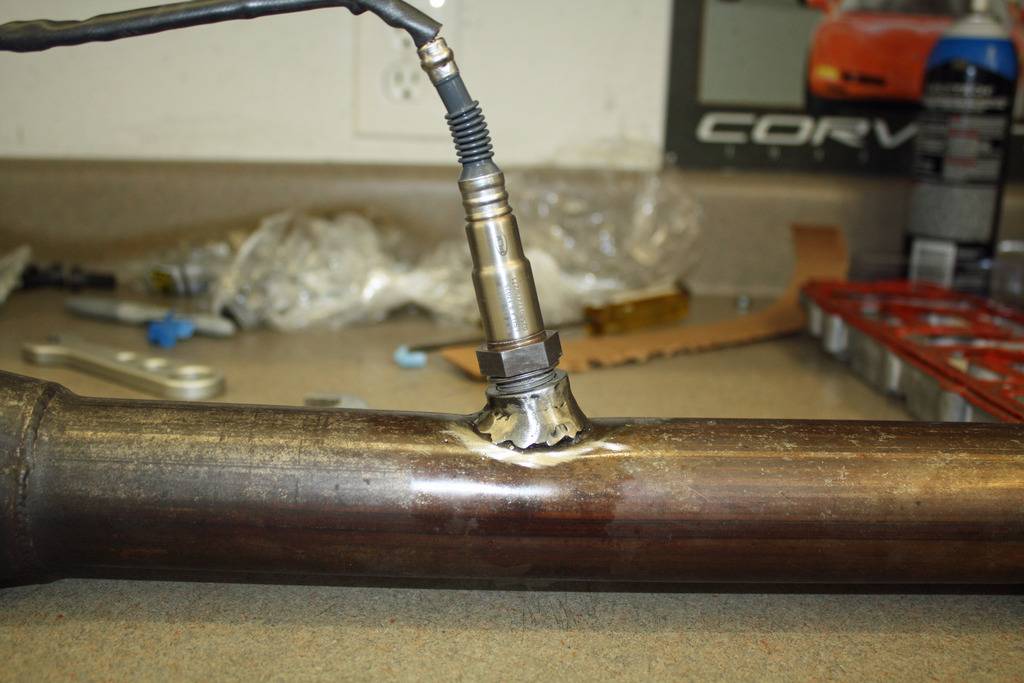

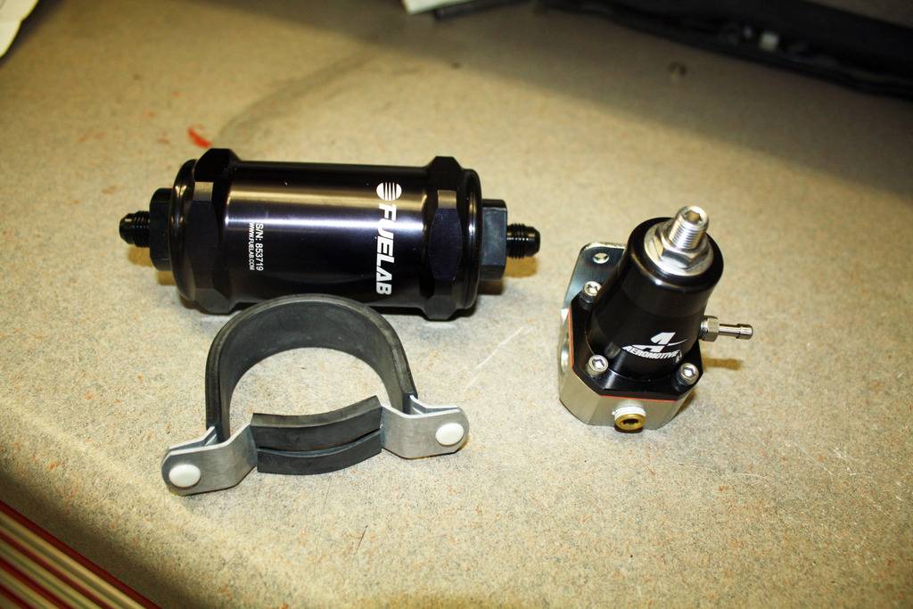

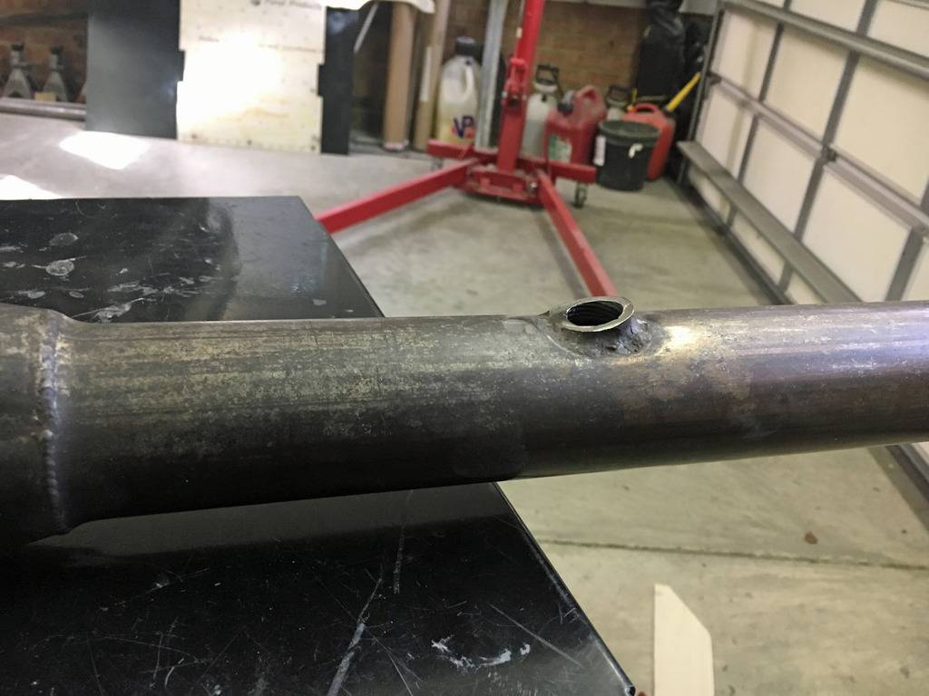

jerhofer   One last sensor!! A wide band O2 sensor h...   Sep 8 2018, 02:30 PM

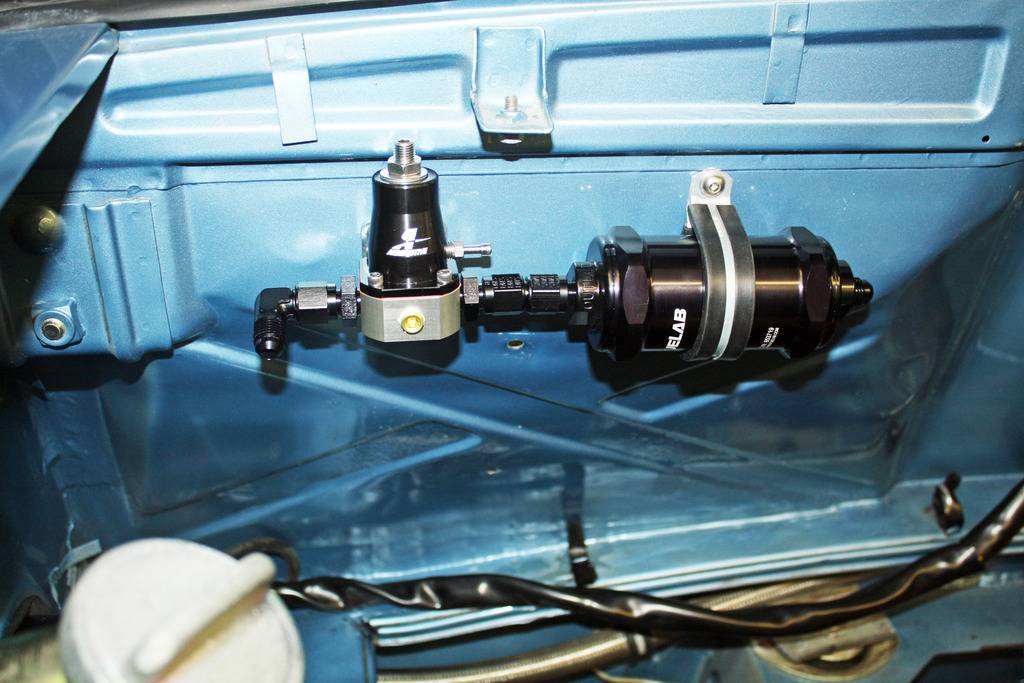

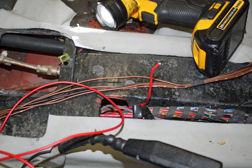

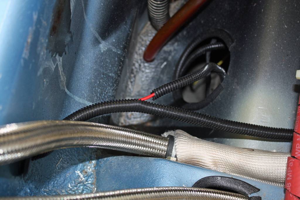

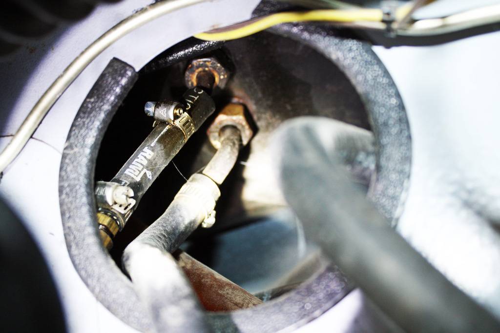

jerhofer   To prepare for running the fuel lines, I removed t...   Sep 8 2018, 04:17 PM
914forme   You can see them in the tunnel by opening up the r...   Sep 8 2018, 05:22 PM
jerhofer   You can see them in the tunnel by opening up the ...   Sep 8 2018, 07:36 PM

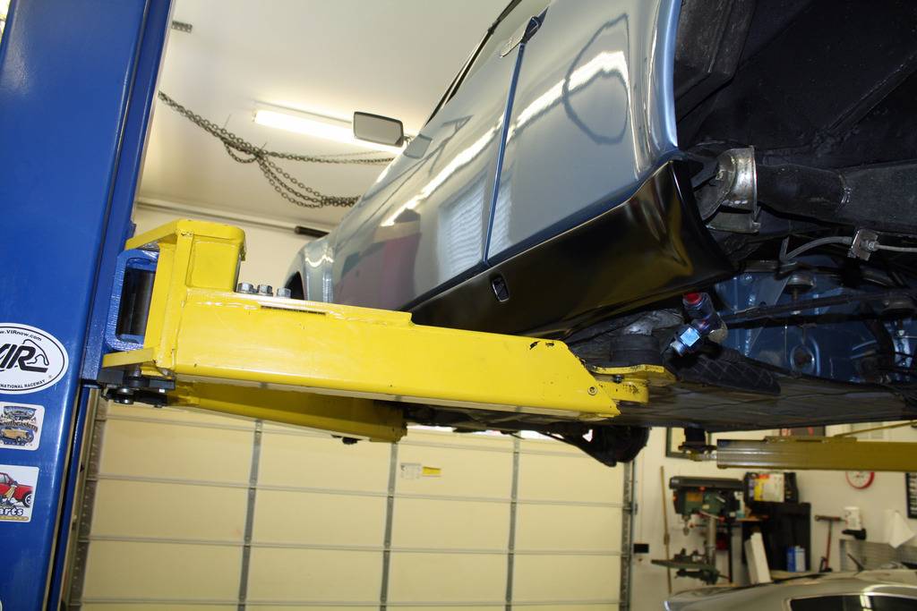

jerhofer   I pulled the fuel tank this morning. First up was...   Sep 10 2018, 02:43 PM
