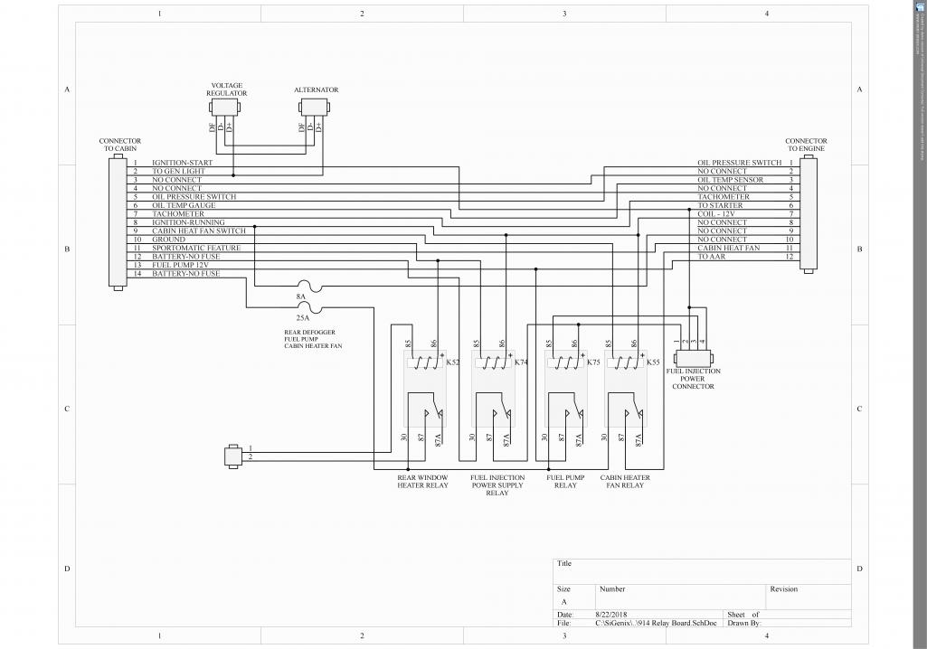

While you have the relay board out, measure the resistance between the D+ to D+, DF to DF to Pin 2 of the cabin connector, and D- to D-.
You can see by the schematic below that the relay board doesn't do too much for the alternator except provide a place to mount the voltage regulator and provide a wire back to the dash for the GEN light.
You shouldn't be killing alternators that easily. Check all grounds and the transmission strap. When you had your engine out you didn't paint or powder coat the fan shroud? The alternator is grounded to the shroud and the only direct ground connection to the engine case are the 4 little studs attaching the shroud to the engine. The tin might also provide some grounding but it's really those little studs providing the most grounding.

I did in fact powder coat the shroud and tins. That could be it.
I’ll run a ground wire from the alternator bolt to the engine case.
My other grounds are all golden. Trans, battery, and wire harness all made solid connections. I did not know about how the alternator grounded though.
