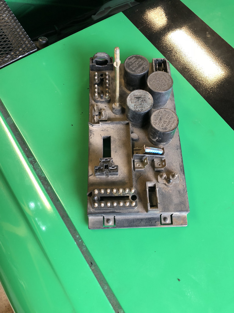

Well, the new solid state VR did nothing.
I am forced to admit the issue MUST be with the board.
(IMG:http://www.914world.com/bbs2/uploads_offsite/c2.staticflickr.com-1435-1534977902.1.jpg)
Though it is probably folly, I am going to attempt to rehab the board. I have a feeling this board has been the death of 2 alternators and probably other gremlins that have plagued me and McMark and the others who have helped withthis car over the years.
When I took the board off there was already evidence of a previous "repair" where someone had taken the potting off around the VR plug and soldered something down. I'm going to clear all the potting and start from new.
Because I'm stubborn. And I want to drive my car maybe this weekend.
Its frustrating as the car seems to be charging at idle. I had a meter on the battery for about 15 minutes and the battery went from 12.25 volts at start to 12.54 volts after a few minutes.
But as SOON as the engine revved to about 3000rpm, the battery fell to 12.01 and bounced around on the meter.
If I can't find an issue on the board by Friday, I'll suck it up and put up a post for a new board.

If you need another board, just pm me your address. I have a good one you can have $n/c. If I send tomorrow, you should receive Saturday.

QUOTE(mepstein @ Aug 22 2018, 10:33 PM) *
Mark. Yes please! Pm sent.
