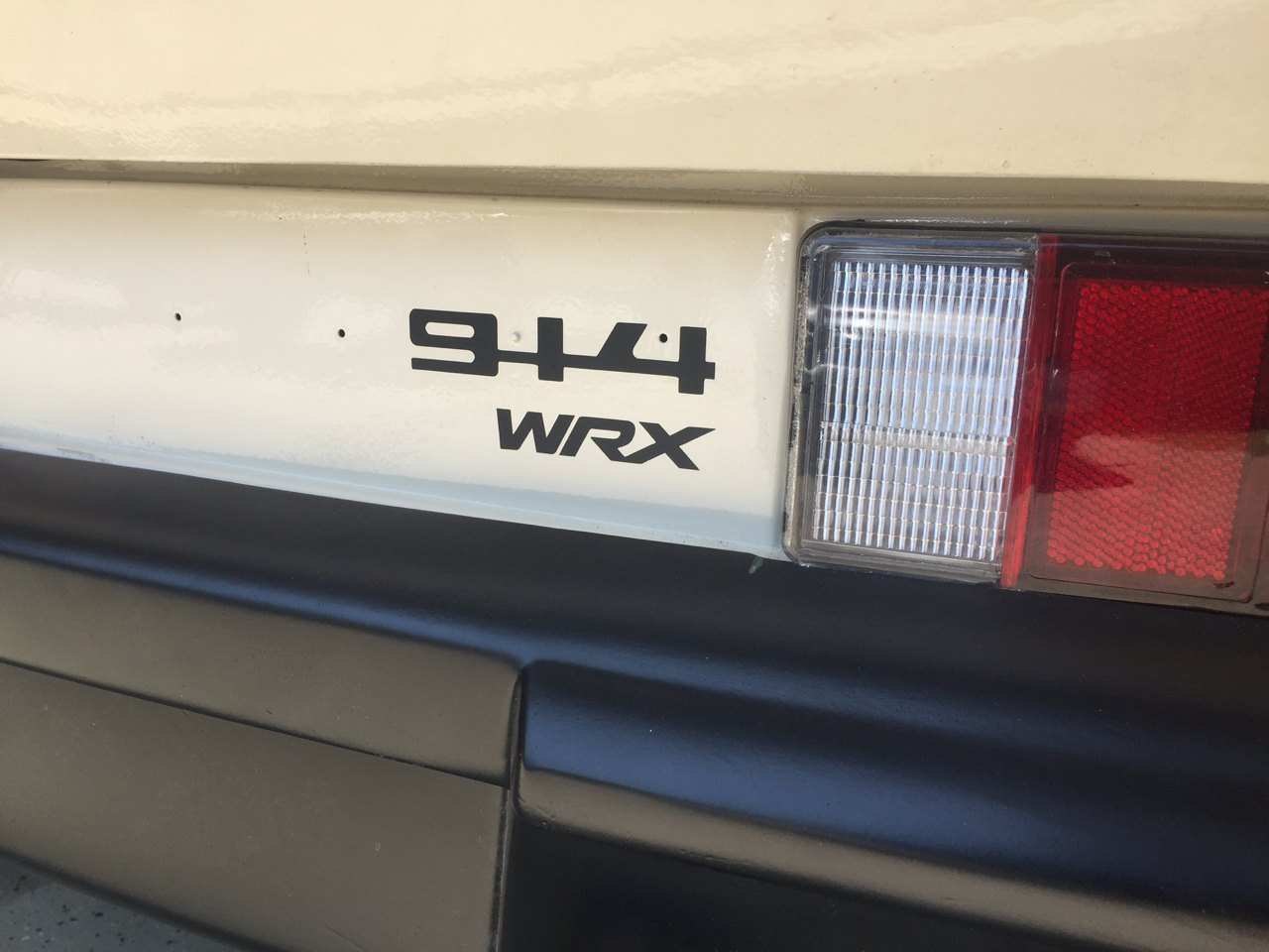

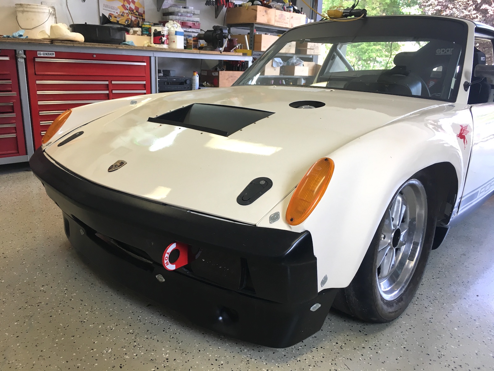

Made a few changes recently:
• Added a front tow-hook
• Blacked out the front trim
• Installed a glass windshield, blacked the trim
• Added some badge stickers
• Finished up lighting wiring: front and rear illumination bulbs are working
The car is ready to drive and I've done some testing around the neighborhood, but its short and quick stuff until I can get it plated. Im working with the DMV right now to get a title but it'll take about 90 days, fingers crossed it gets solved without a hitch. Im ready to shake down the car, but Id rather do it on the streets near my house instead of on a far-away race track, so Im going to wait for the plates before hammering on it. Im sad that the car won't see track time this year but, well, thats life.
