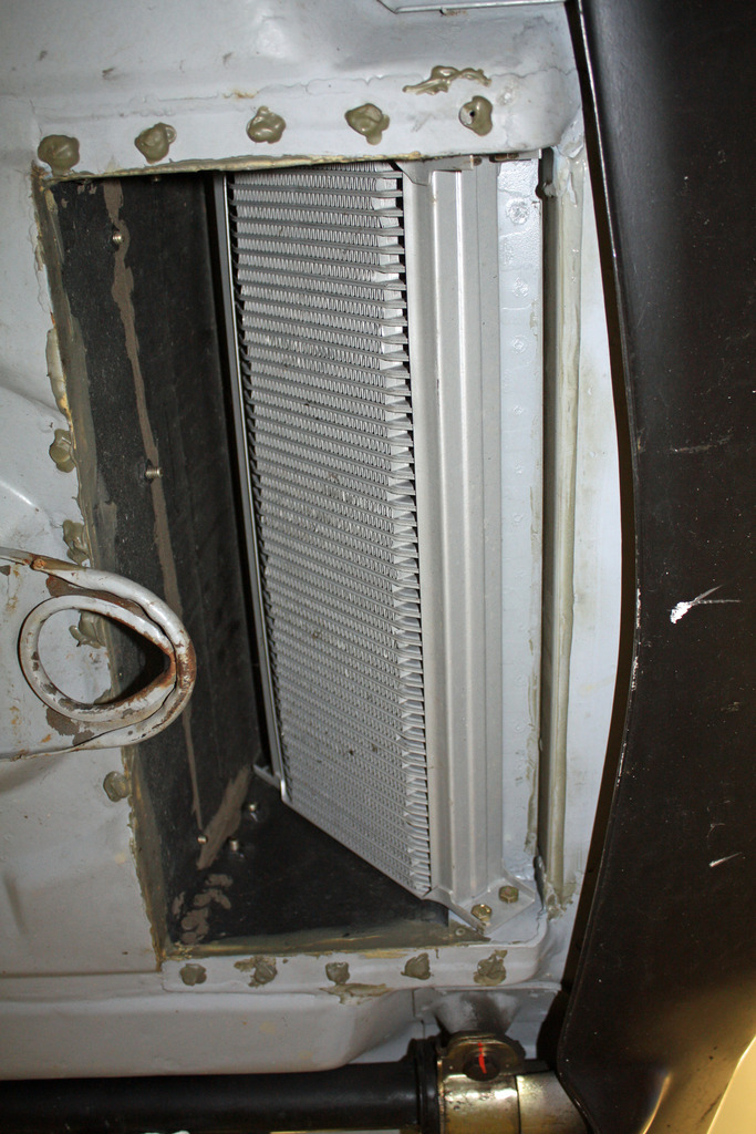

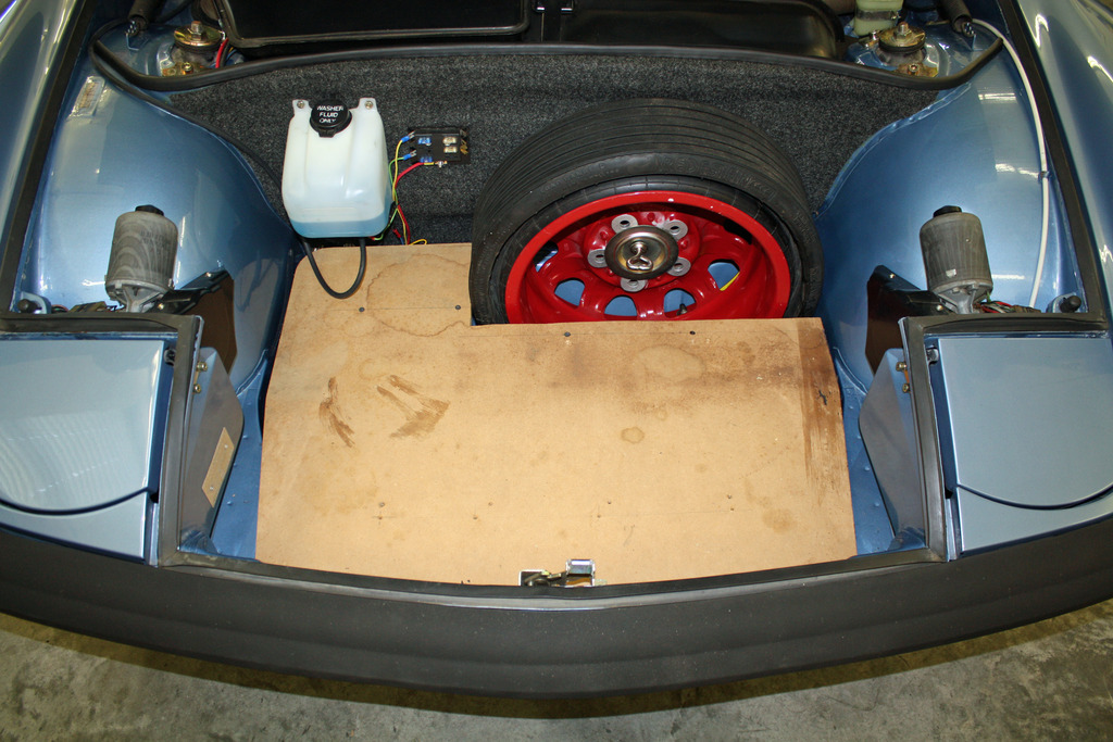

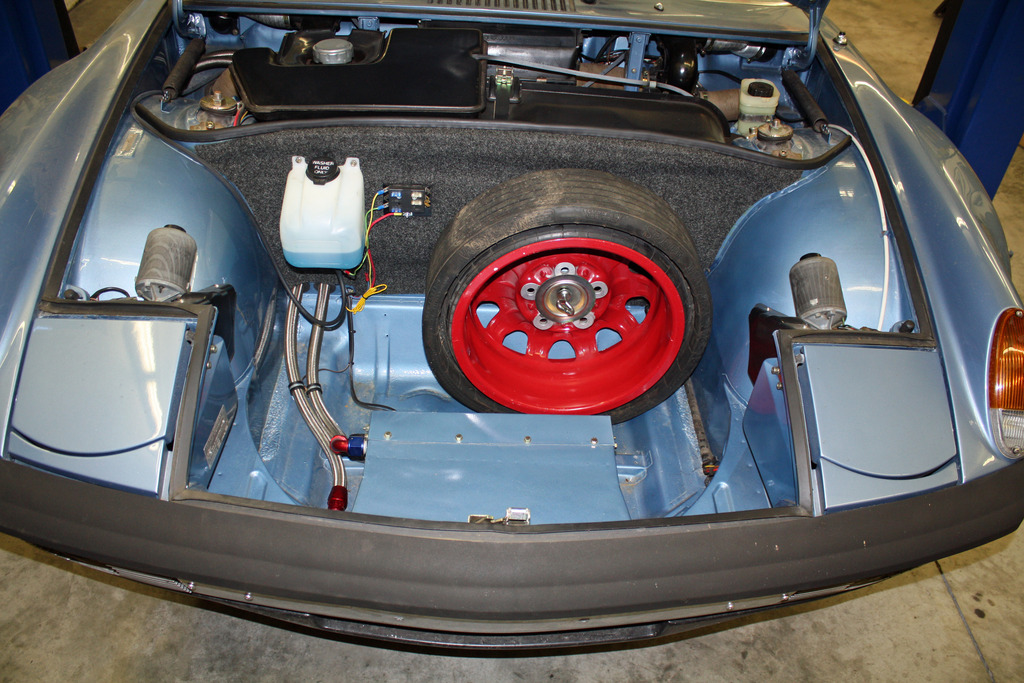

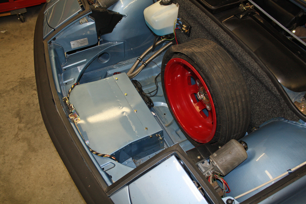

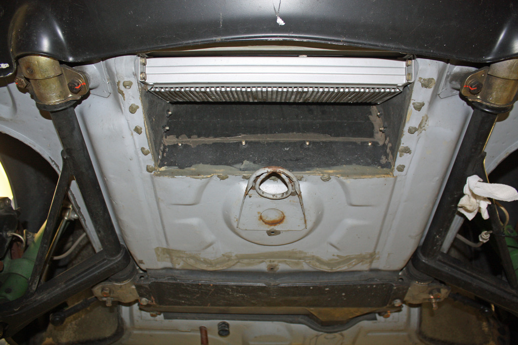

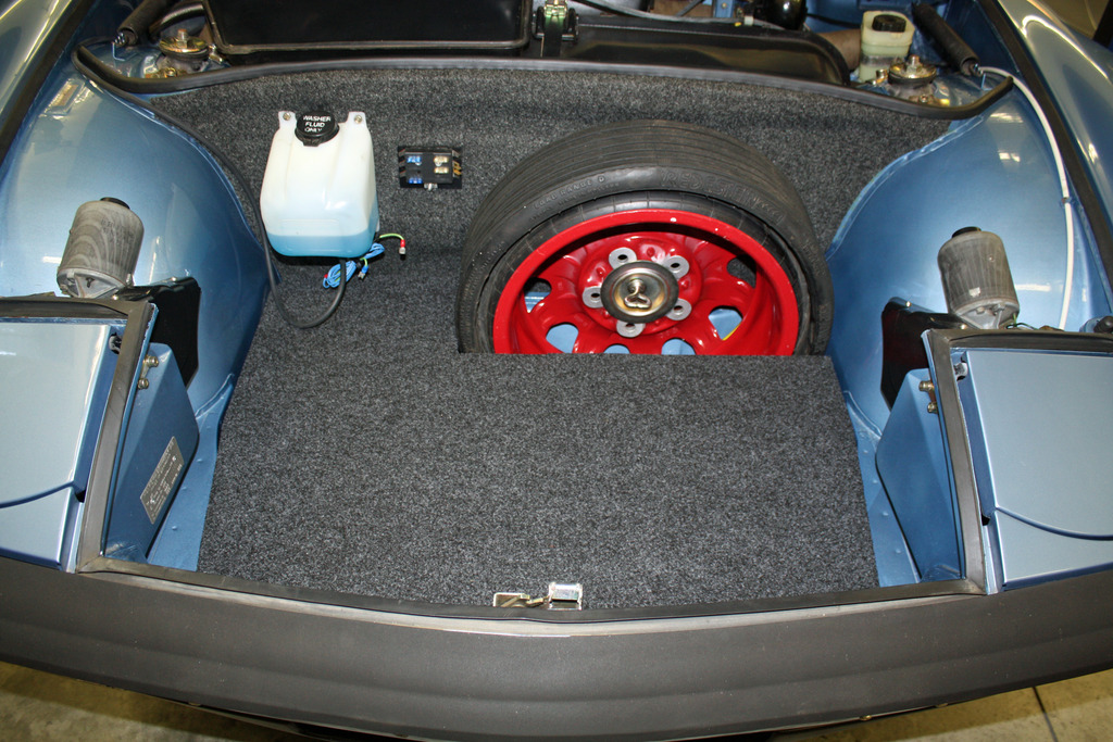

While John was building the motor at Perry's shop, Perry built a box in the front trunk for the oil cooler. Brad Mayeur built the 901 tranny with a Quaife differential. Since John was moving to Texas, he had the interior done in a light gray so it would be cooler as AC was not in the plans.

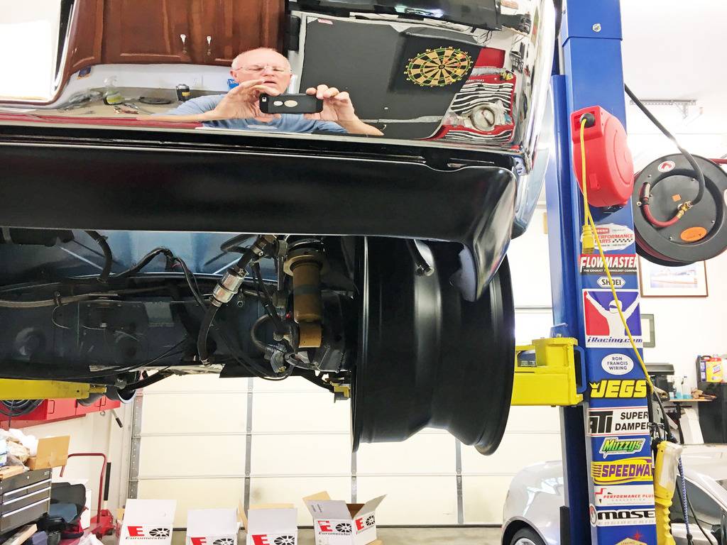

Now the car is in my garage, the parts have been stowed and I am ready to put it back together.

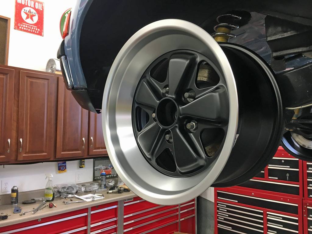

Charlotte has a Cars and Coffee every first Saturday. It is open to anyone who wants to attend and usually attracts at least 500 cars. Every third Sunday, Cars and Cappuccino happens. This is for European cars only and is by invitation. There were a couple McLaren 720S and a couple Ferrari's among the Porsche's and other makes.

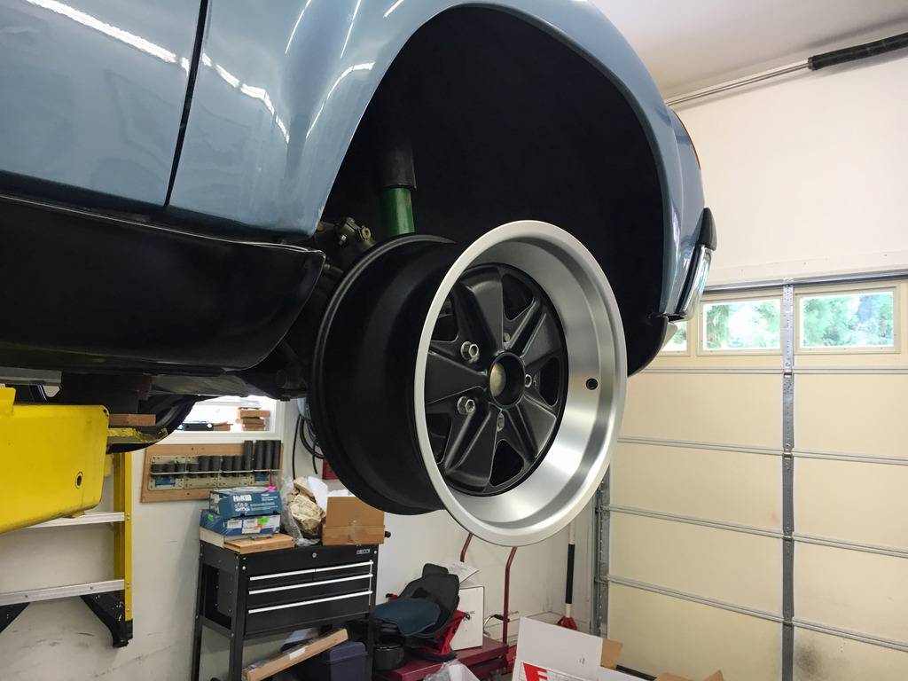

One person there had a Euro 911 with Fuchs wheels. Since I was looking for wheels for the 914 I asked him if they were replicas. They were and I would have known that had I looked at the tire size. They were 17" Euromeister's. I had been considering these wheels and I quickly asked him if he was happy with them and did they balance well. The answer was yes to both questions. A little later another gentleman arrived with the same wheel package and was equally positive.
These wheels occasionally go on sale for very special pricing by Automotion. While i was waiting for the sale price, I began to consider what sizes I wanted to order. While the 17's looked great on both of those 911's, I wondered about the thin sidewall of a 17" tire. I finally decided to compromise and go with the 16" wheels, 8's in front and 9's in the rear. They arrived yesterday afternoon and today I mounted the wheels, sans tires, to see if there were any clearance issues. All seemed well so I called Tire Rack and ordered tires.
(IMG:http://www.914world.com/bbs2/uploads_offsite/i188.photobucket.com-22140-1535660766.3.jpg)
(IMG:http://www.914world.com/bbs2/uploads_offsite/i188.photobucket.com-22140-1535660766.4.jpg)
(IMG:http://www.914world.com/bbs2/uploads_offsite/i188.photobucket.com-22140-1535660767.5.jpg)
(IMG:http://www.914world.com/bbs2/uploads_offsite/i188.photobucket.com-22140-1535660767.6.jpg)
(IMG:http://www.914world.com/bbs2/uploads_offsite/i188.photobucket.com-22140-1535660767.7.jpg)
For tires I decided on 225/50's front and 245/50's rear. There were about ten options that offered a tire in both sizes. After reading Tire Rack's reviews, I called them to ask about the GENERAL G-MAX RS SL. This is a summer tire. The gentleman at Tire Rack said they had been very impressed with this tire's performance in their testing. General is now owned by Continental which may explain why they did well. A couple years ago I bought a set of General high performance all season tires for my Audi Allroad and was very pleased with them. I ordered the G-Max's and they should arrive at the installer tomorrow.

jerhofer   Perry built in an oil cooler box in the front trun...   Jun 17 2018, 12:07 PM

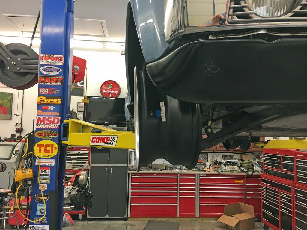

jerhofer   Ed was going to run 13" wheels on the car to ...   Jun 17 2018, 12:22 PM

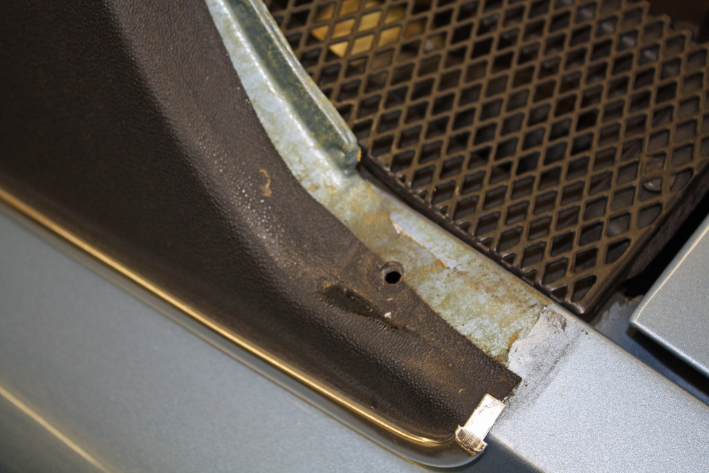

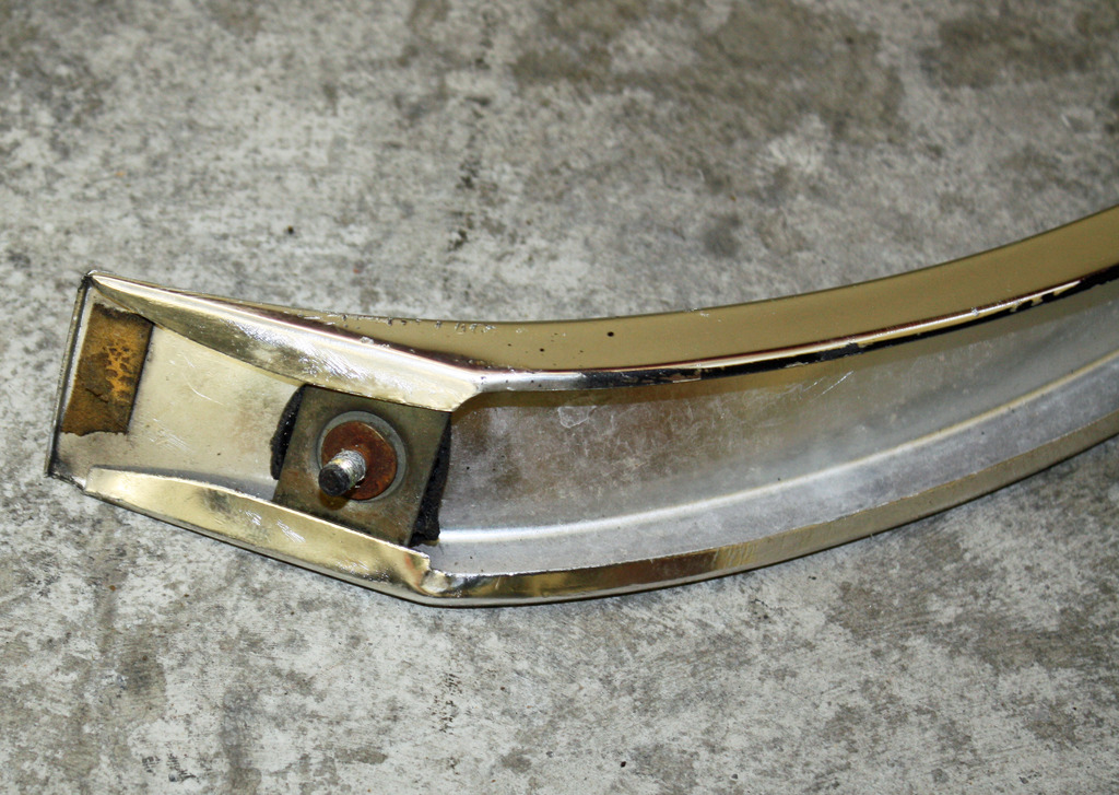

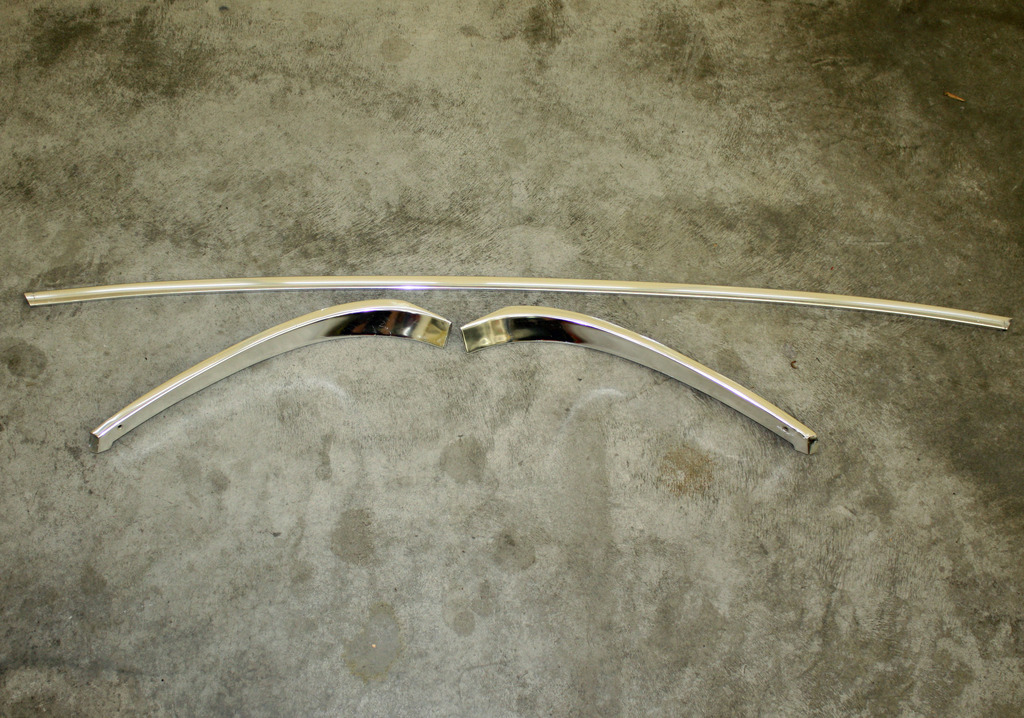

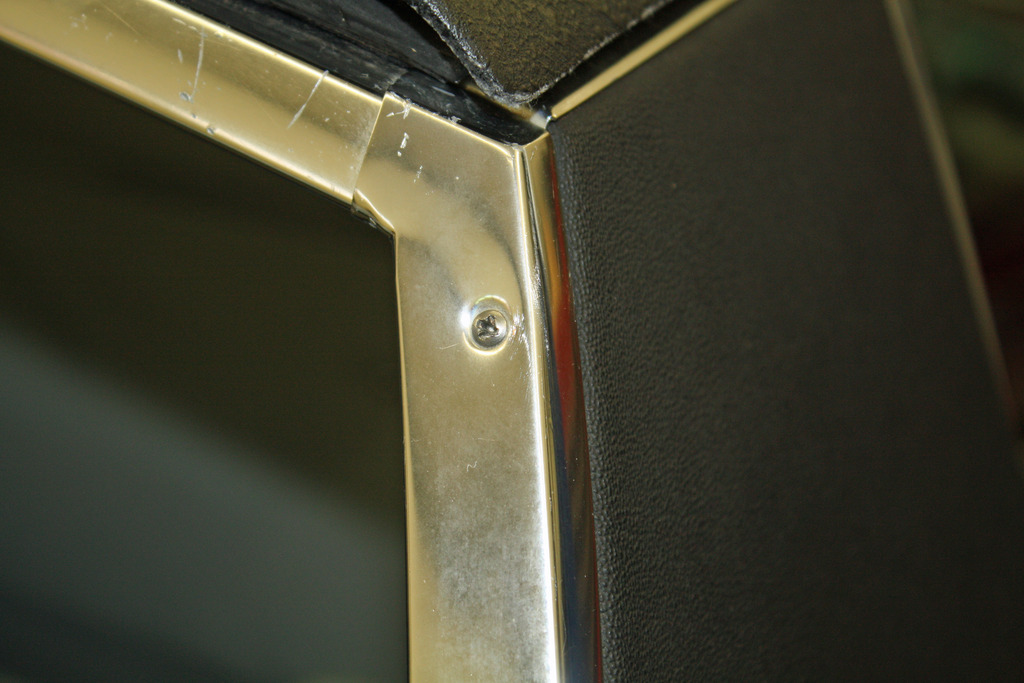

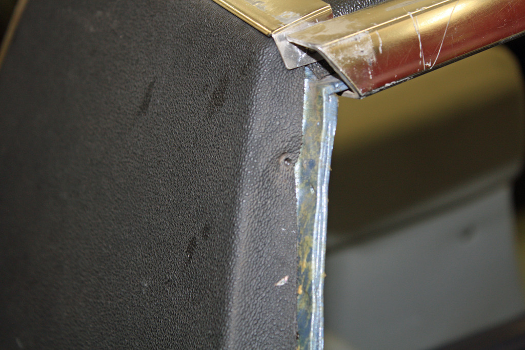

jerhofer   The sail panel trim and the long trim pieces acros...   Jun 18 2018, 03:11 PM
jerhofer   There was some surface rust in the battery tray. ...   Jun 18 2018, 03:23 PM

mepstein   Looking forward to the trim restore. It’s a weak...   Jun 18 2018, 05:11 PM

jerhofer   To make the 9" wheels work on the rear, I nee...   Jun 21 2018, 04:10 PM

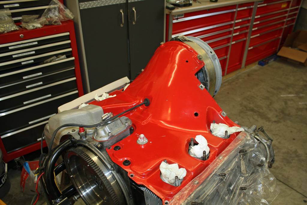

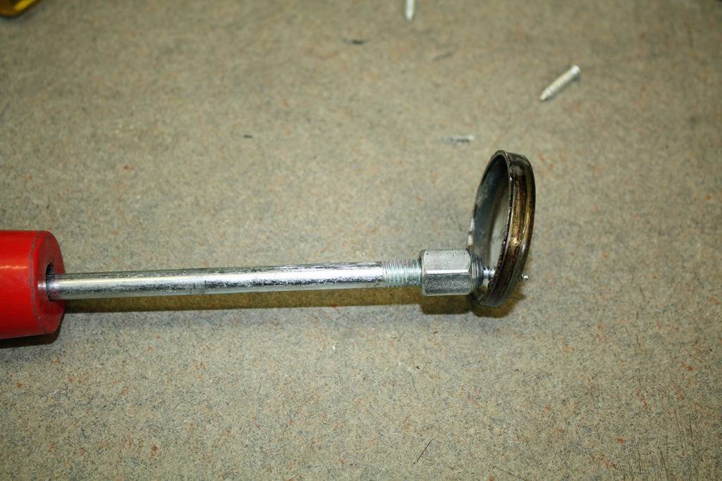

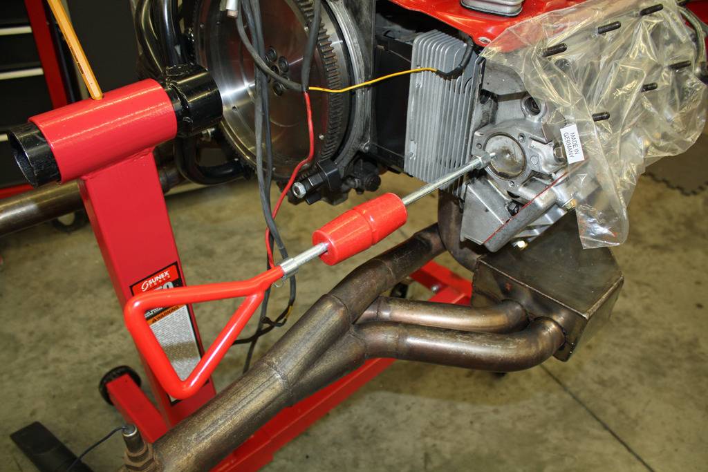

jerhofer   I finally found a few hours to spend on the engine...   Aug 21 2018, 07:20 PM

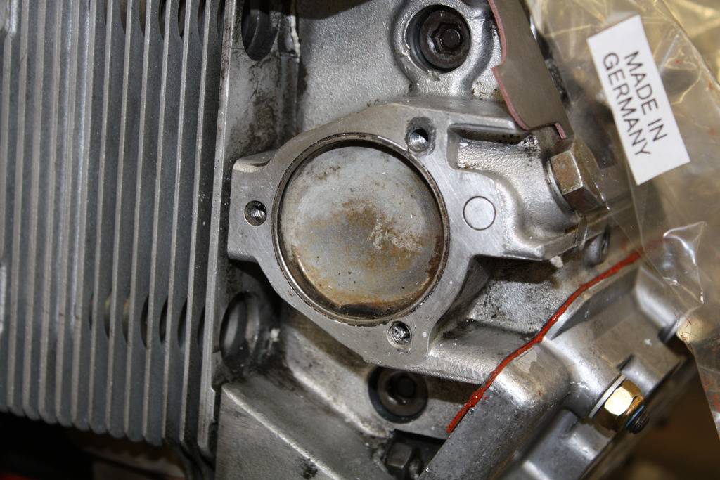

jerhofer   When removing the valve covers, one stud came out ...   Aug 29 2018, 02:45 PM

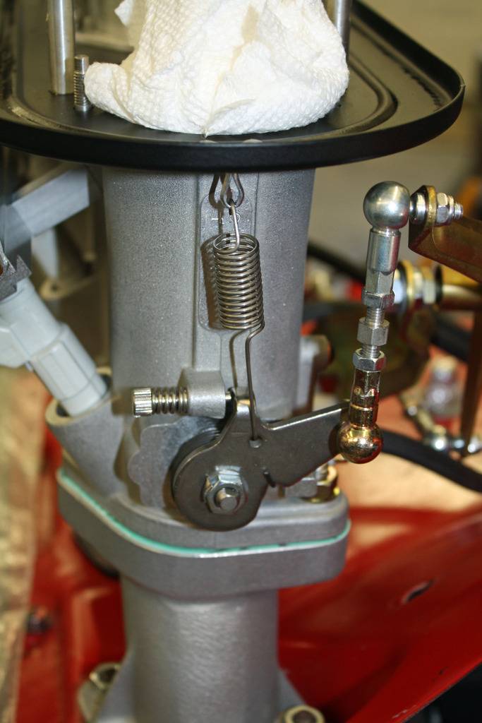

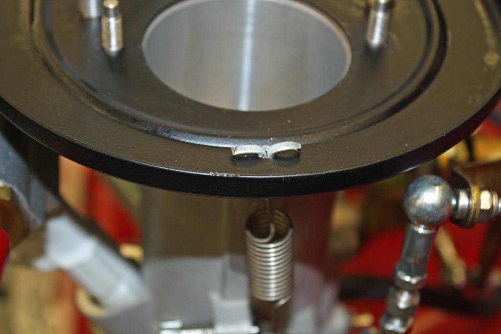

jerhofer   Now it was the throttle bodies turn. First up is ...   Aug 31 2018, 07:59 PM

jerhofer   I finished up the linkage today. The left side ro...   Sep 3 2018, 04:13 PM
