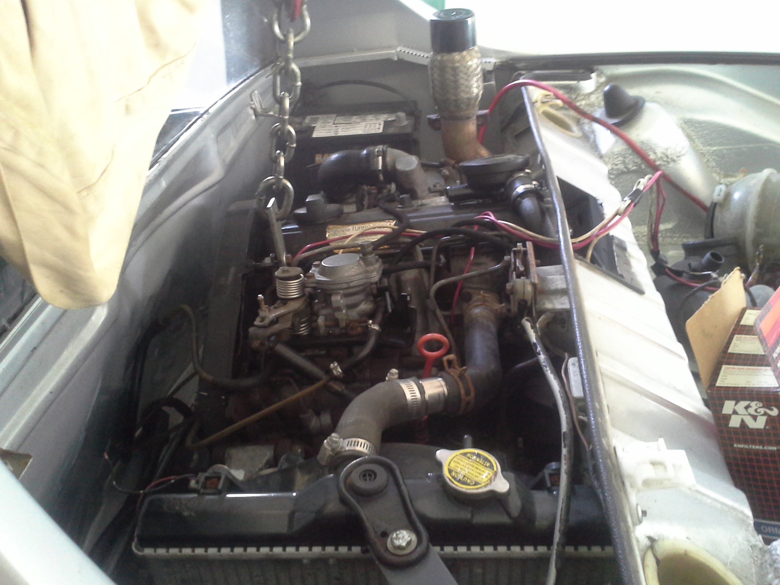

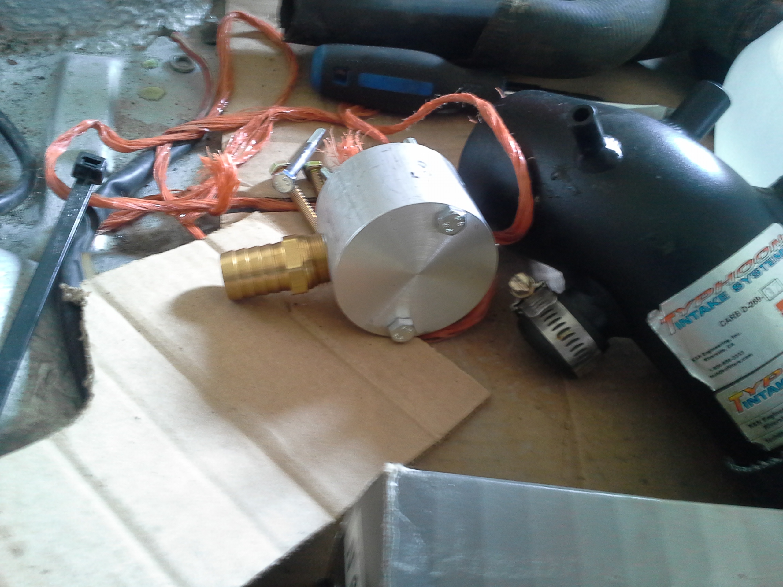

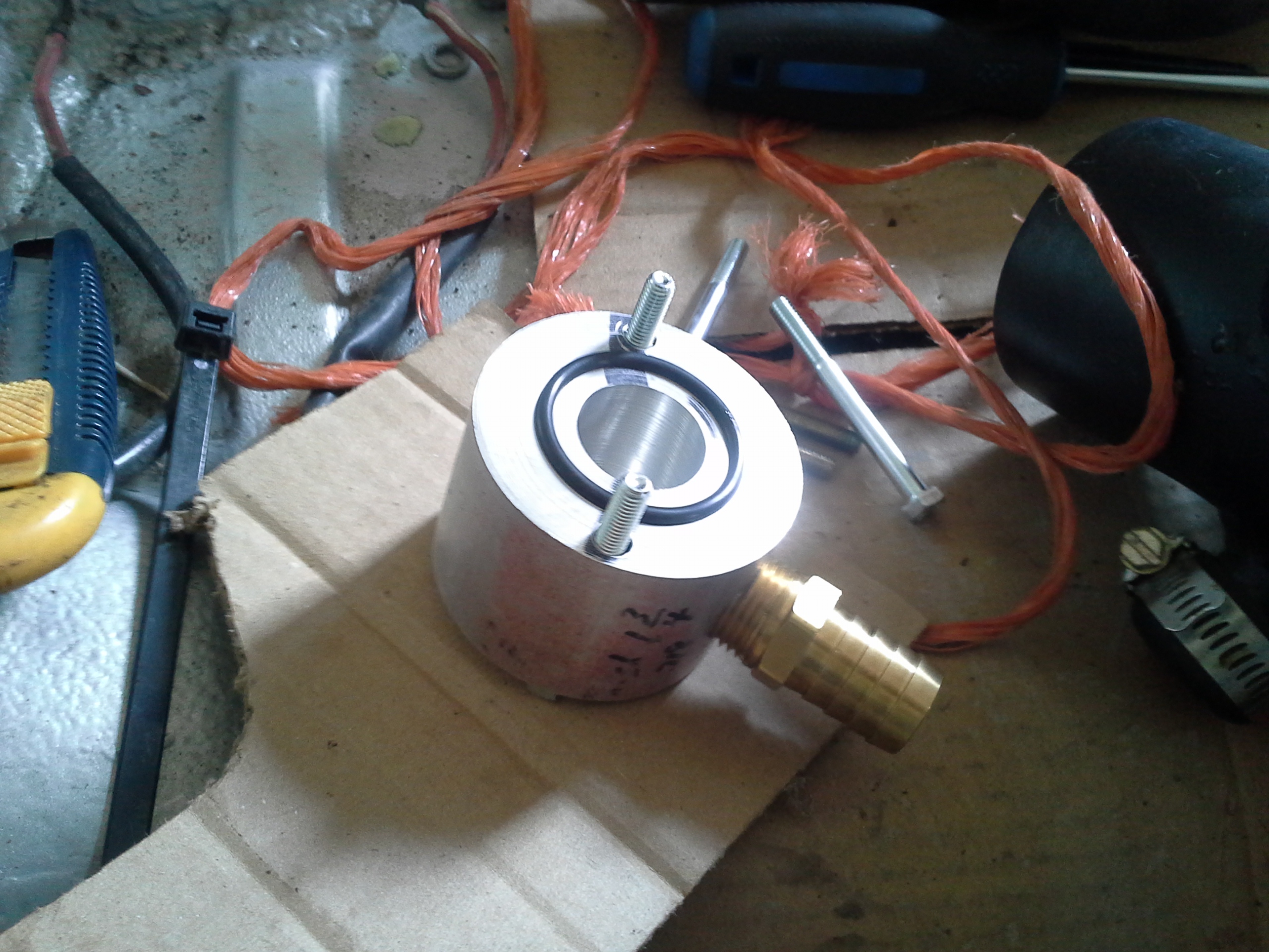

Attached Image Attached ImageAttached Image
Rad in, custom water outlet from back of head for space...
Working on fuel today. removing electric pump from under the tank. the injection pump has it's own vane pump in the front for a primary pump. Wouldn't hurt to leave the electric, but it would run constantly instead of shutting off because the injection pump bypasses excess fuel back to the tank. Would make priming the system really easy but I don't want to listen to it.
The exhaust is straight up just until I get to the muffler shop.
