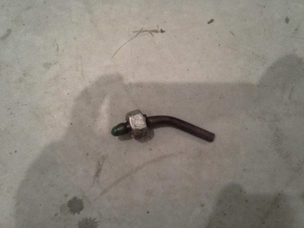

Had a chirp that turned into a BAD miss, valve seat issue on one cylinder.Attached Image
Had a fresh 1.9 AAZ diesel sitting in my storage trailer that had never been fired. (honed, rings, bearings, injection pump reseal). "new" engine was destined for my daily beater . Same engine in the beater is getting a little tired, I've put at least 350,000 km on it and the compression is getting down. Still runs okay though. Swapped the "new" engine into the beater. 16 year old son is learning...Attached Image

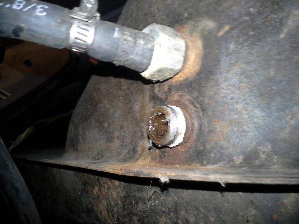

Hooking fuel lines. No return line with previous carbureted 2 litre.
removed electric pump under the tank, direct connect from tank to the line to the back of the car.
Went to hook the return line to the other nipple on the bottom of the tank... plugged off.
Screwed it out of the tank. I don't think the return on the diesel should go into the bottom, it should probably dump in the top of the tank. I think I'll need to make a new return with a pipe all the way to the top of the tank. Anyone know what size rubbers I need to put this back together? Or is this even stock on these tanks? First time I've had the tank out.Attached Image Attached Image
