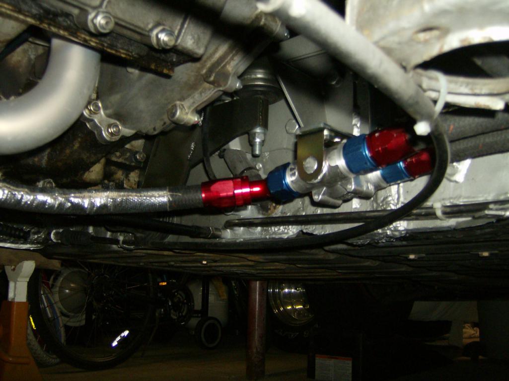

Tomeric, can you please share a picture of how you routed the oil lines into the tunnel from the engine side?
Great build thread by the way.
I was planning to route the lines the same way you have done

QUOTE(totle @ Sep 7 2018, 04:18 AM) *
...can you please share a picture of how you routed the oil lines into the tunnel from the engine side?
Post #53 has all of the important views as far as where I cut and what I used to line the sharp edges with.
http://www.914world.com/bbs2/index.php?s=&...t&p=1670785
From the engine firewall side, I fed the lines in through the heater duct. I don't have any pics of that, but it should be self explanatory.
I did connect the two lines going to the heater duct to a 200 deg F Mocal thermostat.
