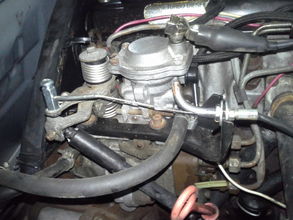

Had it fired up today but the injection pump ran out of fuel before the system filled. Done for today. Need to get the wheels back on, set it on the ground, fill the tank to the top with diesel and bleed the system.
I have a throttle cable issue... I'd like to have a cable about a foot longer with about an inch more sticking out of the housing. It's hooked but only just. And it's starting to fray... Anyone this side of the border know a good source for cables? And is there a stock cable for something else that fits my wants?? Or am I looking at a custom cable?
The other option is to blacksmith my cable mounting point and/or use the end of the Jetta cable hooked to the Porsche cable.... messy.Attached Image

Chris H.   Terrycable will make you one. I had one made a fo...   Sep 8 2018, 03:58 PM
PatrickB   Terrycable will make you one. I had one made a f...   Sep 8 2018, 04:17 PM
