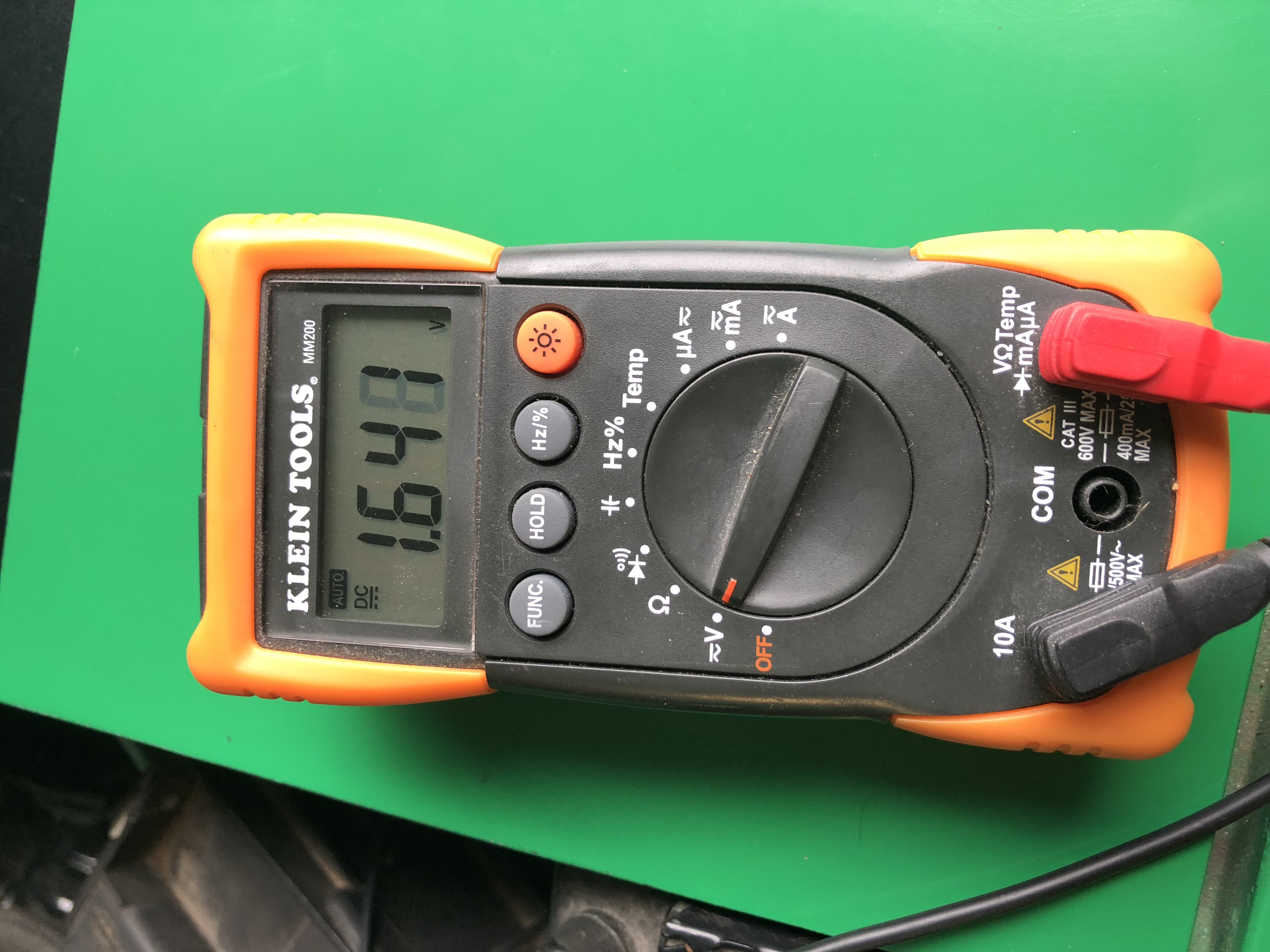

I’m back to grounds.
And I’m going to put a new battery in my multimeter, as it’s lying to me somehow on Ohms. It’s gotta be. Just did the DF shorted to D+ test, measuring voltage from D- to chassis. I picked 2 spots to measure. Both showed a voltage of (drumroll please...) 1.6 volts. Yesterday, and today, I was showing zero resistance between any points on the car. But I have a voltage drop of about 1.7 volts. It danced around a little bit settled between 1.6 and 1.7. Something is resisting somewhere. This would also probably match with the voltage difference in seeing when I measure the battery and what the ECU says it’s seeing on my testing laptop, as the ECU is seeing less. Another curious note. The red Gen light comes on at key in, goes off when the engine starts, and stays off when I pull the VR out of its slot. Should it do that, or should it light up again to alert me that something is not charging? Zach Attached thumbnail(s) |
