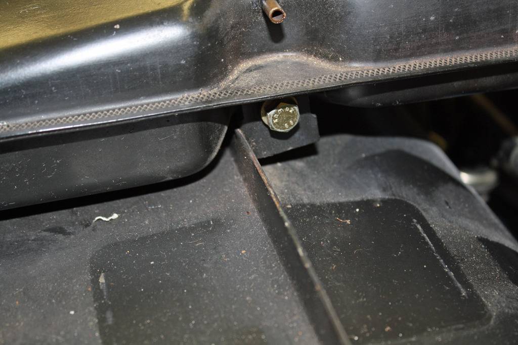

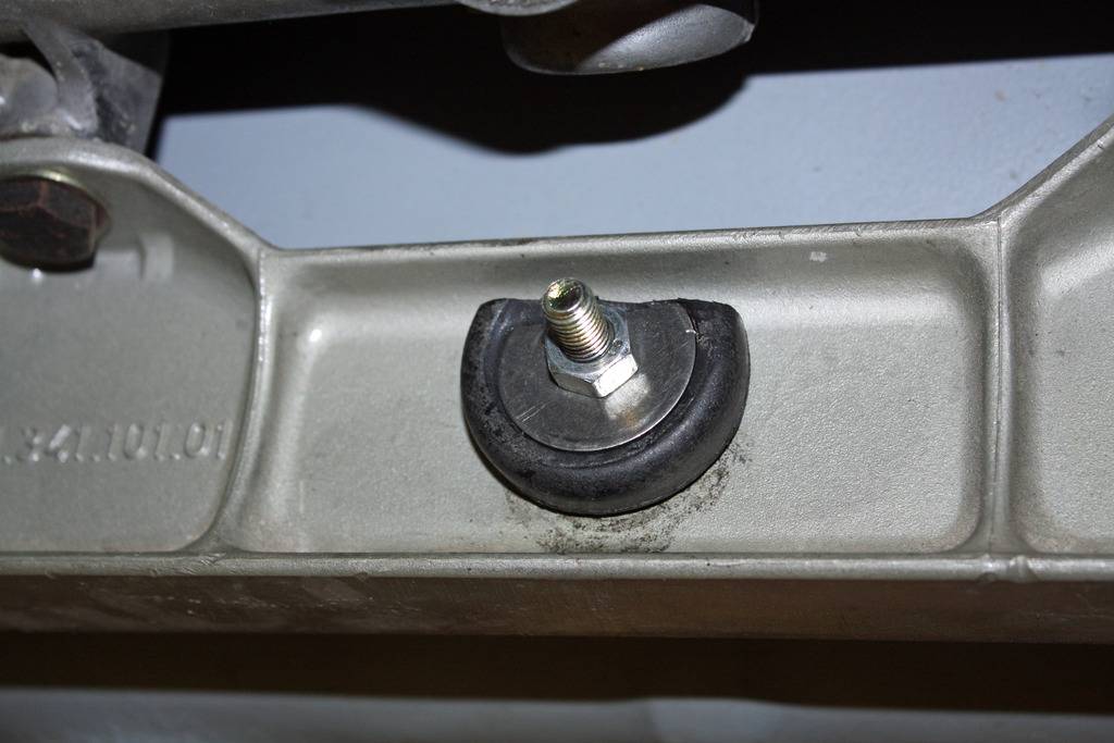

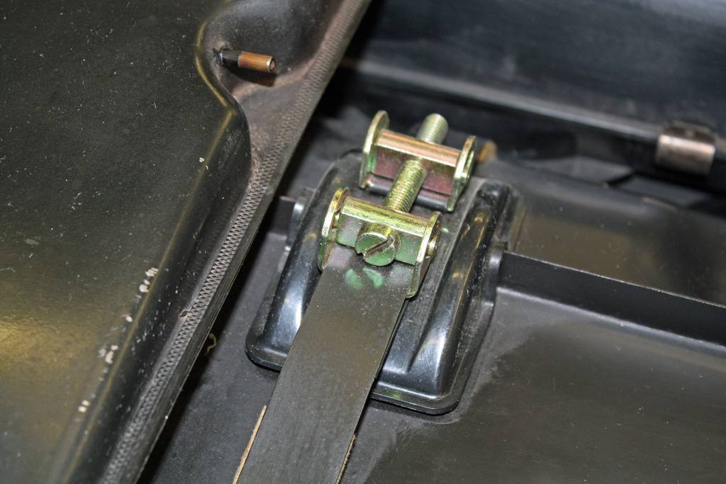

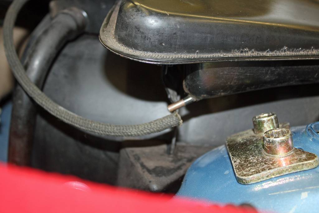

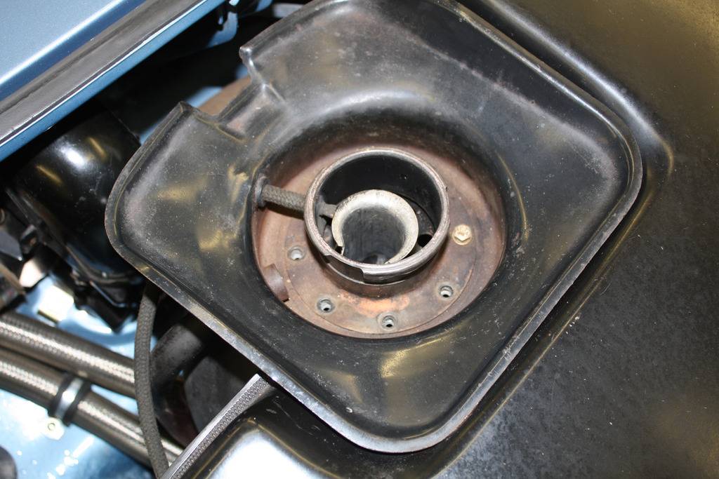

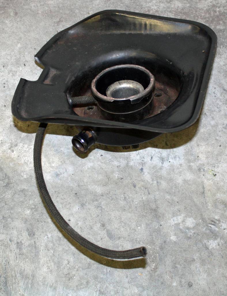

I pulled the fuel tank this morning. First up was removing the filler neck and then the expansion tank.

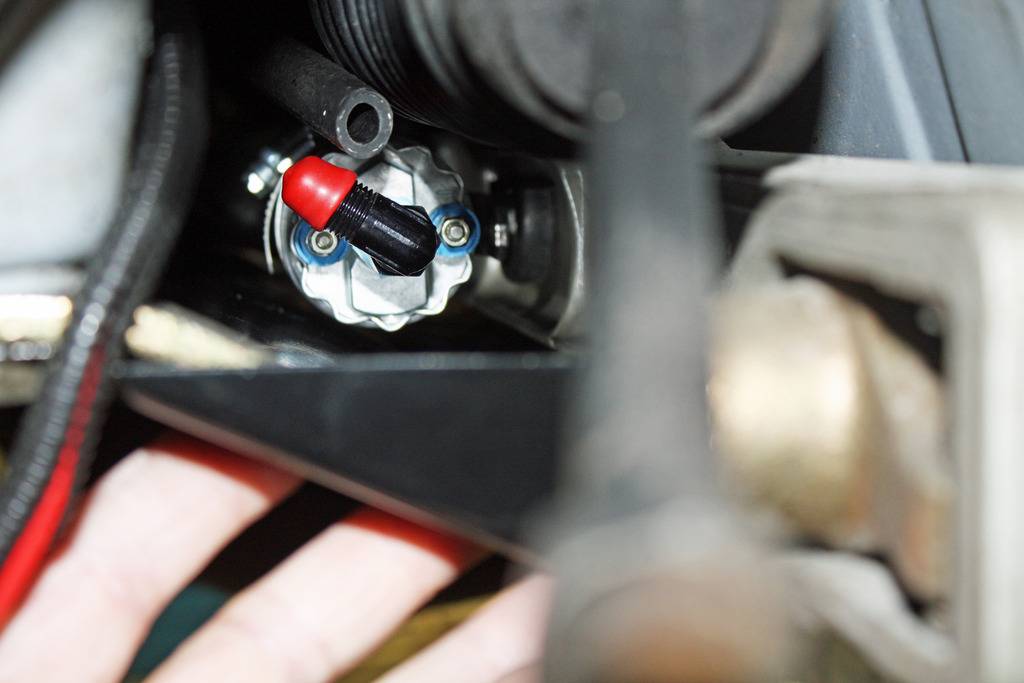

jerhofer   Another day, another sensor for the engine. This ...   Sep 6 2018, 01:51 PM

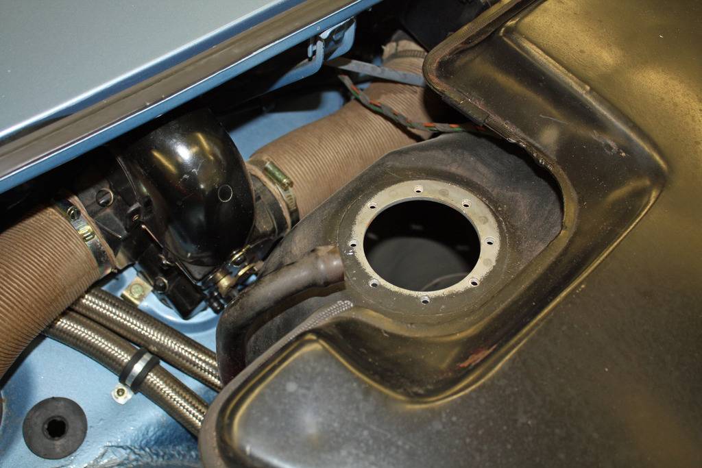

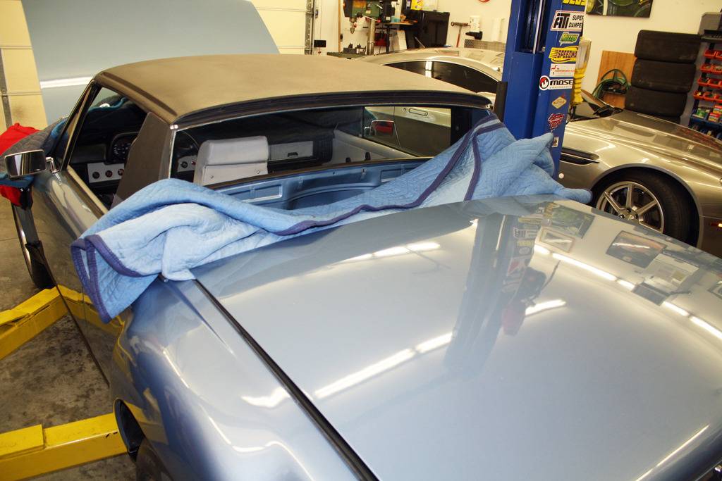

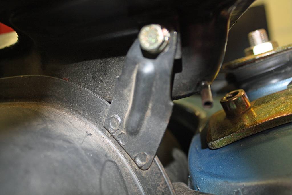

jerhofer   I pulled the fuel tank this morning. First up was...   Sep 10 2018, 02:43 PM
jerhofer   Before removing the tank, I looked inside to see i...   Sep 10 2018, 02:54 PM
jerhofer   Now I wanted to figure out what I was going to do ...   Sep 10 2018, 07:14 PM
