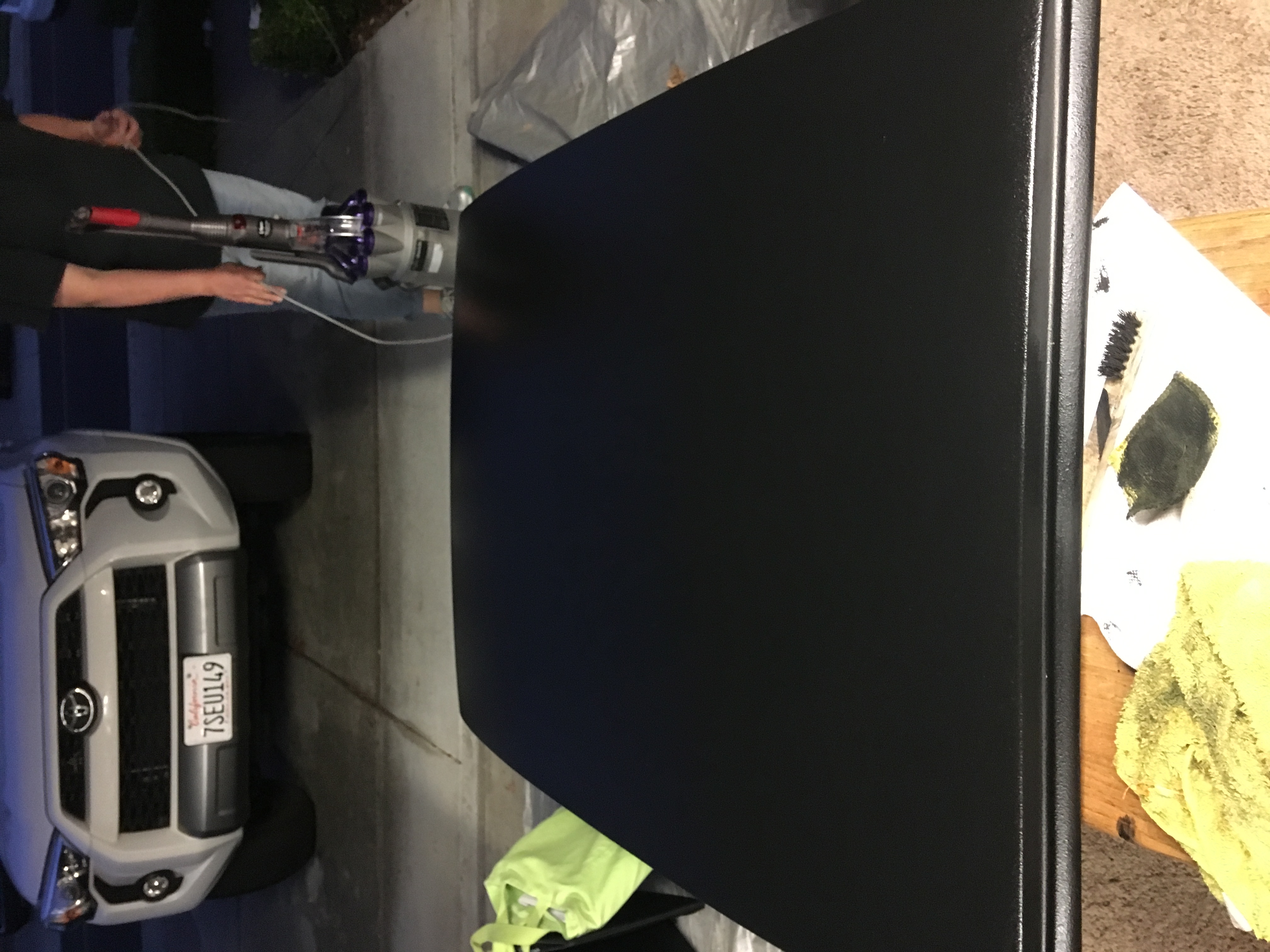

EdwardBlume   So you guys scared me out of painting it, so I ord...   Sep 14 2018, 07:52 PM

Dougster   So that's a success right? I'm not seeing ...   Sep 14 2018, 08:07 PM
PlaysWithCars   Wow! That turned out really good. I would def...   Sep 14 2018, 08:35 PM

EdwardBlume   The plastic dip was just filler on the messed up p...   Sep 14 2018, 08:40 PM
Robnxious   Looks fantastic, the one "warning" I wil...   Sep 15 2018, 09:21 AM
mepstein   Looks fantastic, the one "warning" I wi...   Sep 15 2018, 09:38 AM
Robnxious   It shouldn't touch, even with spirited drivin...   Sep 15 2018, 10:01 AM
