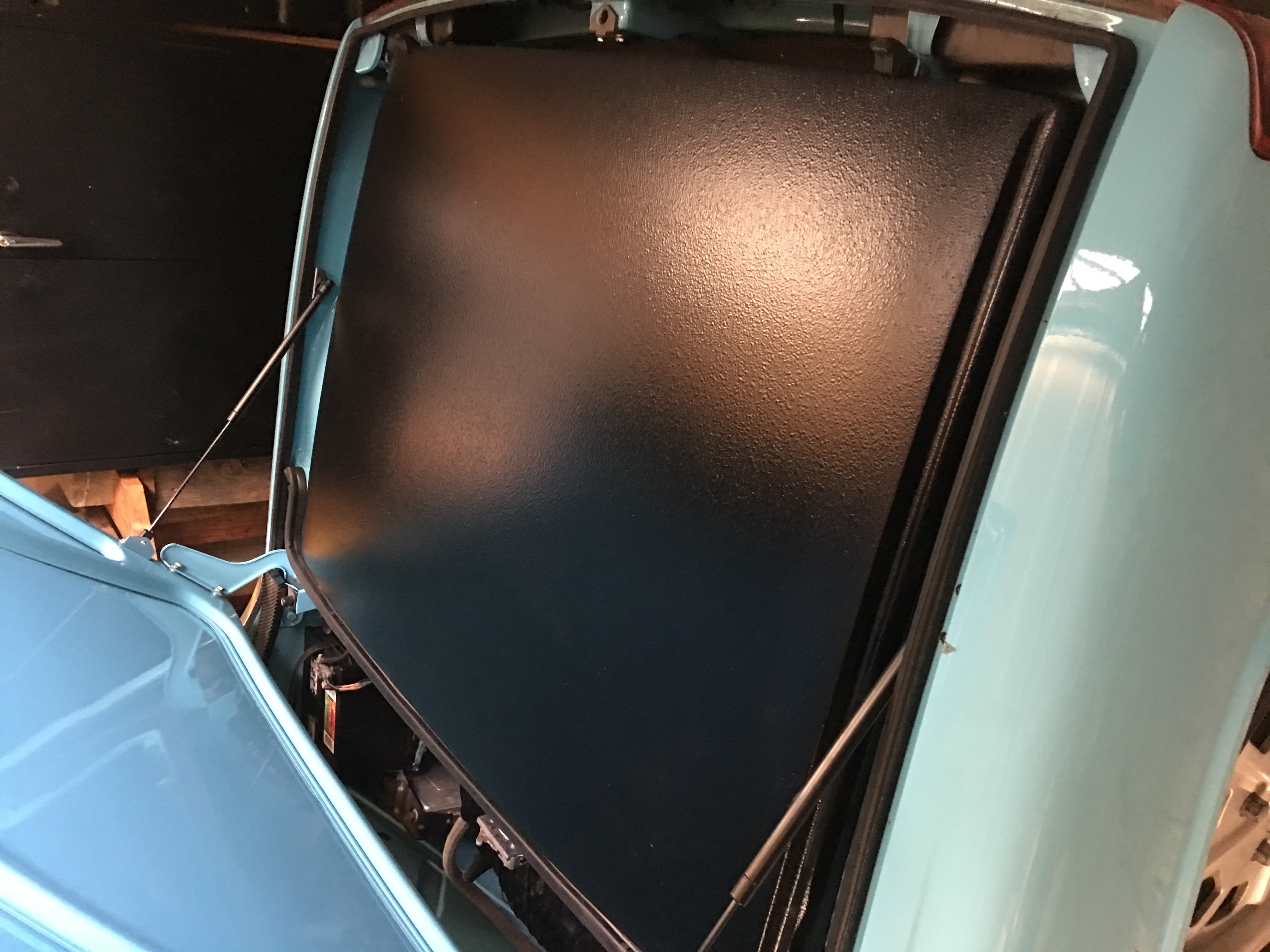

The ABM needs a new top. The prior one I had restored is early vs late. This time I’m going to do it myself.
I picked up a late top at the swap yesterday.
What are the 4 stages and products from wheeler dealer? I need to paint it for sure due to aging, scratches, dings and chips.
Also, what is this seal on the rear inside. It is chalky and old. Needs replacement.

I had this top done by Scott Yeaman in Palo Alto. He shot it.
Unfortunately it’s an early top which is going on a 74. Not sure how that happened.
The other pictures are what I did and it was not shot at all. I wouldn’t mind doing another one based on what I learned....

EdwardBlume   So you guys scared me out of painting it, so I ord...   Sep 14 2018, 07:52 PM
EdwardBlume   Another shot   Sep 14 2018, 07:52 PM
Dougster   So that's a success right? I'm not seeing ...   Sep 14 2018, 08:07 PM
PlaysWithCars   Wow! That turned out really good. I would def...   Sep 14 2018, 08:35 PM
EdwardBlume   Here’s the line up.   Sep 14 2018, 08:38 PM
EdwardBlume   The plastic dip was just filler on the messed up p...   Sep 14 2018, 08:40 PM
Robnxious   Looks fantastic, the one "warning" I wil...   Sep 15 2018, 09:21 AM
