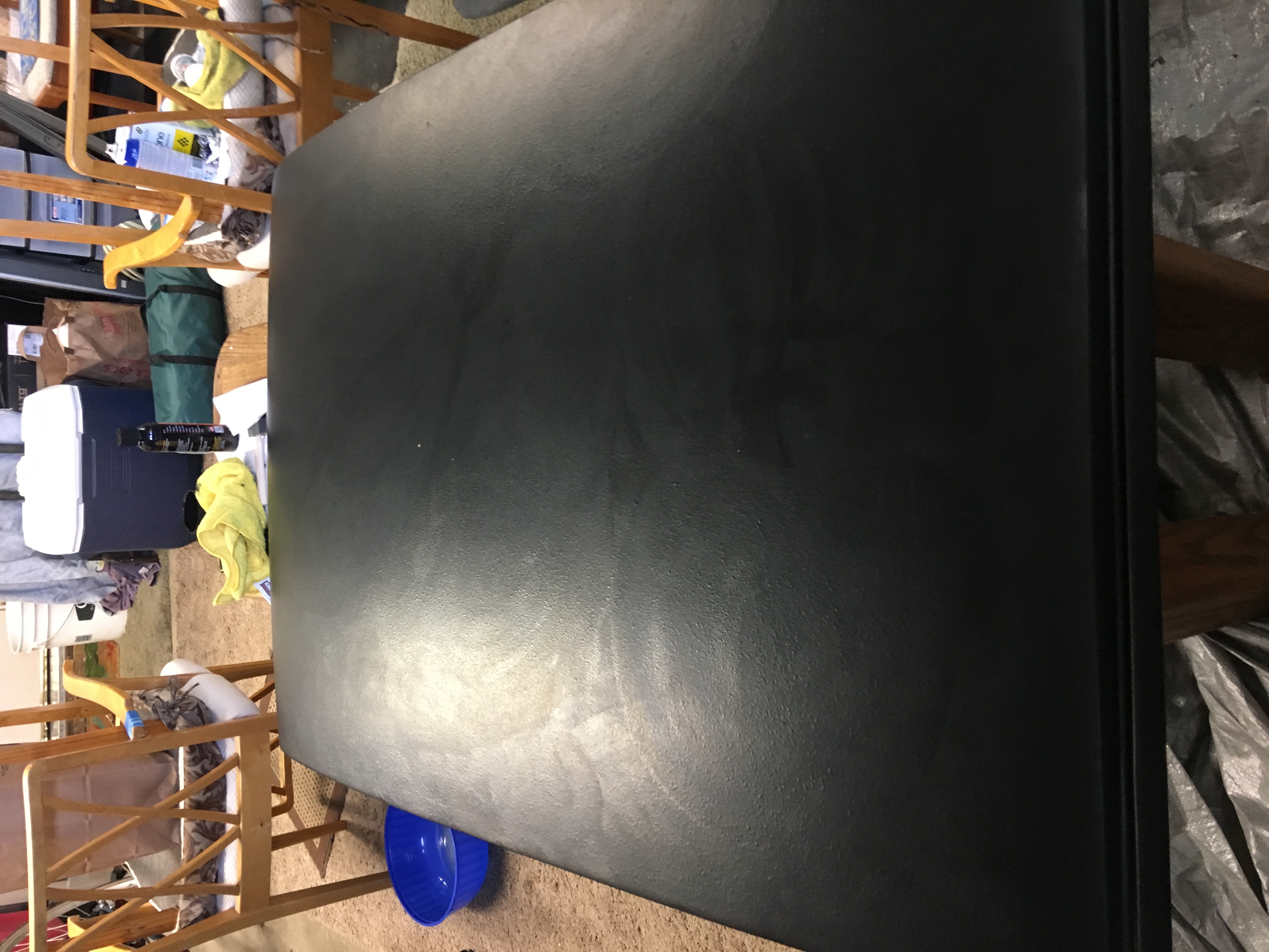

Not in any sense of order but this picture is of the swirl marks before I did the top off with black chrome.
