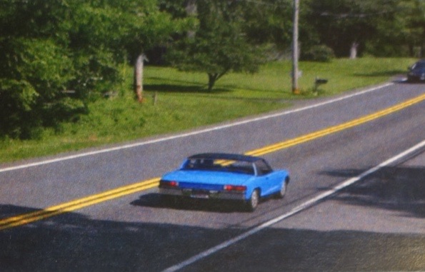

I have been a Porsche enthusiast since the mid 90s. Had a few 914s and converted them to 6s and had fun. Then I wanted a real 914-6 so I could have the genuine article, a car to restore to my own standards. In the mid 2000s you could find a beater 914-6 driver for $15k and a nice "restored" car for $25k. The restored cars back then were only restored within the dollar amount of their value or a slight bit over, these restorations had something to be desired and I thought I could build a better car myself out of a very good solid project car. I ran a classic car dealership in 2006, I looked at hundreds of cars per month for the dealership, snuck in a 914-6 search each day for a year... Then I found this car:

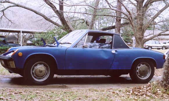

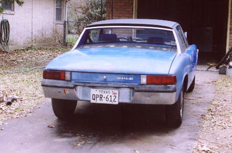

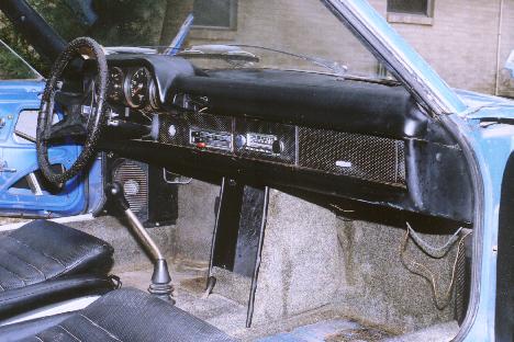

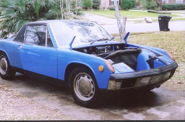

1970 Porsche 914-6, 2.0L, chassis# 914.043.0200, engine# 6404086 (Blue, 72,000 mi, steel wheels, needs work) in Houston, TX. Ph xxxxxxxxxxx Asking $13,000
This car was driven until late 1977 and then stored in my garage and totally neglected since I have been busy with other problems. Unfortunately I have lost the documentation on this car, so I will try to describe its history, but cannot back up many of my statements with tangible evidence.
I bought it used from a Porsche dealer (Holbert in Warminster, PA) in 1972 or early 1973 while I was living in northeastern Maryland. In fall 1973 I moved to Houston, Texas. It was maintained in Houston by the Jimmy Adams shop, which specialized in Porsches and VW's, and I drove it nearly every day. At some point (probably around 1976) the shop owner convinced me that Porsche 6-cyl engines needed a lot of care and would need an overhaul, so probably at about 60K mi (just my guess) the engine was torn down, rings, bearings, etc replaced, but I have no documentation. Adams said the pistons were higher compression than stock. In spring 1977 I was offered a temporary job in Austria, and the car was shipped back to Europe. I got to drive at 90 mph to work on the autobahn for a few months. I have documentation that the clutch was rebuilt by Porsche Wien-Liesing at 68K mi. In the ship on the way back to the U.S. the driver's door was dented. In late 1977 I noticed a lot of rust under the battery and on that side on the exhaust system. Also, the brake master cylinder started to leak. I took various things apart and cleaned and primered the battery area, but at that point (1977-early 1978) I became very busy, my job situation became unstable, and I have not touched the car since except to roll it out, clean a little dirt and put Armor-All on the vinyl last month. It has been in a closed garage but in a very humid climate since the beginning of 1978. I am looking for someone who wants it as-is to refurbish. I have been warned by an engine expert not to try to turn it over because he suspects rust internally.
On the way back from Europe the shipping company sprayed a brown polymeric goo on the outside of the car (esp. chromed parts) which was very hard to remove. In pictures of the car some brown is rust but some is this polymer. Also, the primer I put around the battery area is tan (almost rust) color. A prospective buyer will really have to examine it in person to decide, but I believe that someone can restore the car without major work. The fuel tank has been stored dry on a high shelf in the garage since 1978. In 77-78 the left door liner was removed and stored in preparation for removing the door dent, but this was never attempted. The front hood was removed and stored, but during storage a small patch of severe rust formed on the leading edge of the hood. In 77-78, besides putting primer in the battery area, I removed the exhausts and riveted pieces of galvanized sheet metal over rust holes in the heater boxes. More pictures on request.
Good old Dale said that he figured himself a hot shot when he got his PHD in the early 70s. He celebrated by walking in to Holbert's to buy a Porsche. Without the biggest budget he could not quite get into a 911. Maybe a 912 would work... the salesman took him over to a discounted 914-6 trade in with very low miles. Dale got the car for a great price and the moved to Texas and used the car as his primary driver. He got a job in Austria to work on the design of a power plant behind the iron curtain of the USSR and the 914-6 was shipped there to use as his driver. The power plant was canceled and Dale came back with the car. In 1977 he saw that battery acid had eaten the battery tray, this acid also dripped on the passenger heat exchanger which cause a few small holes. Dale panicked and took the battery out, the heat exchangers off and removed the front hood to get the fuel tank out (afraid of hidden rust down there too). This is the lesson to learn, he removed 3 critical functioning items from the car and ran out of time. The car then sat in his garage from 1977 till 2006 and was really a time capsule of originality.
The car sat on Pelican classifieds for a while and I made an offer, Dale accepted $9k for it and I flew out to see the car in person. Dale met me at the airport with a sign that simply read "914-6". He was a geeky scientist looking guy and not someone you would guess was a Porsche owner. I interviewed him about the car in the car ride and he was fascinated why I would want to know all this about his old car. The car sat in his single car enclosed garage, it was like a barn find pulling it out, unfortunately the front hood was rusted because he put it in a corner low spot that flooded every once and while. The heat exchanger had some slight rust but they were an easy repair. The rest of the car was complete, untouched, and 100% original. The full tool kit was there, owners manual, and some of the records. The battery tray was rusted through but none of the rust passed into the frame area and the rest of the body was rust free. I pulled out $9k in cash, Dale and his wife almost fell over, he was shaking as he counted the money inside his house. This was obviously a big sale for him and I assured him the car was in good hands and off I went. $700 to ship to my place in California.
Then I went down a rabbit hole and thought I would triple my efforts into used Porsche sales and opened a restoration shop using a name I had created in 2000.... Vintage Excellence
I had purchased a project 911S and this 914-6 as projects that I could tuck away and restore once production was up and running in the restoration shop. My dream of owning a perfect 914-6 and early 911S was on its way. I started the grab for NOS parts for my cars. These cars had to be perfect, I would use my knowledge from trolling VW & Porsche swap meets starting in 1994, expertise from a Porsche parts sales business started in 1997 thousands of parts sold and dozens of parted out 914/912/911s later, I worked for a shop called Oest Enterprises in Torrance for Dieter R. Oest restoring old Porsches and dealing with Dieters massive used parts inventory - Dieter was a former Vasek Polack 935 crew chief and a long time racer. I had worked for a kooky character named Bill Higgins who advertised out of the paper Auto Trader for many years selling classic Porsche parts - there I parted out cars and watched Bill flip a bunch of wrecks, I could not stand the junk car sales so I went out on my own at that point. I put myself through college via the Porsche parts and car sales business and learned plenty by the time I got my degree. I bought a suit and was interviewing for all these silly corporate jobs and I didn't like it so I took a few months off. Then through a friend I got the job at the dealership Cardiff Classics as the General Manager which brings us back to the beginning of the story.

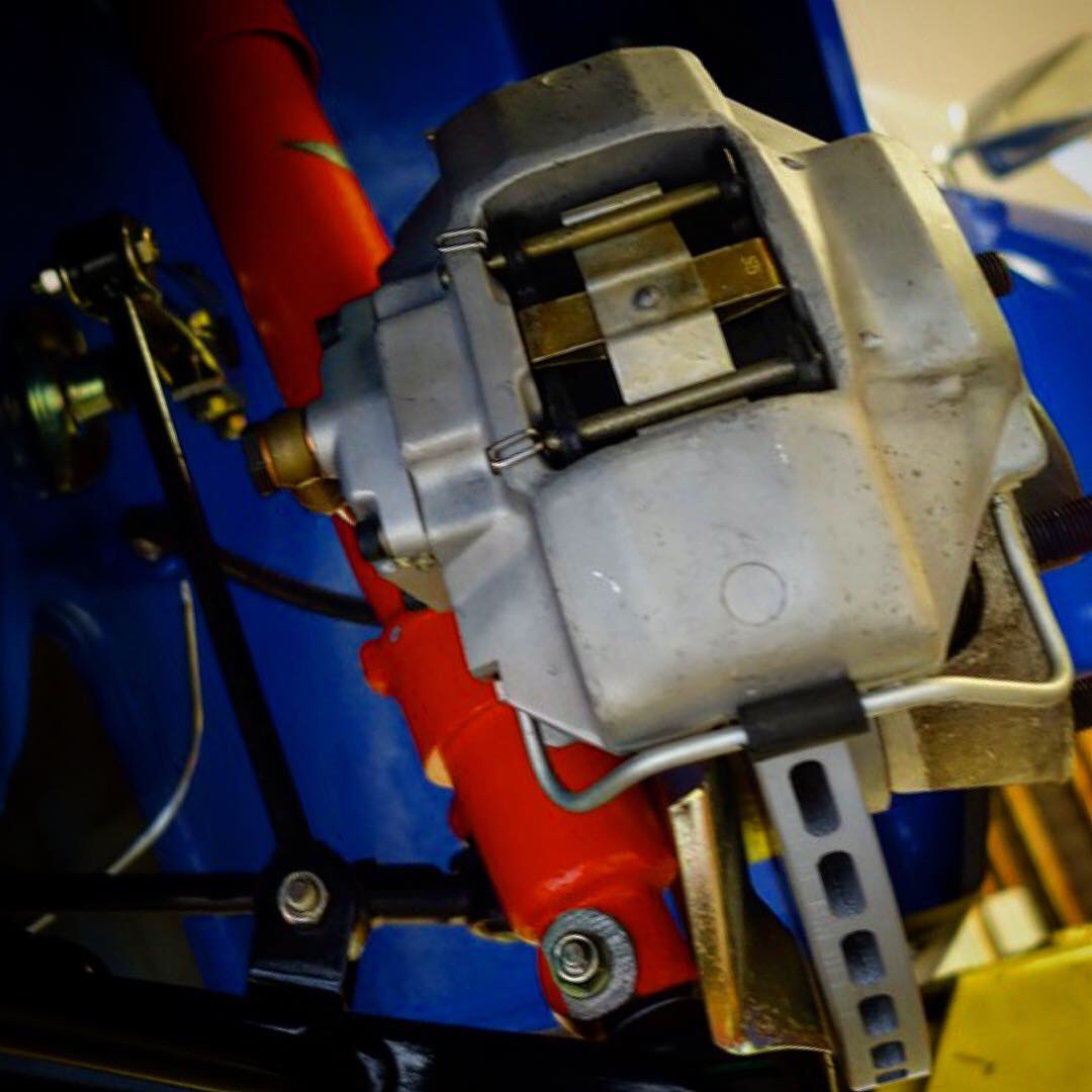

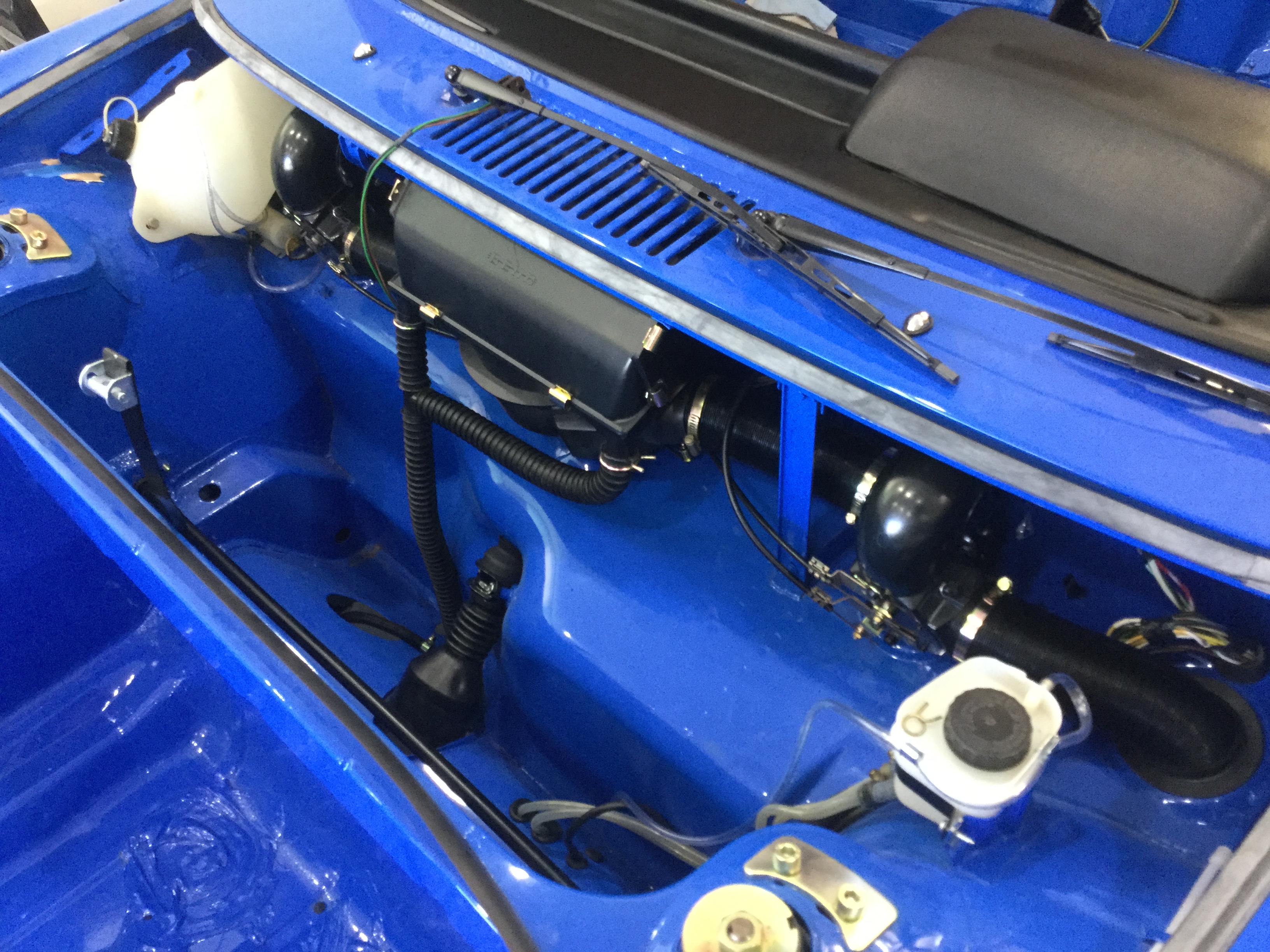

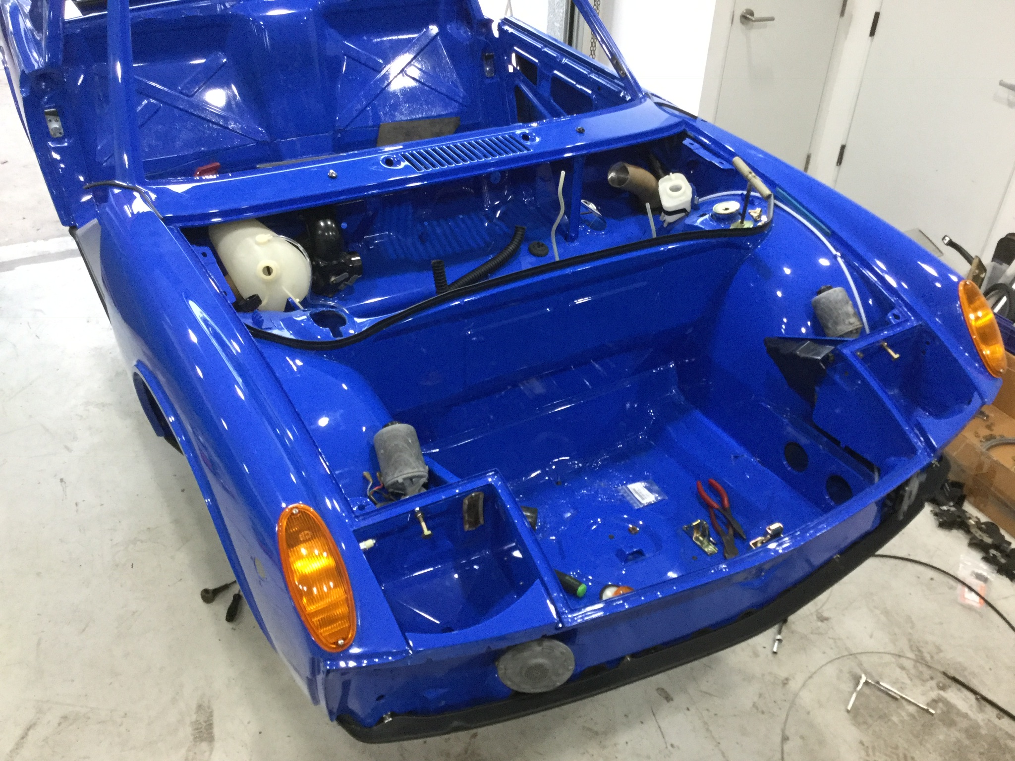

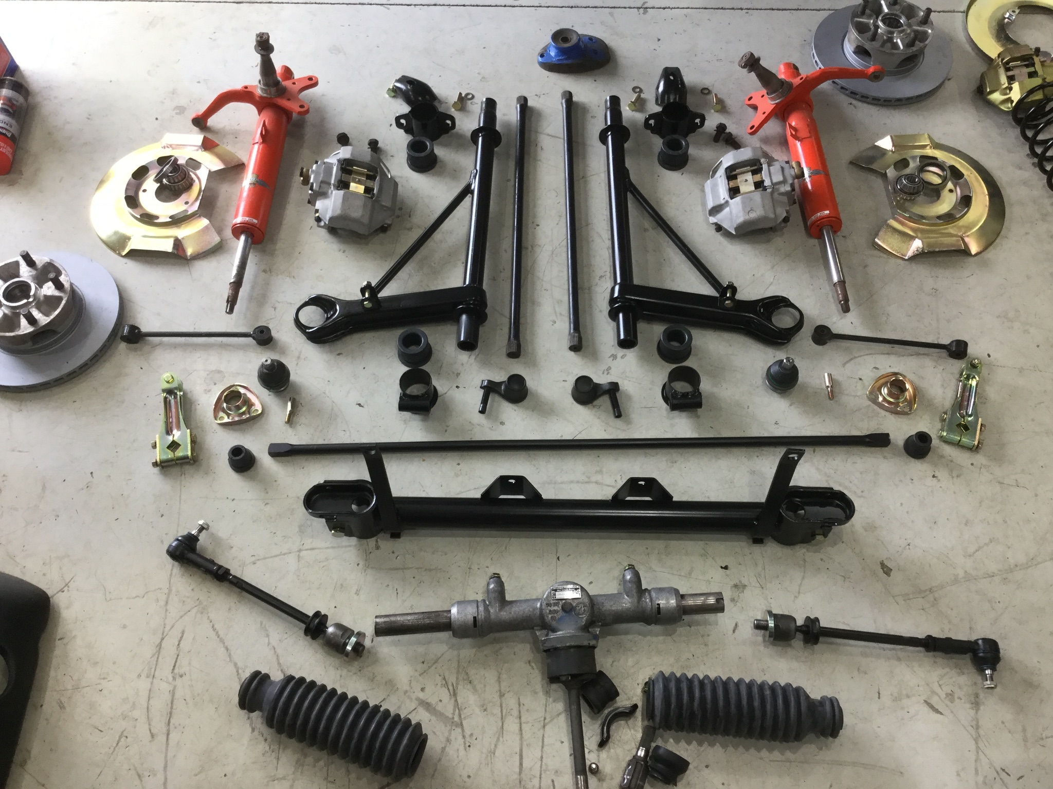

Attached Image Attached Image Attached Image Attached Image Attached Image Attached Image Attached Image Attached Image Attached Image Attached Image Attached Image

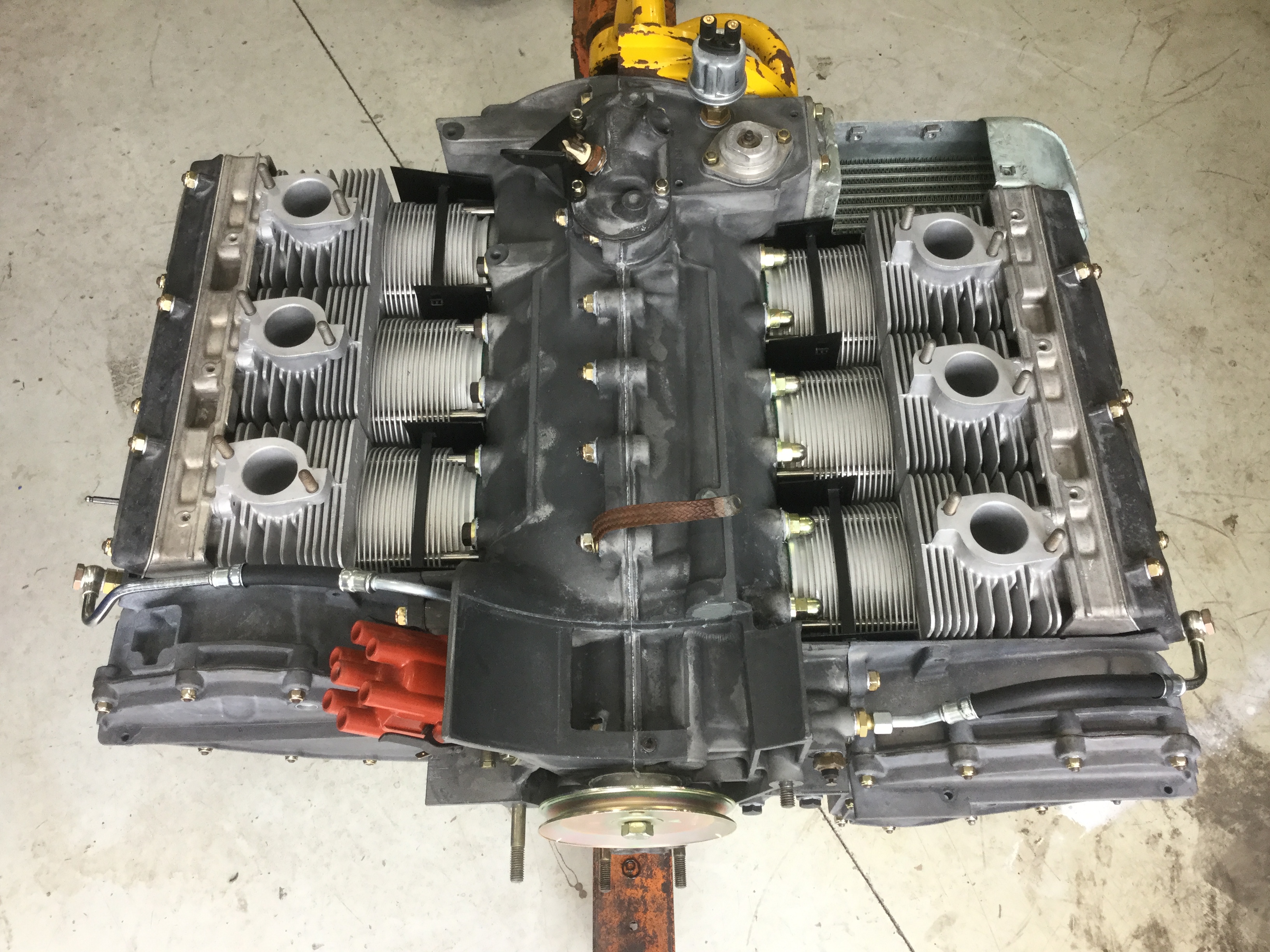

Great color and awesome build.

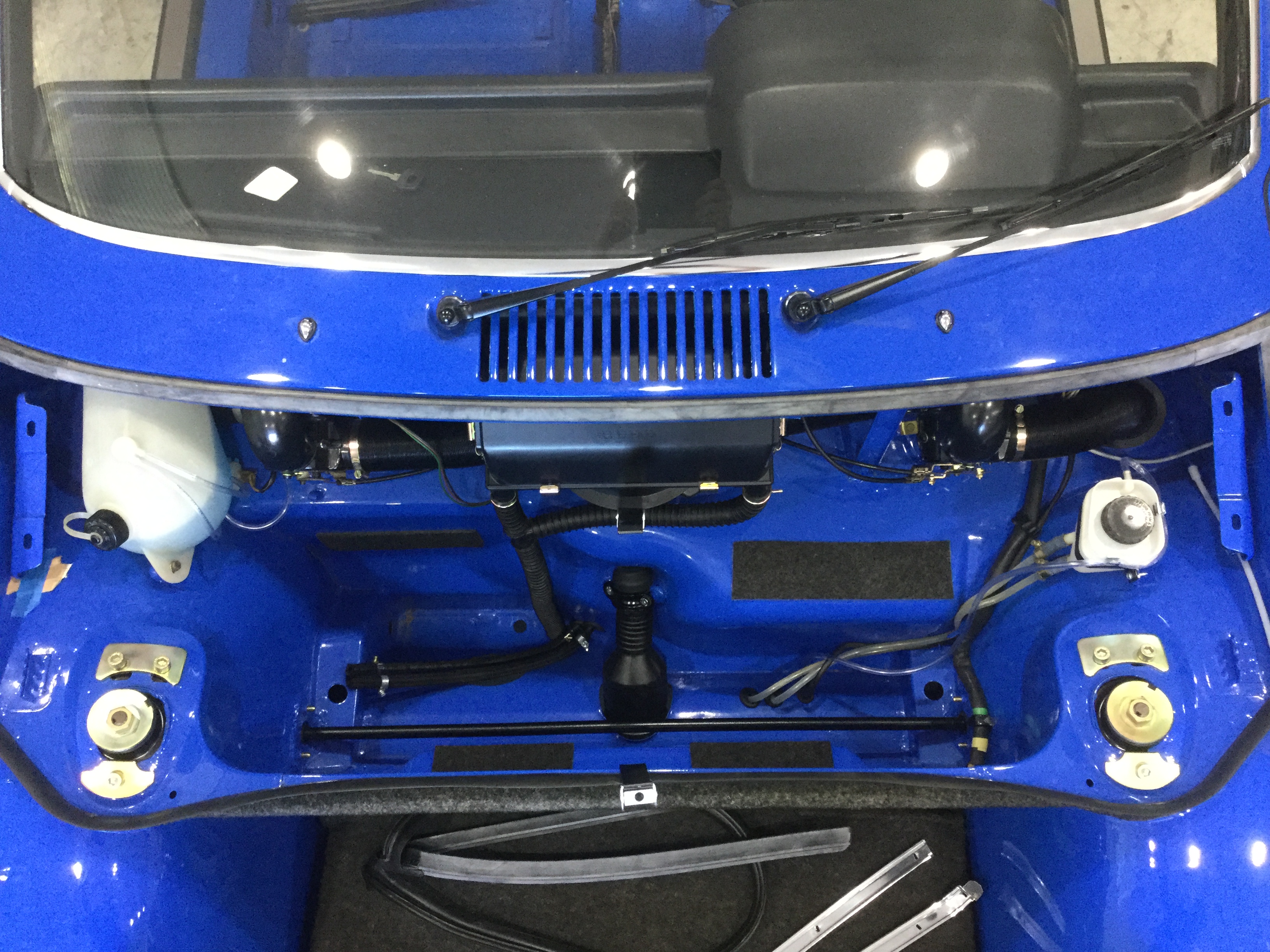

FYI, the front cross-member pictured above is from a 4. The torsion bar adjustment housing on the 6 is more square, while the 4 is more or less oval as pictured above. It wouldn't matter to me, but I thought I would let you know.
VintageExcellence
post Sep 17 2018, 06:15 PM
Posts: 52
Joined: 27-August 04
From: San Diego, CA
Member No.: 2,636
QUOTE(bigkensteele @ Sep 17 2018, 03:01 PM) *
That is the original crossmember from the car, its never been off the car until I painted it. Its also a very early car so couple things could be different from later cars.

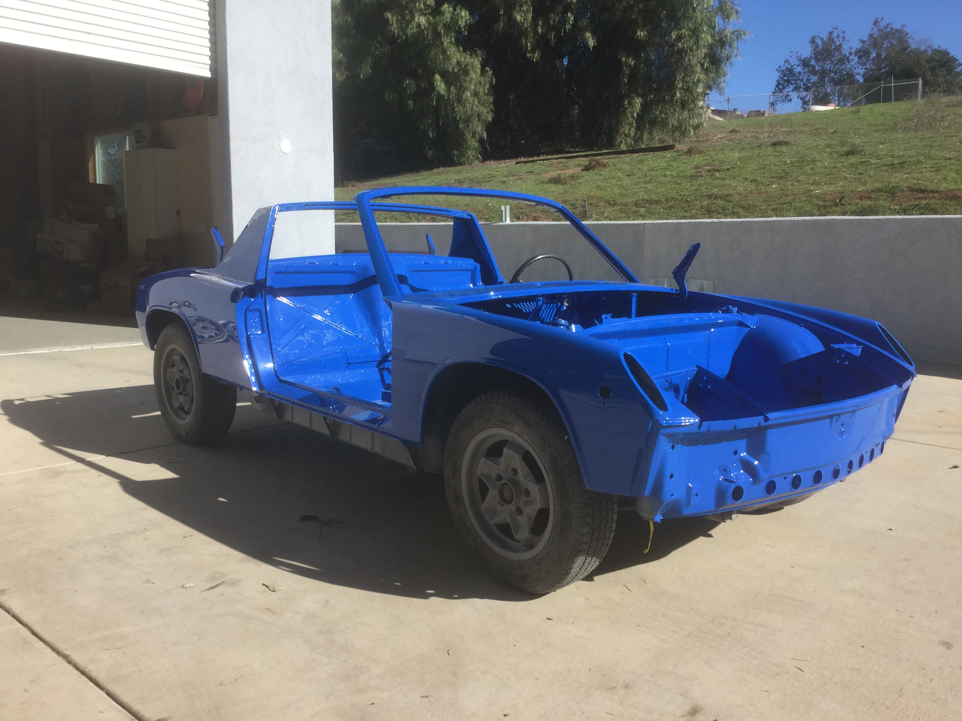

VintageExcellence   I am working away on this car, so much that I bare...   Jun 18 2018, 01:14 PM
Cairo94507   Cool picture of the body parts. Keep up the good ...   Jun 18 2018, 01:36 PM

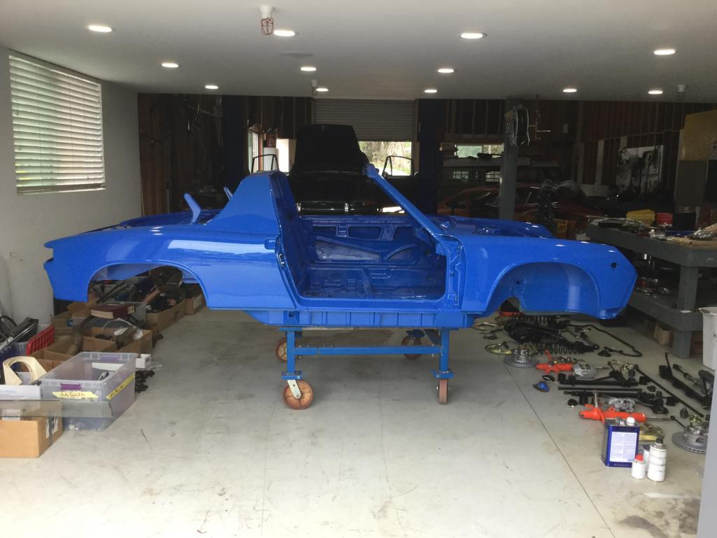

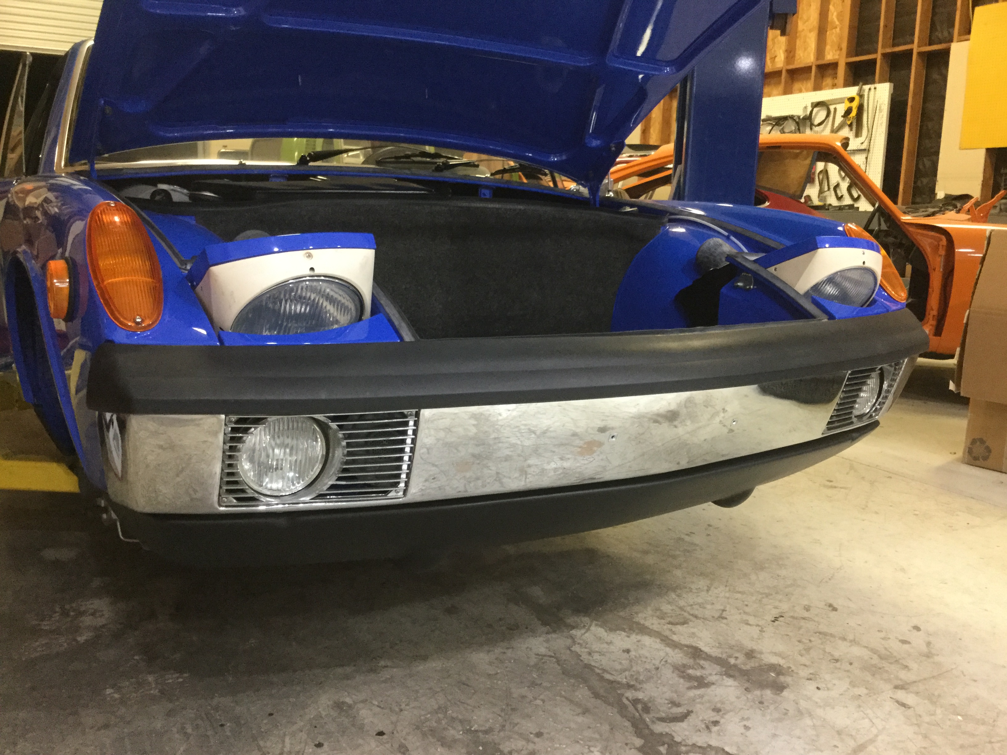

VintageExcellence   When I bought this car I figured I would turn it i...   Jun 26 2018, 01:15 PM
VintageExcellence   paint progress   Jun 26 2018, 01:17 PM
VintageExcellence   Paint code samples. Bumpers are back from chrome, ...   Jun 26 2018, 01:23 PM

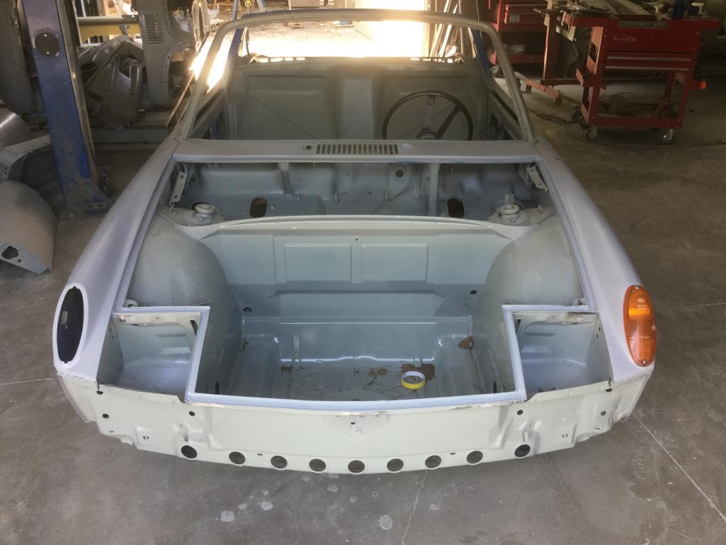

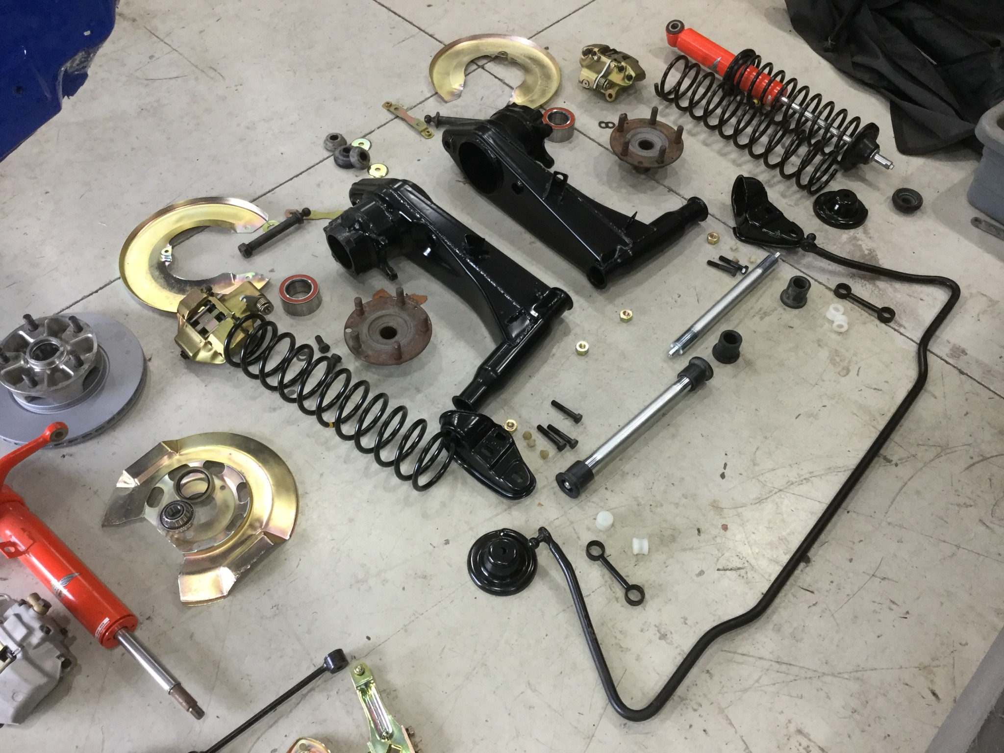

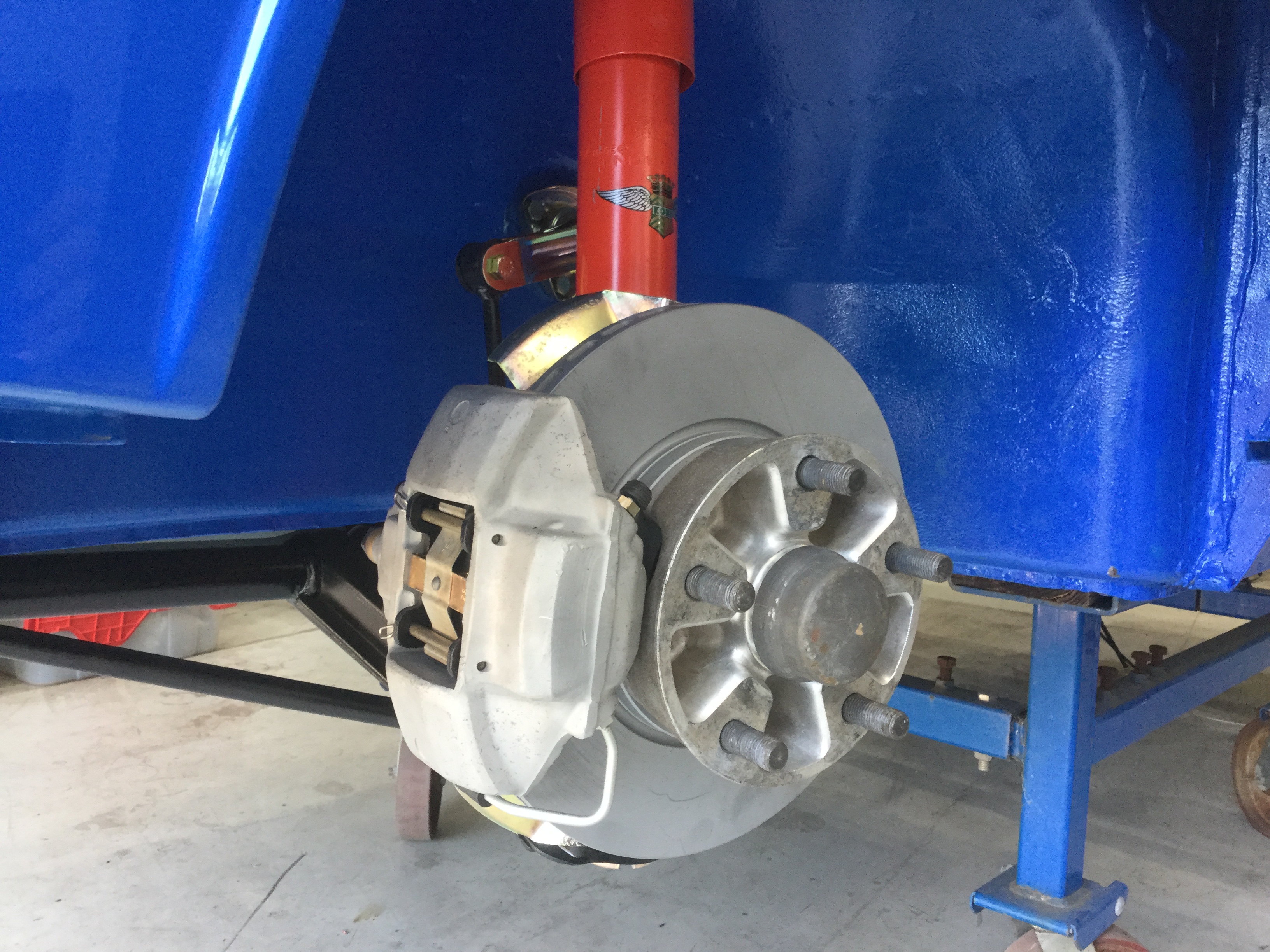

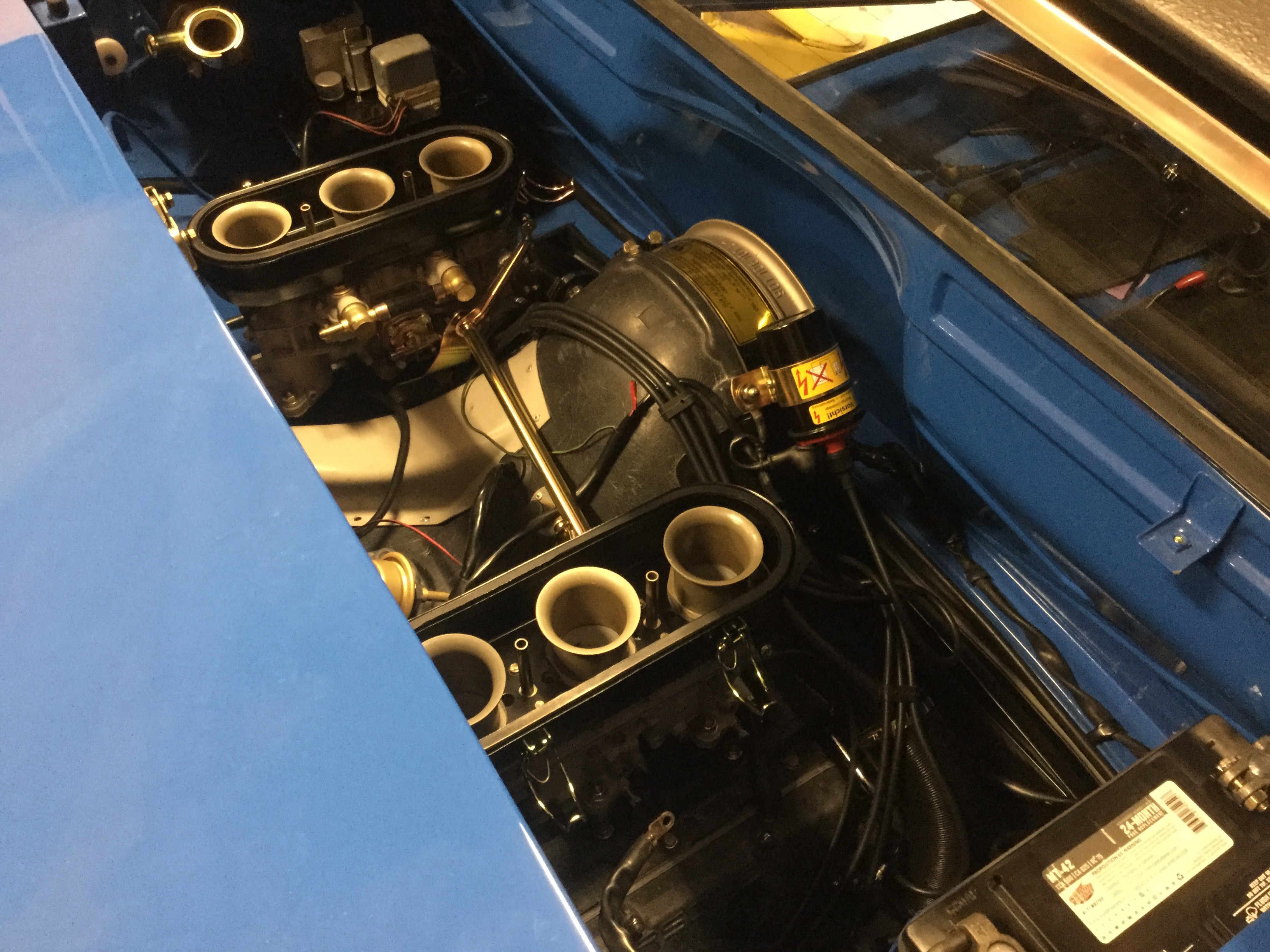

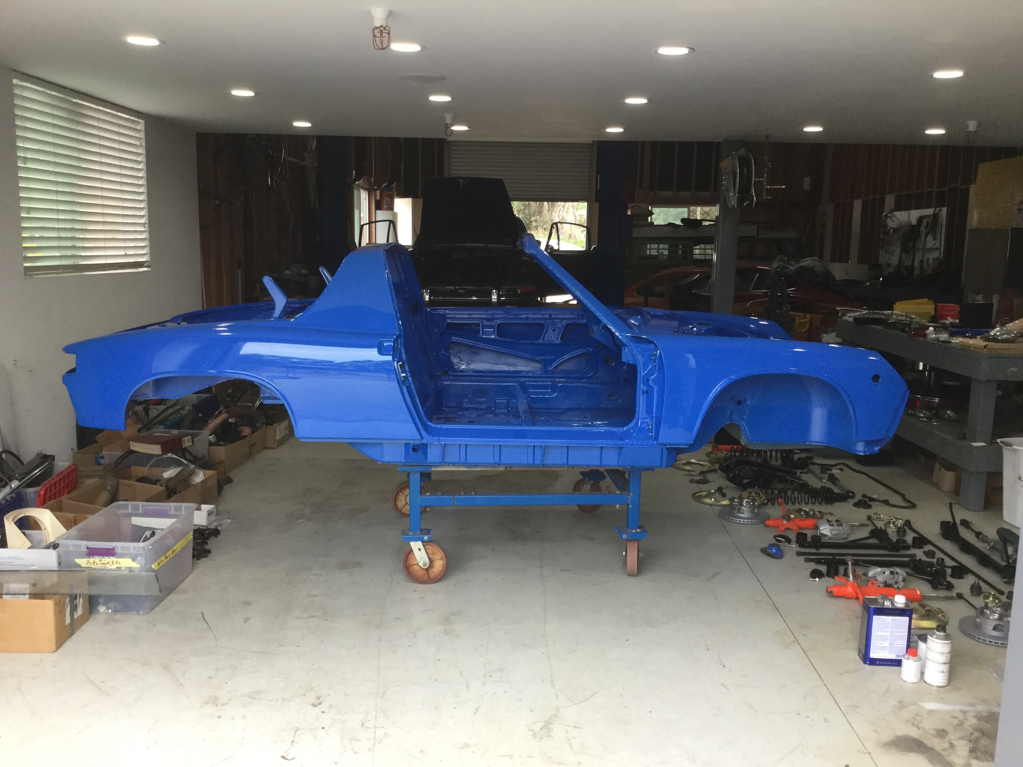

VintageExcellence   Moving along   Sep 16 2018, 12:53 PM

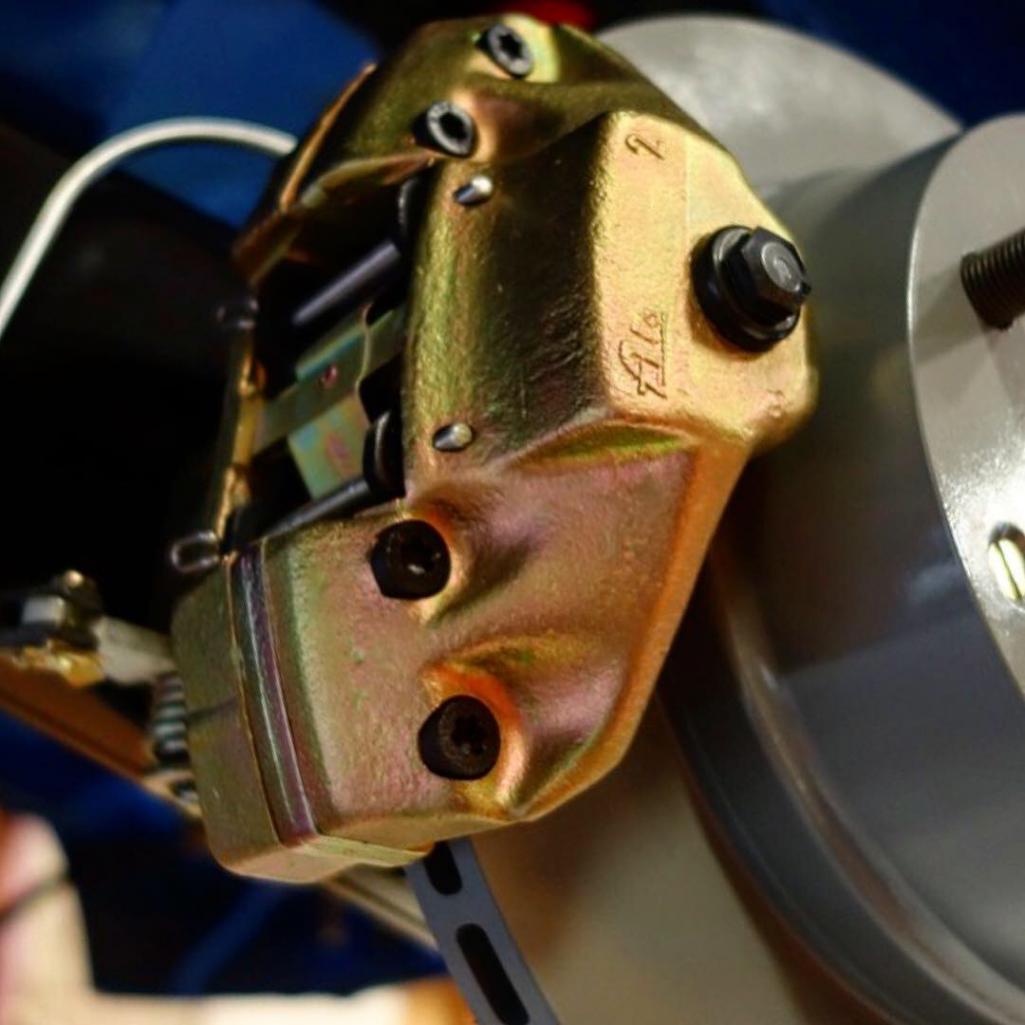

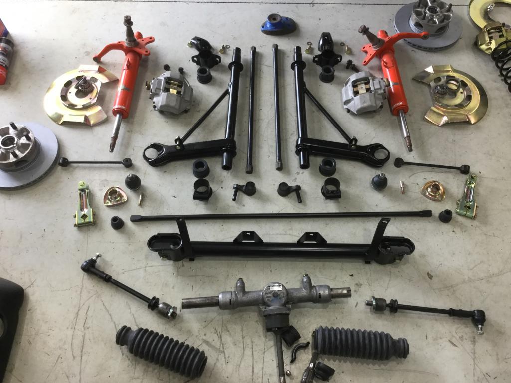

VintageExcellence   I made a number of changes to the suspension and b...   Sep 16 2018, 12:57 PM

mepstein   The crossmember thing is a little confusing. Logic...   Sep 17 2018, 07:47 PM
914Sixer   Thanks for covering the front cross member. I hav...   Sep 17 2018, 08:05 PM
VintageExcellence   Doesn’t really matter what crossmember as it all...   Sep 17 2018, 08:21 PM

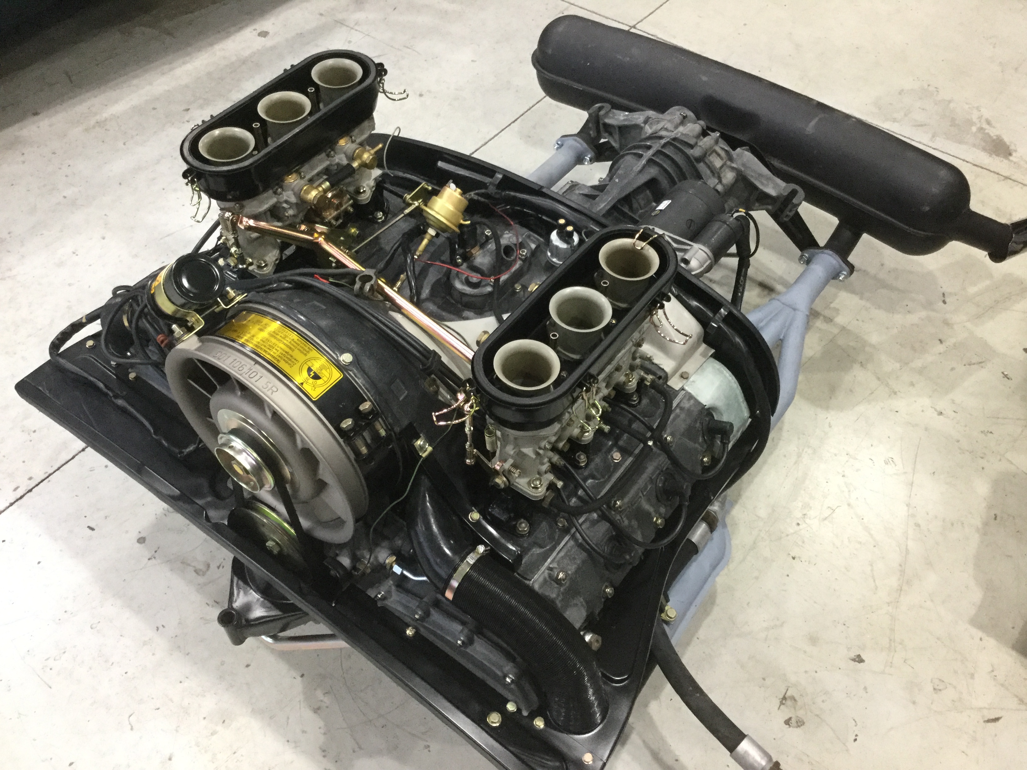

Larmo63   I notice you aren't using Carrera chain tensio...   Sep 17 2018, 11:21 PM
VintageExcellence   I notice you aren't using Carrera chain tensi...   Sep 18 2018, 07:40 AM

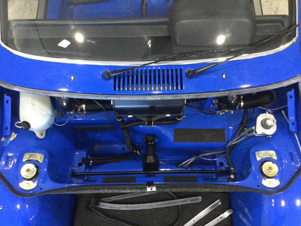

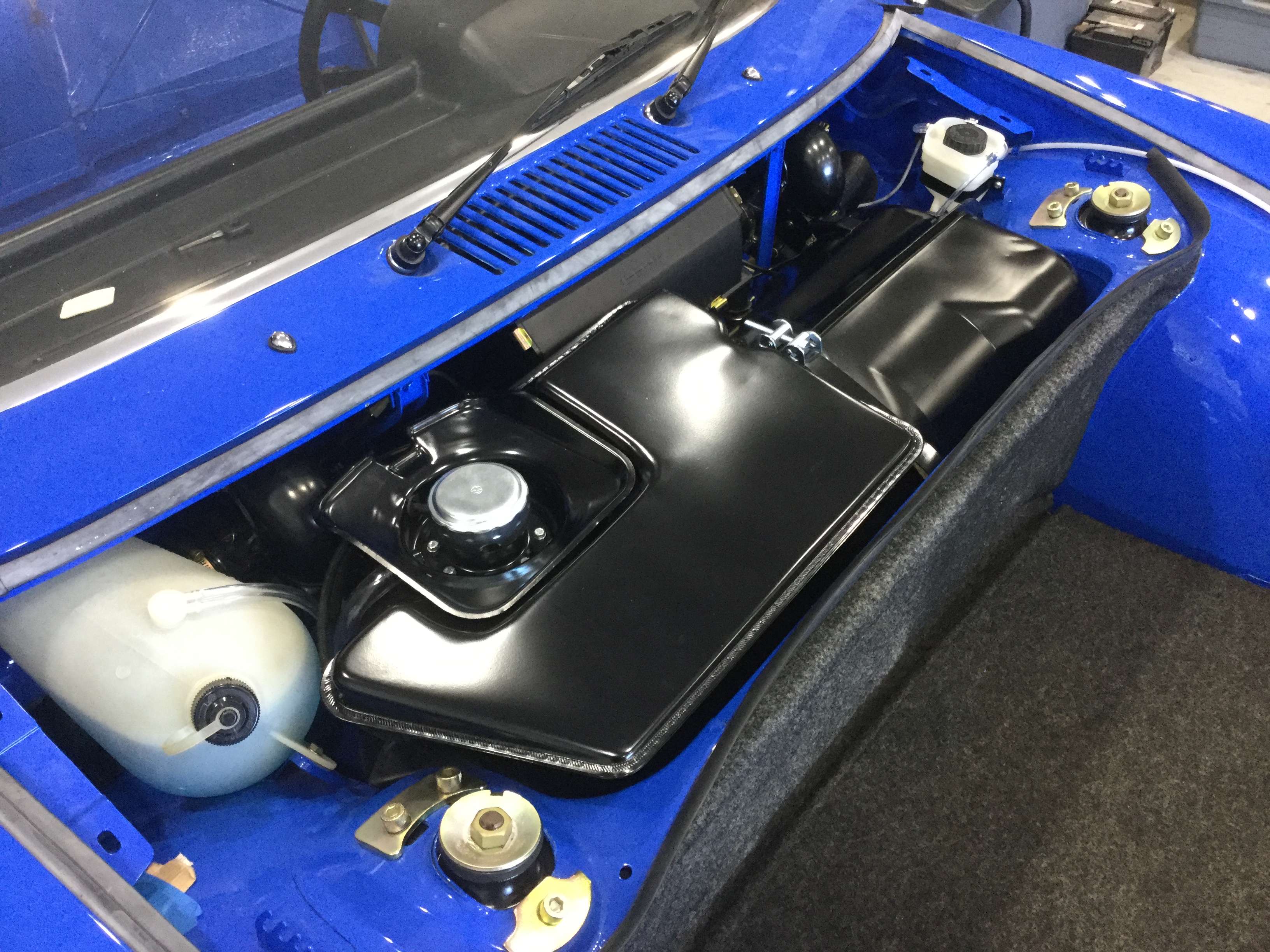

VintageExcellence   This trunk although much simpler than a 911 was st...   Sep 18 2018, 04:31 PM
rstover   This trunk although much simpler than a 911 was s...   Sep 18 2018, 06:59 PM
VintageExcellence   This trunk although much simpler than a 911 was ...   Sep 18 2018, 08:04 PM

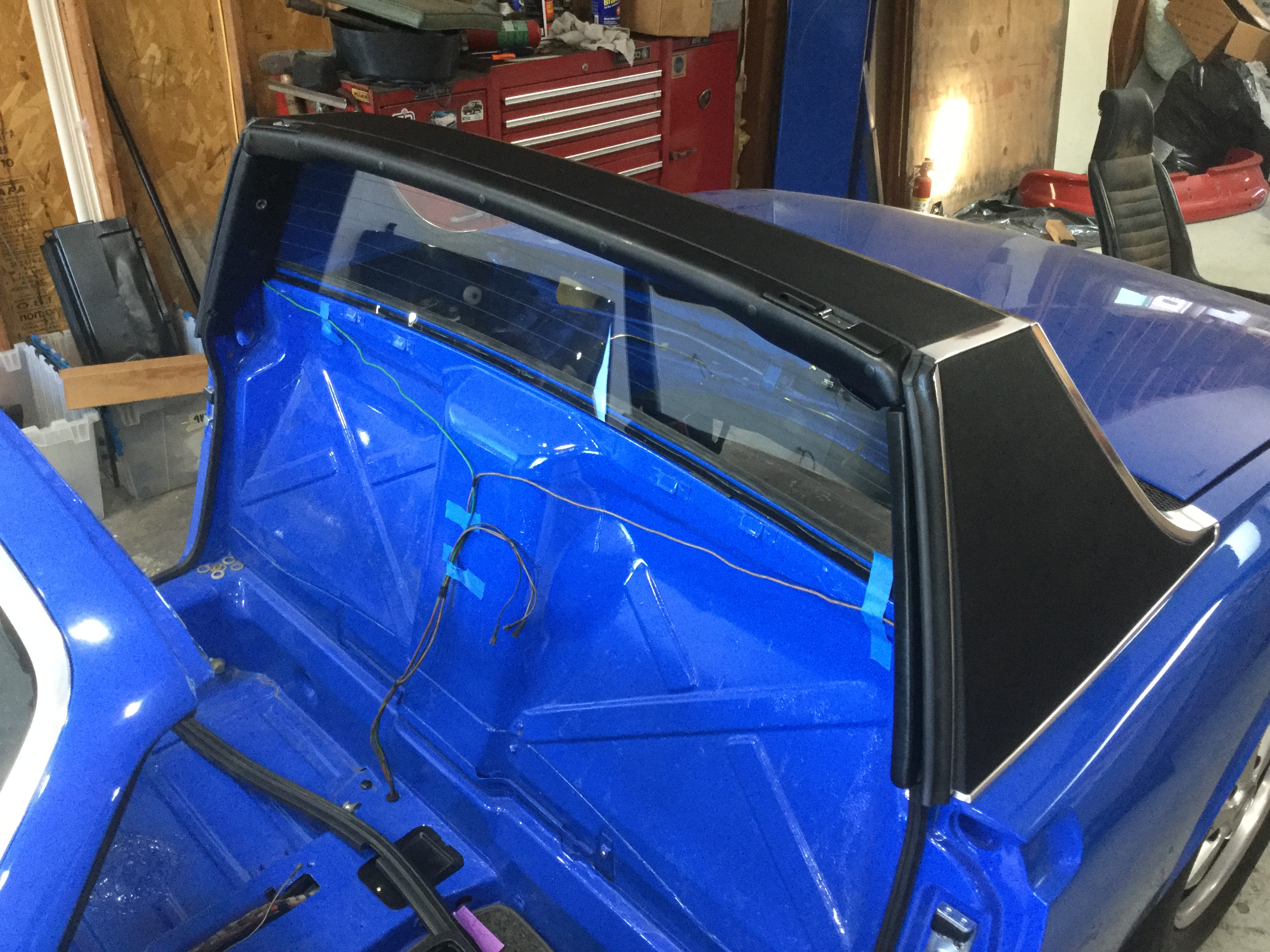

VintageExcellence   Glad I put away a nice roll bar pad a number of ye...   Sep 20 2018, 08:24 AM

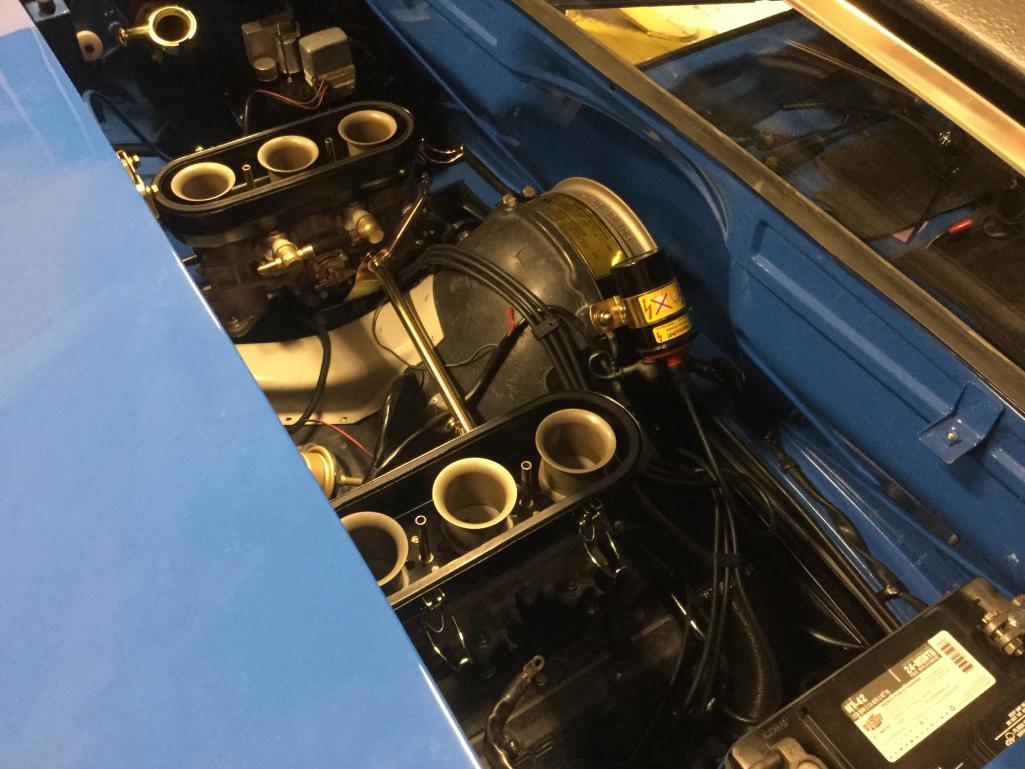

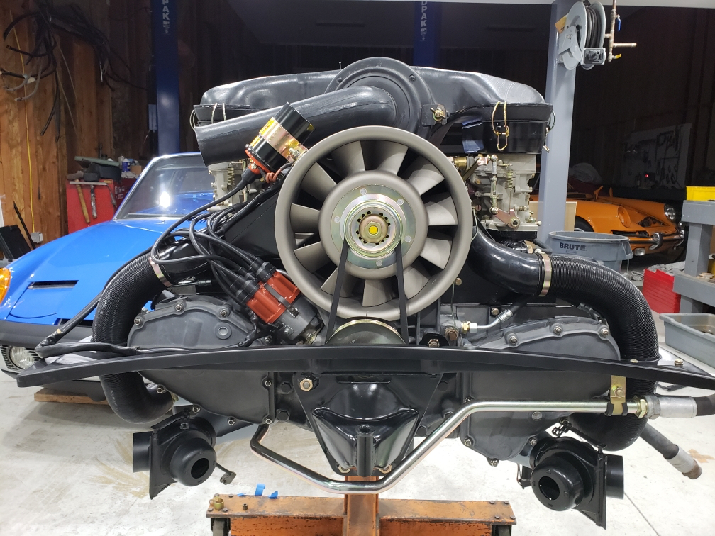

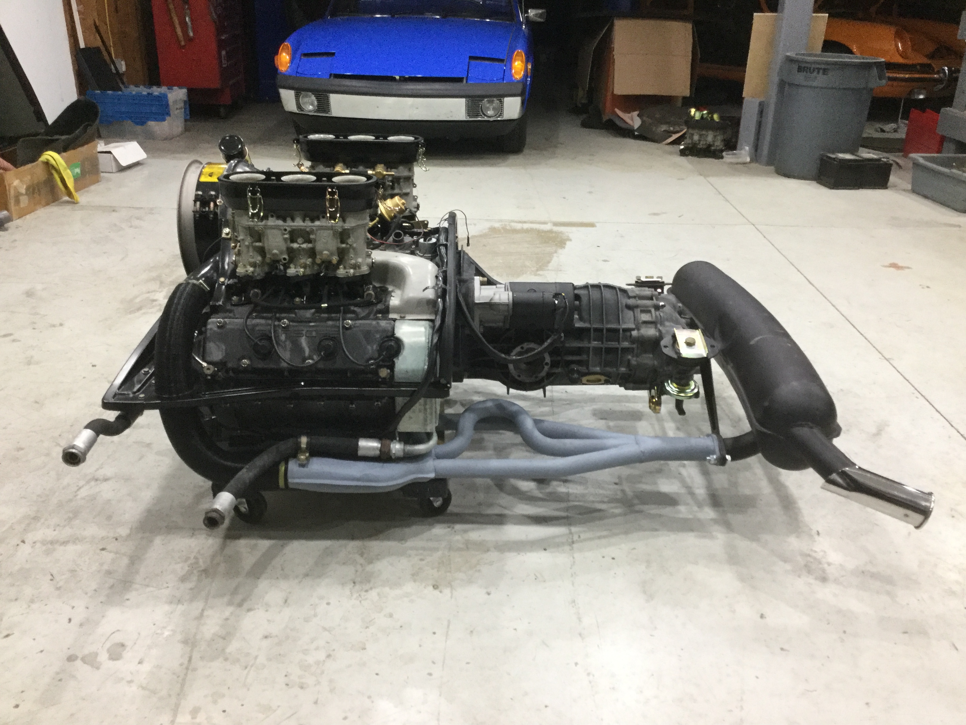

VintageExcellence   Starting to open its sleepy eyes. Engine is in for...   Sep 20 2018, 08:22 PM
VintageExcellence   Money shot Still having many issues, 911 rotors a...   Sep 20 2018, 08:34 PM
