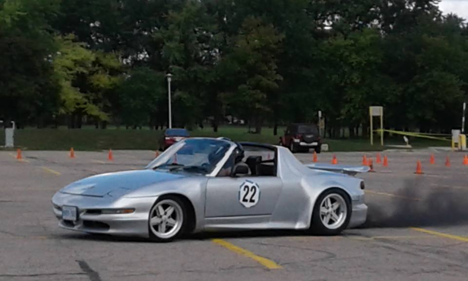

First time out at the autocross with the diesel. A little overfueled.... need to put the smaller turbo back on, too much lag.Attached Image
37C ambient temperature on the way home... (99F). Couldn't run past about 60 mph without the overflow on the rad starting to burp. Was running straight water to make sure I had no leaks. Going to switch to proper coolant but I'm assuming I need to at least go to a better fan. Anyone know something that is a direct swap on the 90's Honda civic rad that works better? I'm going to try a better fan before I try to put a bigger rad in. I like the way everything fits now.

QUOTE(PatrickB @ Sep 15 2018, 06:06 PM) *
Holy shit. I am experiencing simultaneous awe and hilarity. Very cool!

QUOTE(Dr Evil @ Sep 18 2018, 03:42 PM) *
Thanks! I'm happy with the progress so far. More work to do yet though. Dropped the throttle cable off tonight at a custom place not far away... hoping they can make me a new one about a foot longer with a different end at the engine end of the cable. Picked up an adaptor to hook the diesel's alternator up to run the factory tach, should help with autocrossing. I know the engine pretty well from putting a lot of miles on it in another car, but it sounds different in this car and with a different turbo. Guessing too much at rpms.
