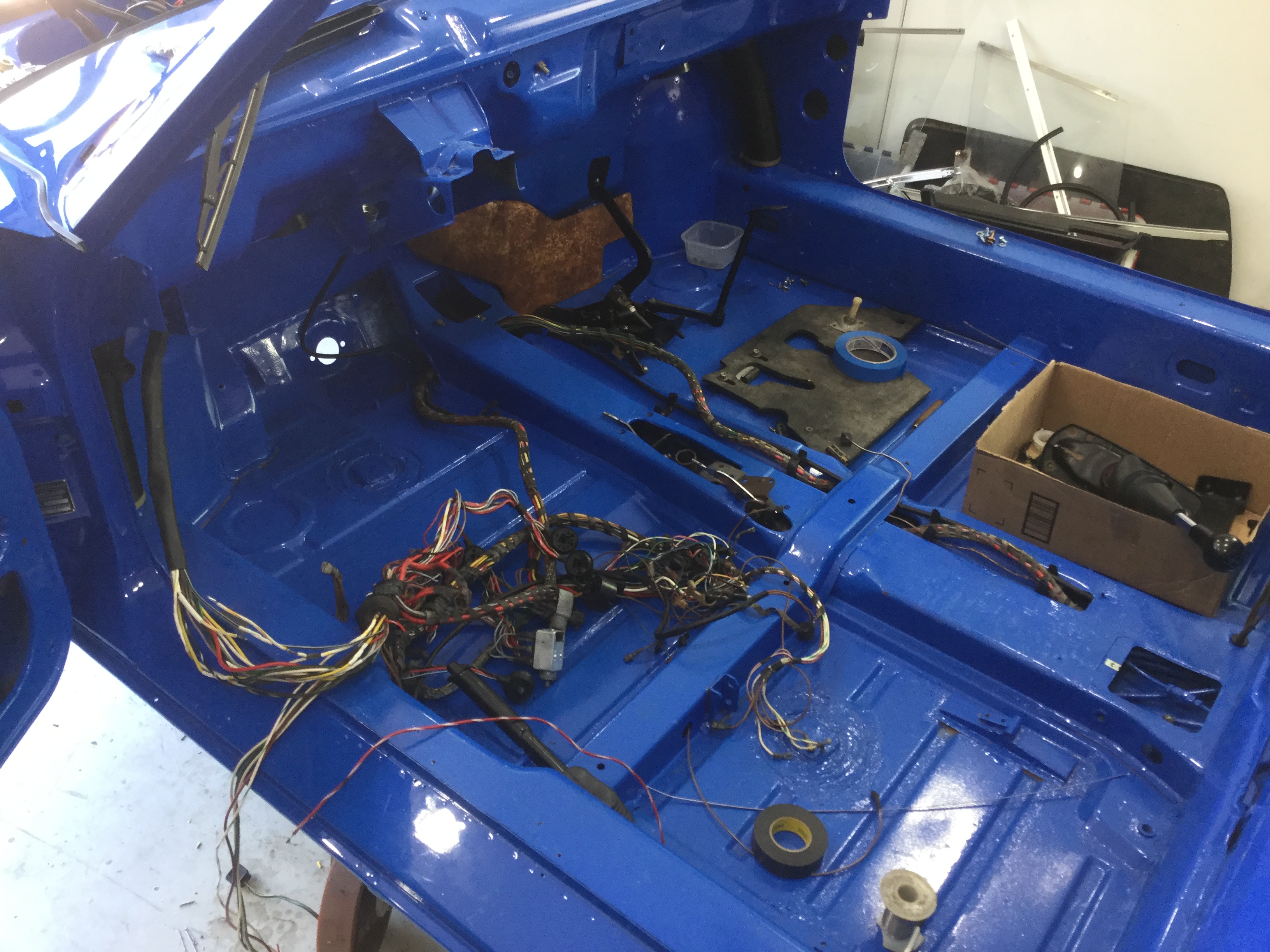

Then I went down a rabbit hole and thought I would triple my efforts into used Porsche sales and opened a restoration shop using a name I had created in 2000.... Vintage Excellence
I had purchased a project 911S and this 914-6 as projects that I could tuck away and restore once production was up and running in the restoration shop. My dream of owning a perfect 914-6 and early 911S was on its way. I started the grab for NOS parts for my cars. These cars had to be perfect, I would use my knowledge from trolling VW & Porsche swap meets starting in 1994, expertise from a Porsche parts sales business started in 1997 thousands of parts sold and dozens of parted out 914/912/911s later, I worked for a shop called Oest Enterprises in Torrance for Dieter R. Oest restoring old Porsches and dealing with Dieters massive used parts inventory - Dieter was a former Vasek Polack 935 crew chief and a long time racer. I had worked for a kooky character named Bill Higgins who advertised out of the paper Auto Trader for many years selling classic Porsche parts - there I parted out cars and watched Bill flip a bunch of wrecks, I could not stand the junk car sales so I went out on my own at that point. I put myself through college via the Porsche parts and car sales business and learned plenty by the time I got my degree. I bought a suit and was interviewing for all these silly corporate jobs and I didn't like it so I took a few months off. Then through a friend I got the job at the dealership Cardiff Classics as the General Manager which brings us back to the beginning of the story.

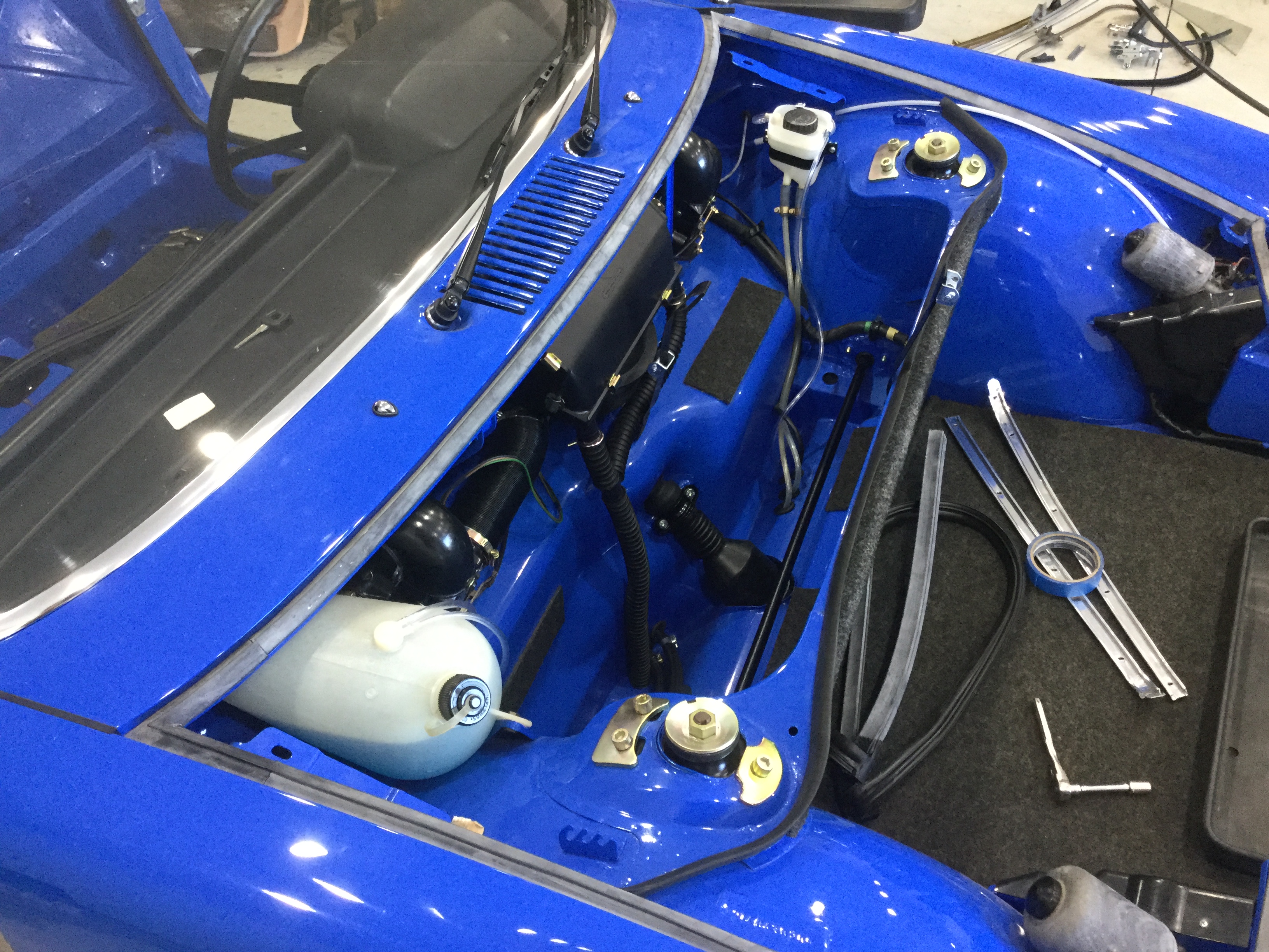

This trunk although much simpler than a 911 was still difficult to get right. The flaps in the defrost flappers were broken, took a while to find some replacement parts but it’s all original and working now. The fuel tank goes in next.

QUOTE(VintageExcellence @ Sep 18 2018, 05:31 PM) *
Beautiful. Just exceptional.. Would you mind sharing what you used for pads for the gas tank?
VintageExcellence
post Sep 18 2018, 08:04 PM
Posts: 52
Joined: 27-August 04
From: San Diego, CA
Member No.: 2,636
QUOTE(rstover @ Sep 18 2018, 05:59 PM) *
Thanks for the kind words. I was wondering what the heck was used to pad the tank. I think I spotted it on another 914 - perlon carpet. I took an old 911 trunk carpet and cut some squares. Looks great, fits great, seems like something Porsche would do.
I always overdo my trunks, it’s a major utility area for the car so taking your time here will make the car work so much better. Unfortunately most of it gets covered up.
Engine/trans will be done tomorrow and probably go into the car, let’s hope there are no holdups.
