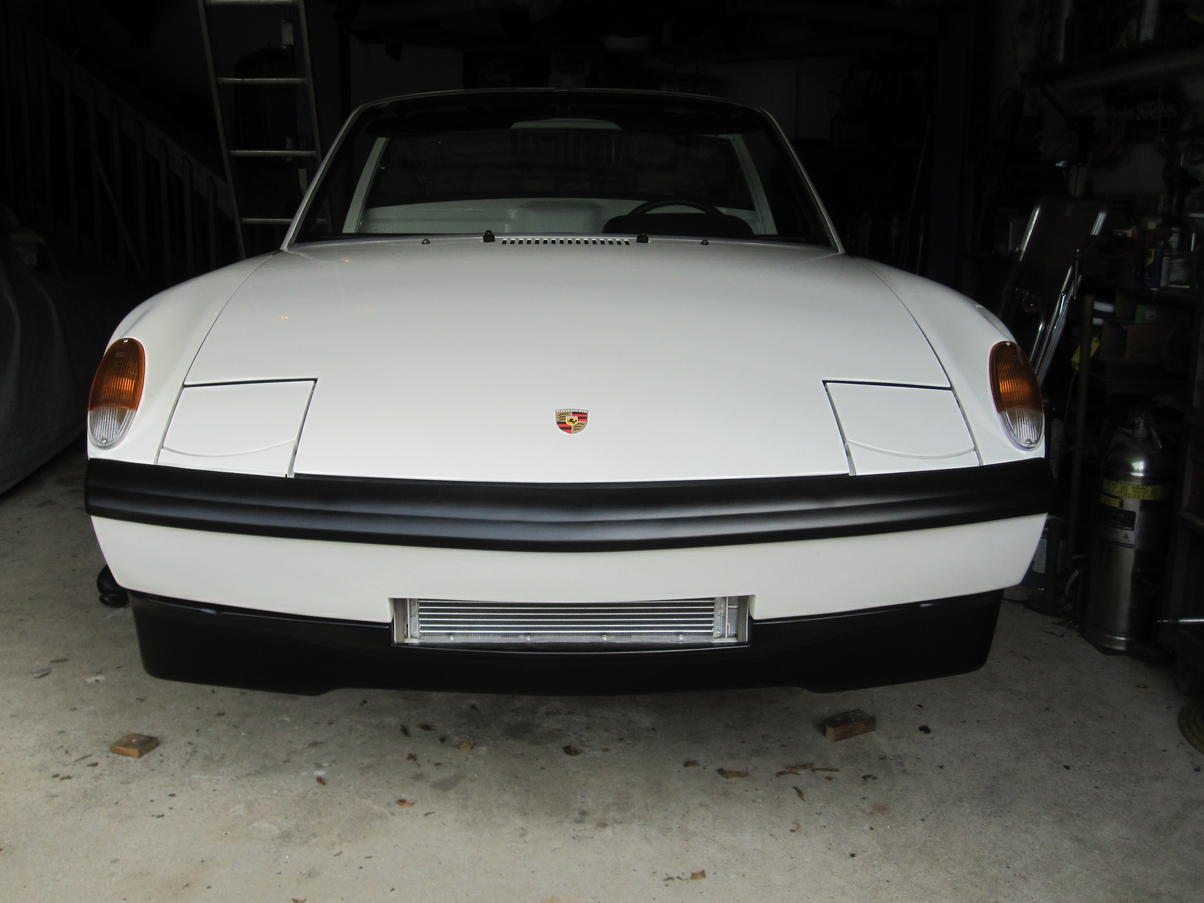

rgalla9146   Installed the gas tank and most of the front trunk...   Sep 20 2018, 04:24 PM
Lucky9146   Installed the gas tank and most of the front trun...   Sep 20 2018, 04:34 PM
wes   Installed the gas tank and most of the front tru...   Sep 20 2018, 07:24 PM
rgalla9146   Installed the gas tank and most of the front tru...   Sep 20 2018, 08:02 PM
