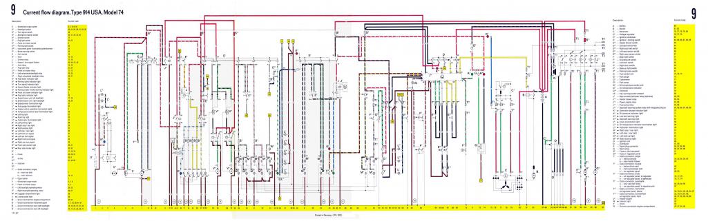

Here is a picture from Prospero's Garage of the Fresh Air Fan Relay. The problem is, it does not say where the wire goes off to. Looked at the Fan switch wiring but all wires there are accounted for. Checked original manual and it says wire #14 but that does not make sense, or does it? Where does that wire go, what pulls in that relay?Attached Image

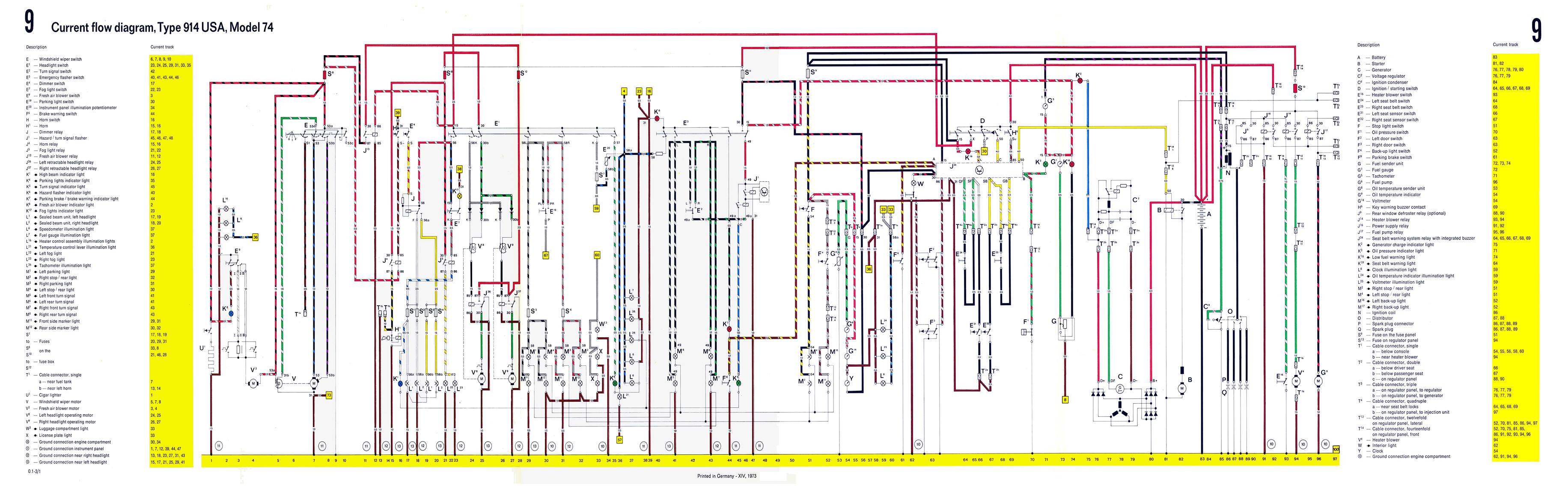

On the 74 diagram it shows it going direct to a switch. But the 74 does not call it a "fresh air relay". 74 calls it a heater blower relay. The fresh air controls in the dash is a 3 stage switch controlling fan speed.
Relay shown as J14
